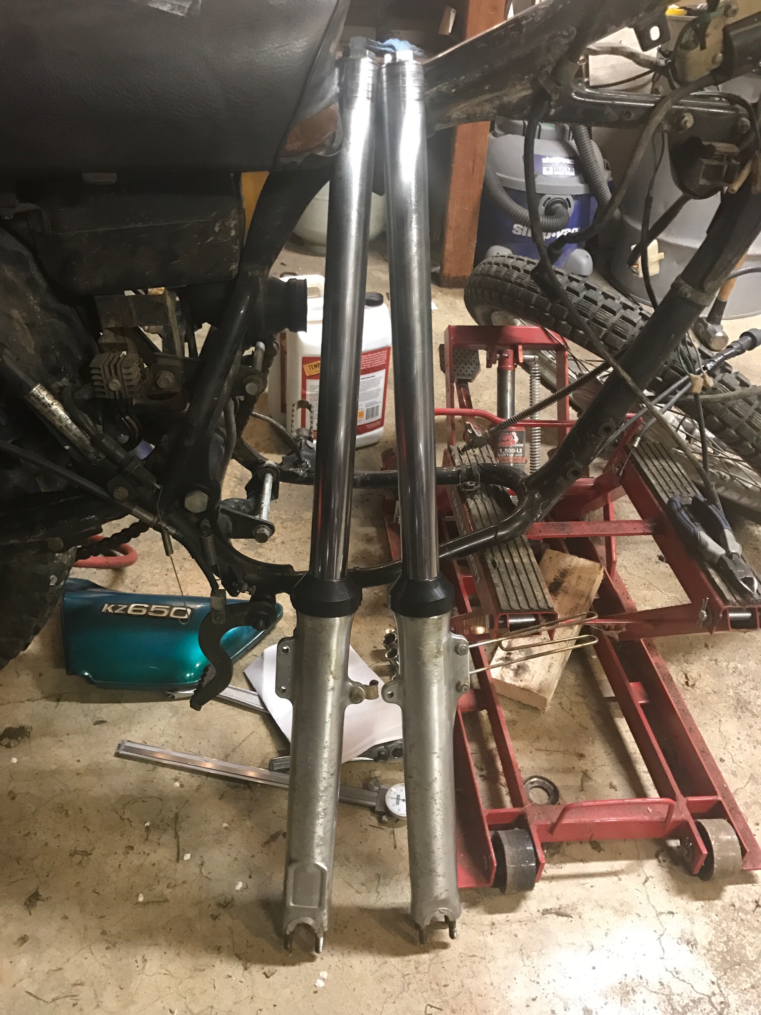

Forks rebuilt, set the tubes in some metal rescue for 24 hours and cleaned them up. Still some pitting but nothing going through the seals. Fresh seals, fresh dust covers, fresh oil. Shitty thing that brought the party to a vault was I forgot to put a spacer below the new steering bearings on the lower triple. Tried to install it on the neck but it bottomed out. The bearing didn't survive being driven off so now I gotta get another. One more week down the drain

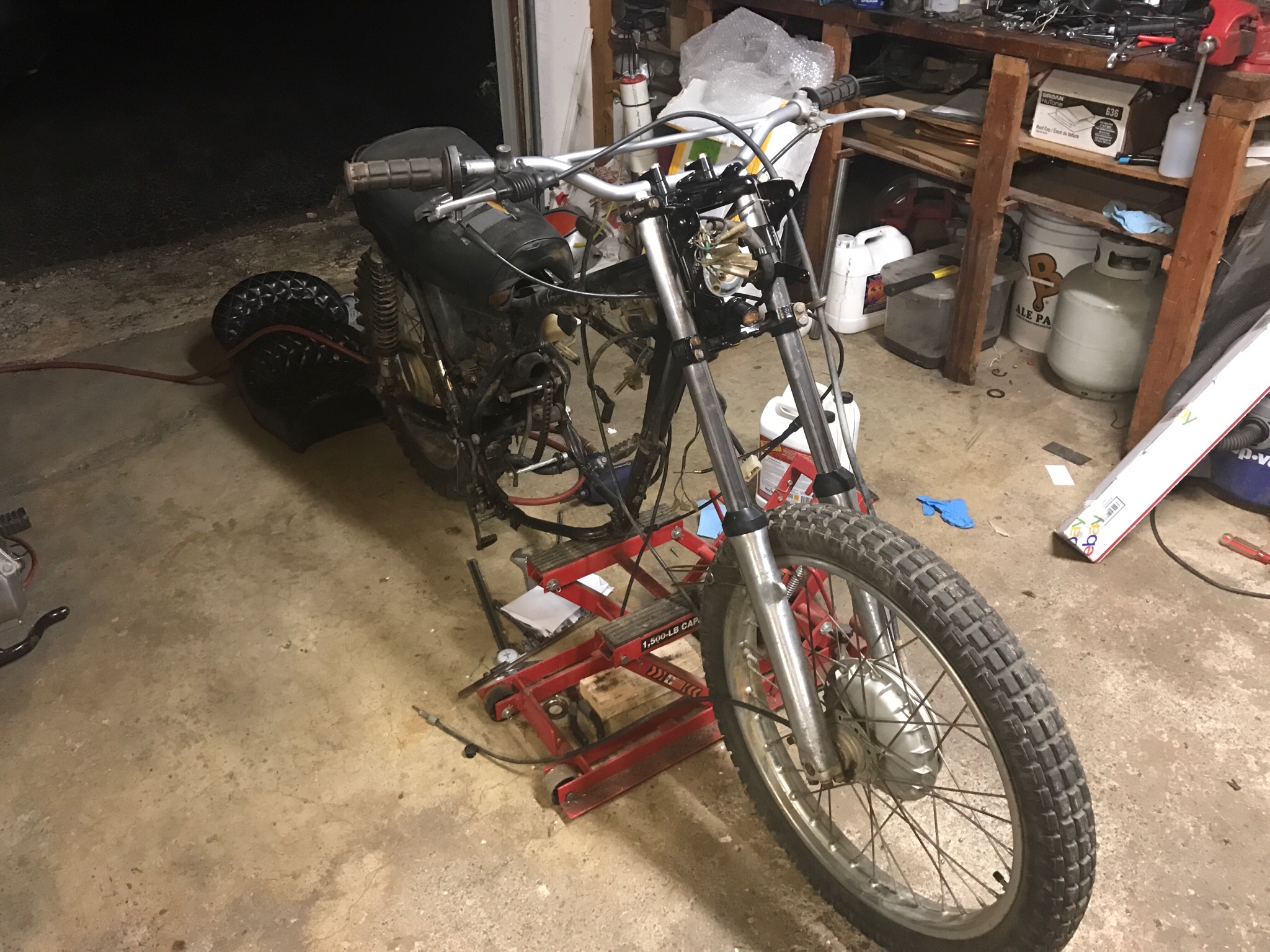

Finally got feeling better, started getting the front end back together tonight. Still a lot to do but it's starting to look more like a bike again!

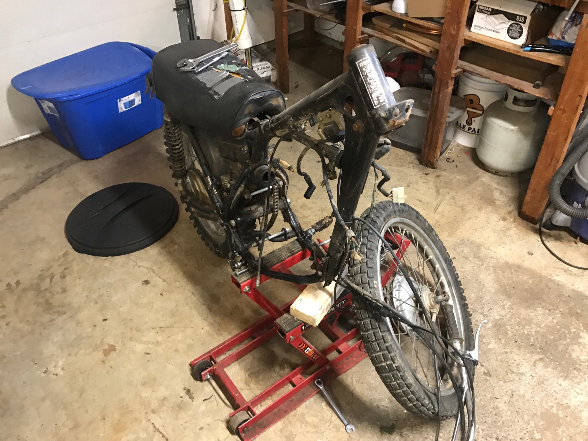

Starting to look more like an old bike again,
