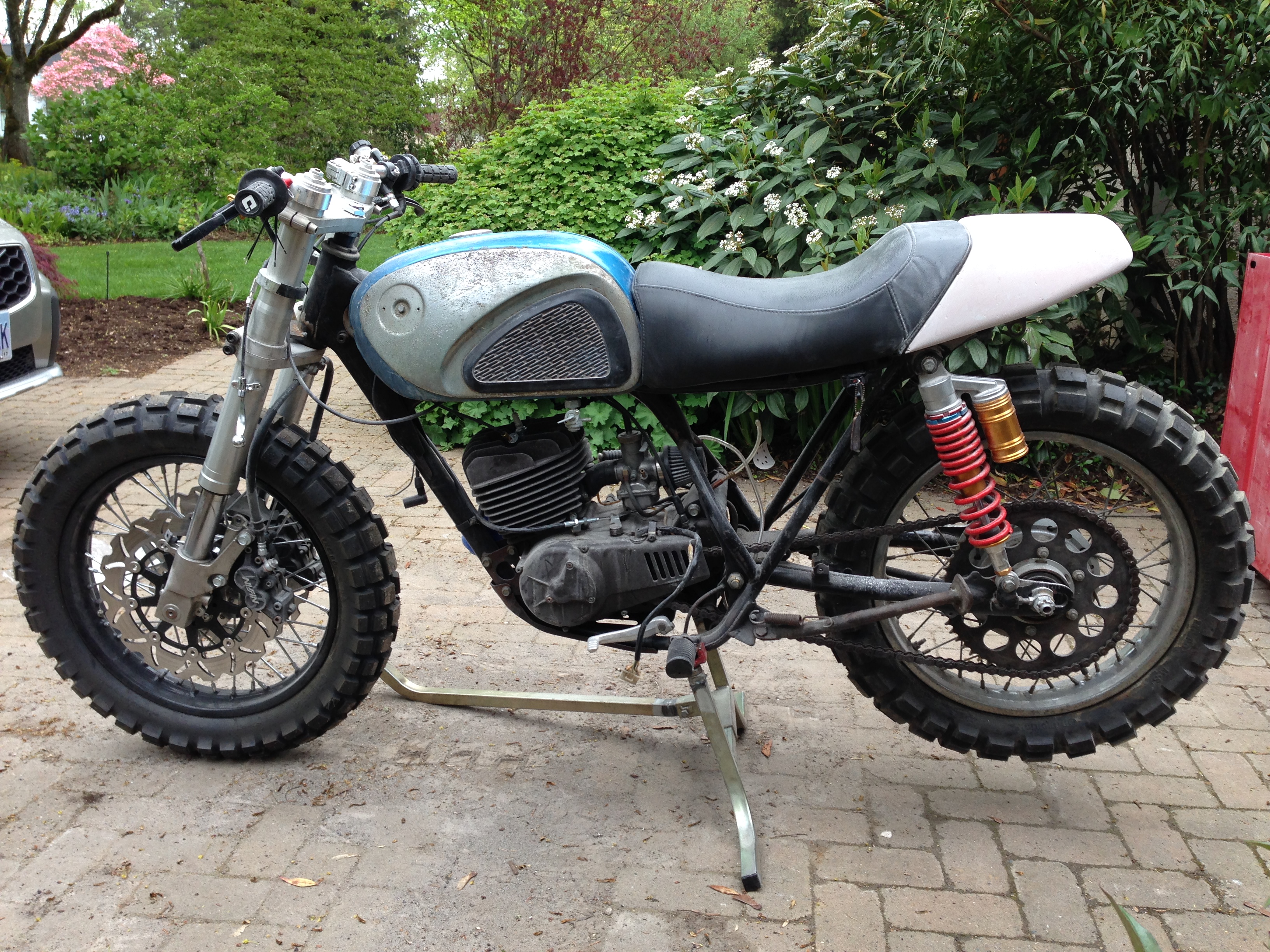

The chopped-off ducati seat was too small to use as a mold for a cowl. I eye-balled all the stuff that needed to go under the cowl (battery, fuse box, blinker relay, etc) and started building the foam up. Initially I thought I could get away with two-part epoxy putty and some wire mesh.
