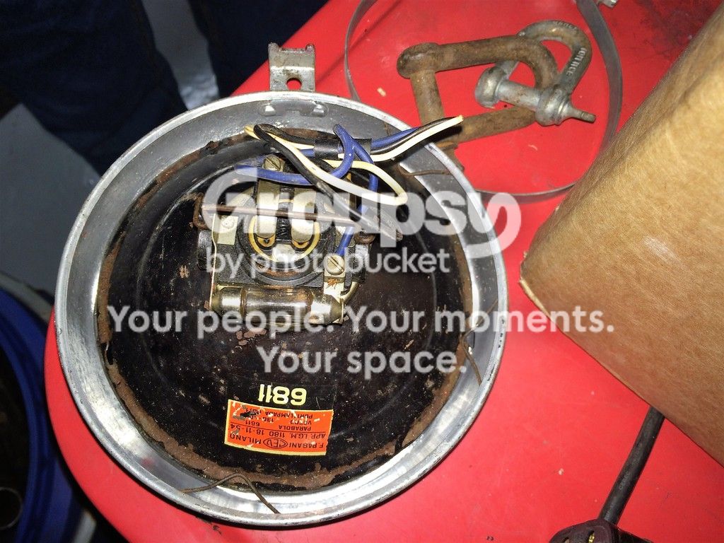

Anyone with any idea on how the electrical system works - I have a manual in Italian and a sort of wiring diagram- but it looks very suspicious and the components are corroded, hardened and there are a few oddities within the head lamp unit and a diode set of sorts at the horn

I am still unsure of how the electrical system works- if anyone know the principals of operation please help - it would be appreciated.
I will post a photo of the internals on the head lamp shell- it's got a few odd looking components.
Also if the diode bridge in the photo above is of the zenor type- then maybe it's used as a basic voltage regulator
There's also a slave bulb fitted across the head light lamp holder- this is inside the head lamp shell.
I was wondering if it was for excitation of the generator - like an old school ignition light
The bulb across the lamp holder is the pilot light.
See a colored wiring diagram here:
http://www.motoclubstoricoconti.it/Utilit%C3%A0/File/Schemi/SchemaElettricoMVAgusta125TRL.pdf
It is from a 125TRL but the same as on your 150 RS.
No signs of a zener diode etc.
The black thing with the (blown) fuse is the ignition switch.
The other thingie is the rectifier. Also no sign of a voltage regulator.
Get the right cable colours an make the wiring harness yourself!

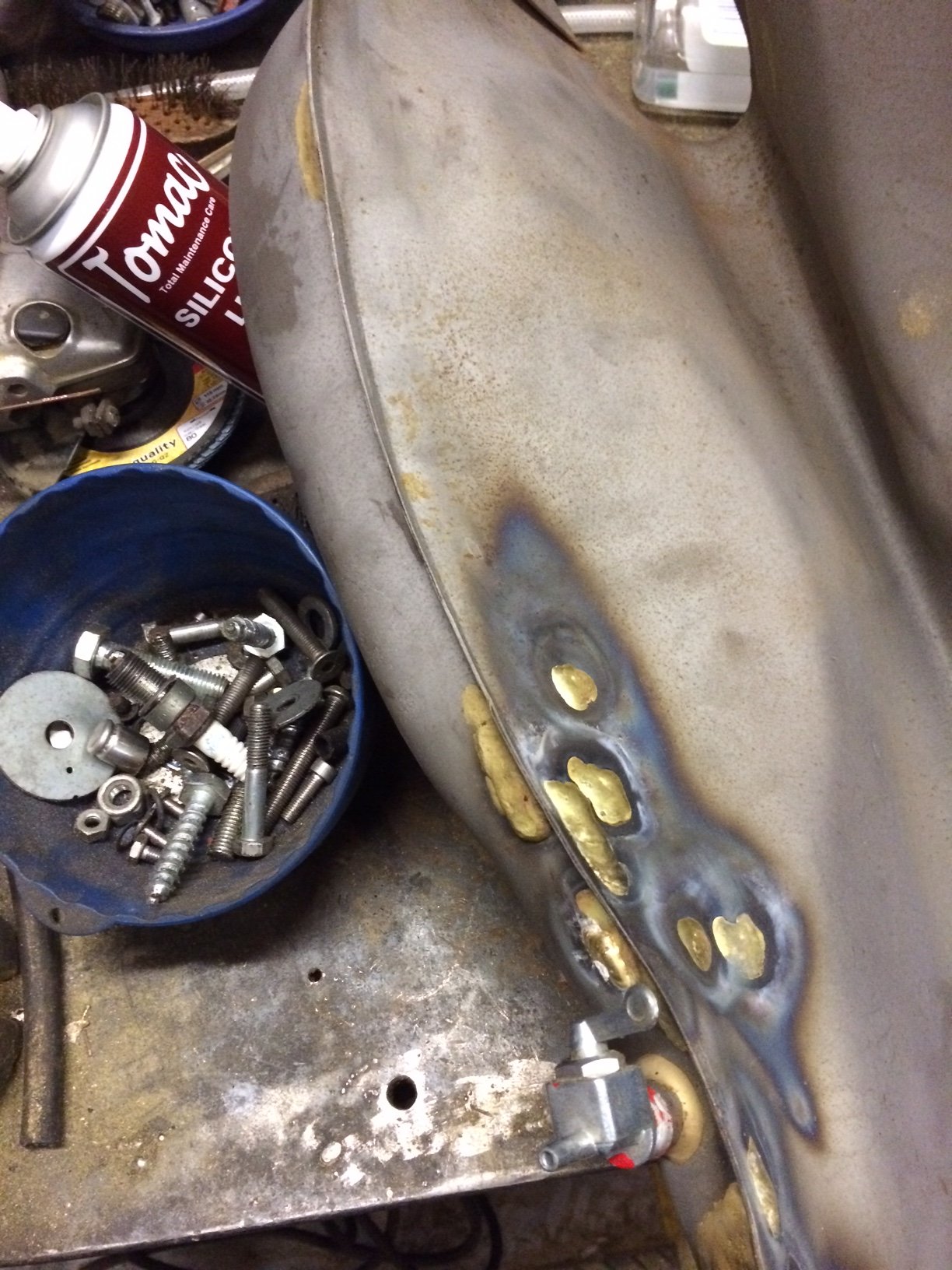

I all sorts of problems wit the fuel tank- I brazed up all of the holes found. ( I put an air pressure into the tank and used soapy water).
I got all areas sealed except for the lower end at the petcock.
I am beaten with this area- it was previously brazed, soldered and welded.
I have tried braze, tig and patching- but no use- I have cut away the bad bit now and am looking for ideas??
Anyone got a repair idea?
I think that there may be too much mixed repairs going on and the metal may be contaminated with solder flux, braze flux, rust etc

Better look for another tank.
Do not forget to scrape of the powdercoating where electric things are fixed or the engine.
or else you will have some electrical ground problems.
A very kind owner from Germany has sent me a tank which should arrive today- will use it and re-paint to suit.
Yes - I have been carefully sanding off any joints where the electrics are grounded- the electrical system is a bit strange on these machines and any poor connection is going to cause grief
