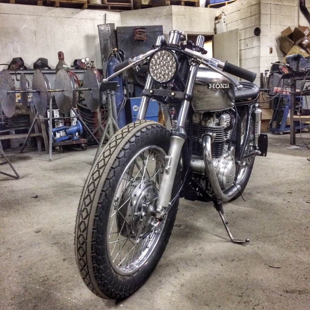

So I haven't posted in a little bit, but I finally got on it again and am slowly going into the final stretch.

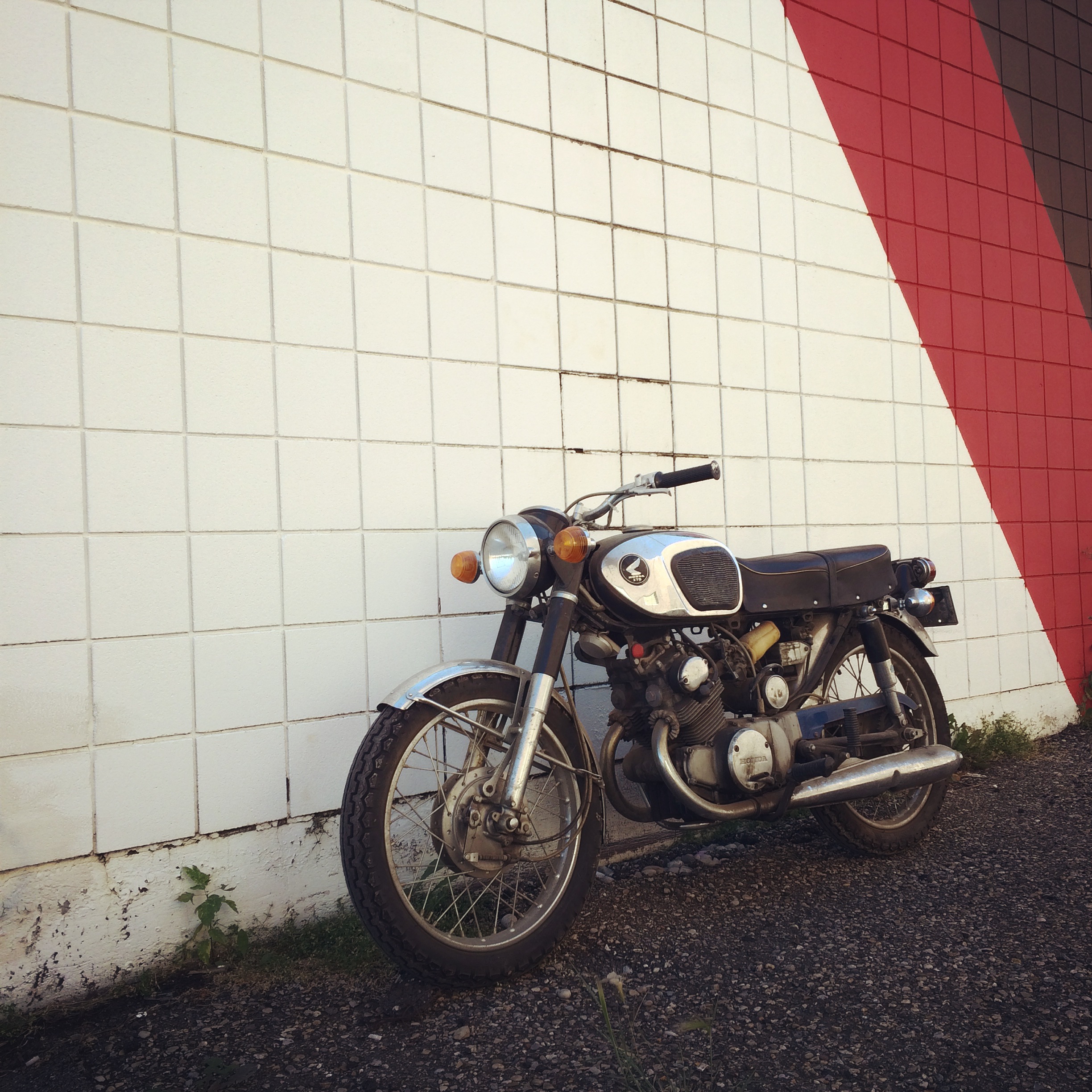

Also picked up a couple extra rides along the way....
1968 CB175 "Sloper"
I think I'll be bringing this one back to a nice shine. It even started on the second kick!!

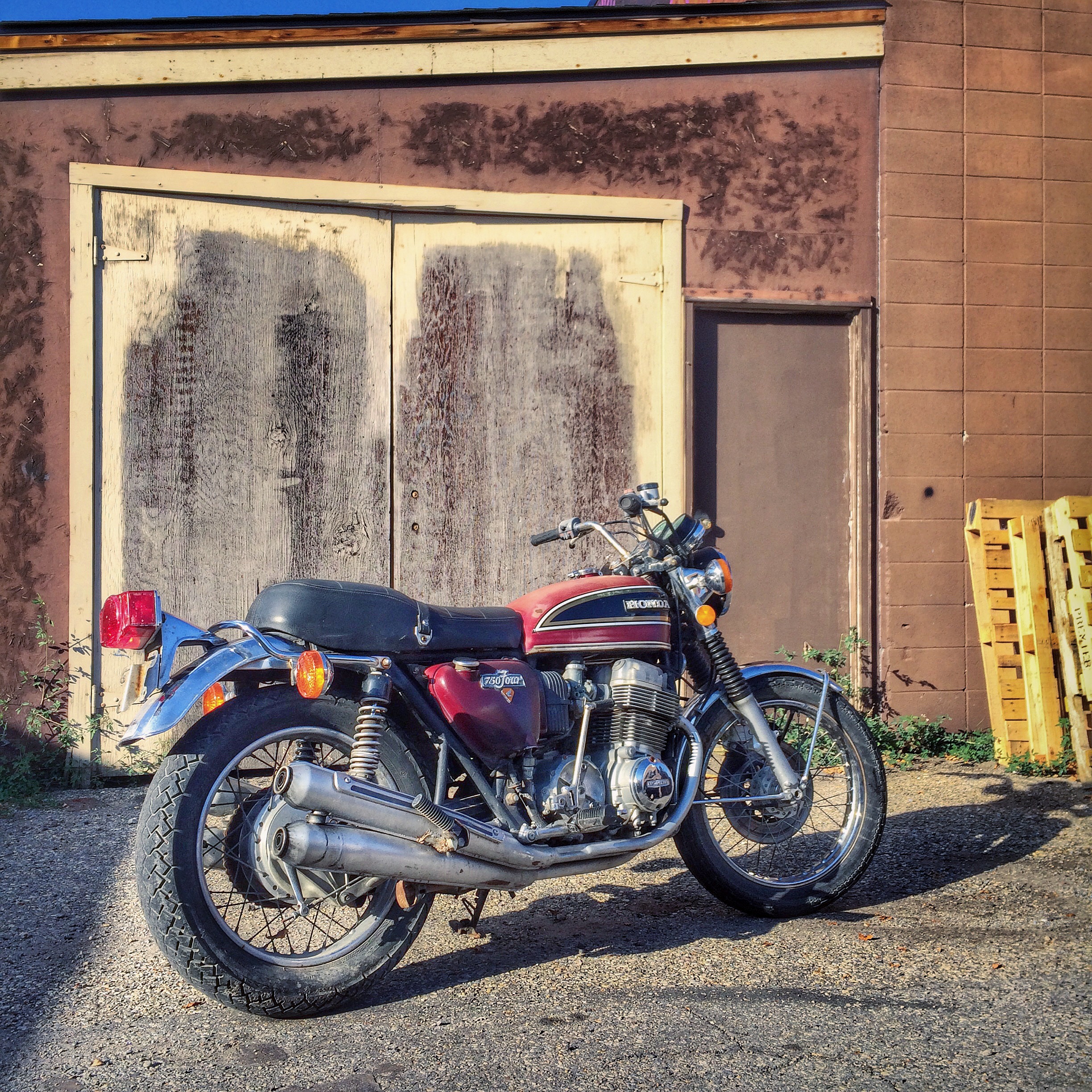

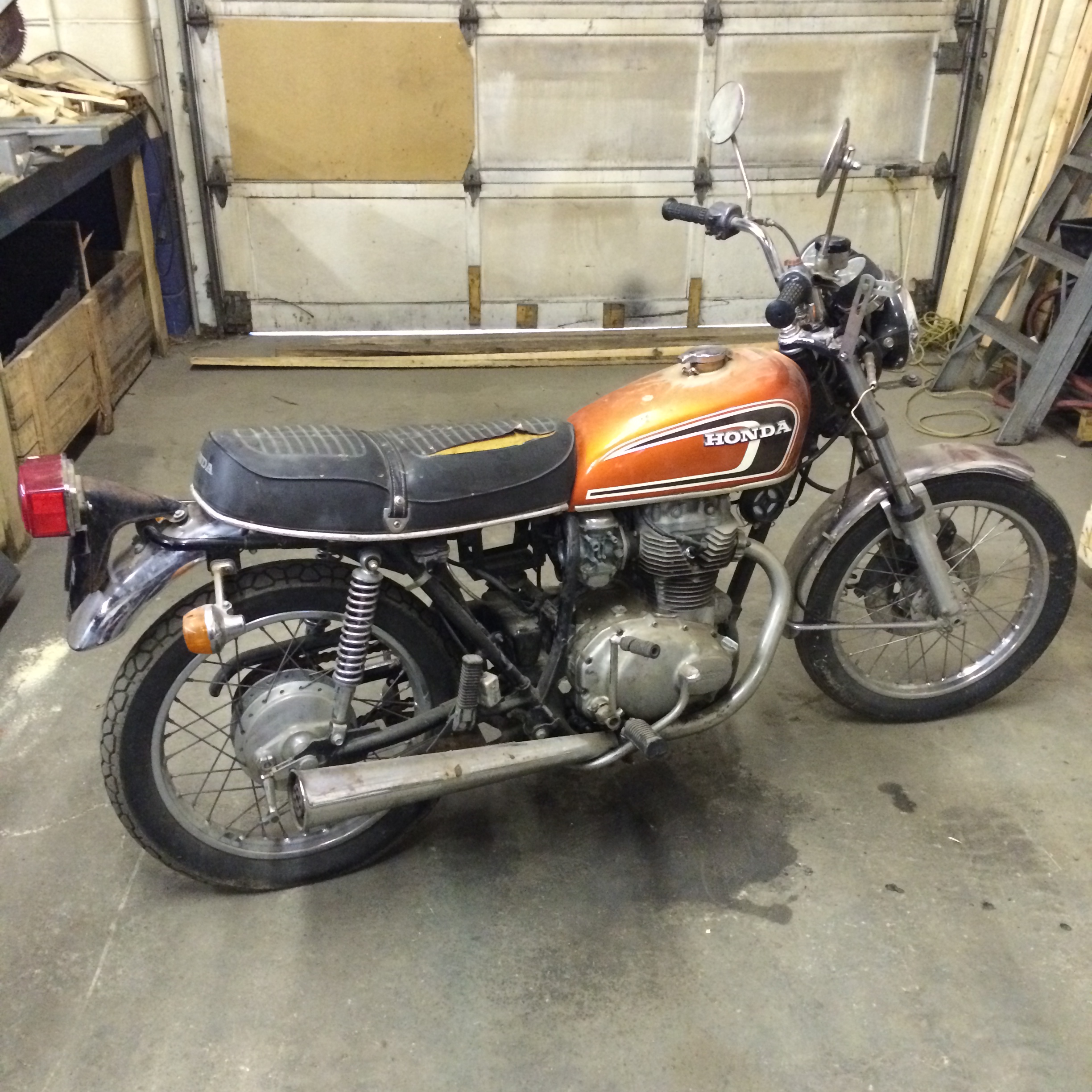

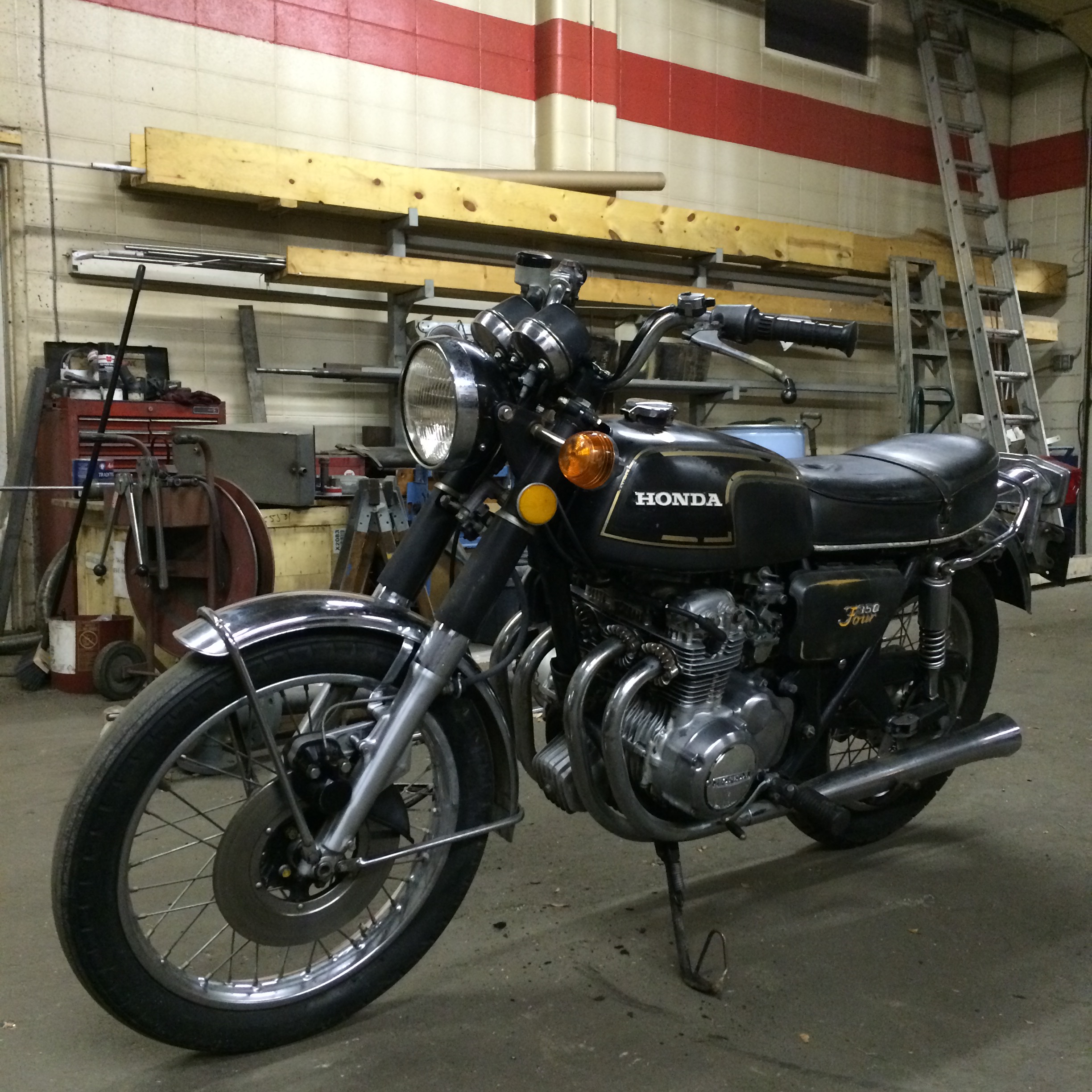

And a few more... These are joint projects between myself and a buddy.... we'll see what we conjure up.
1976 CB750 - This one I might just ride it all ratty as is.... It started right up and just needs some safety stuff done.
1974 CB350 Four
1975 CB360

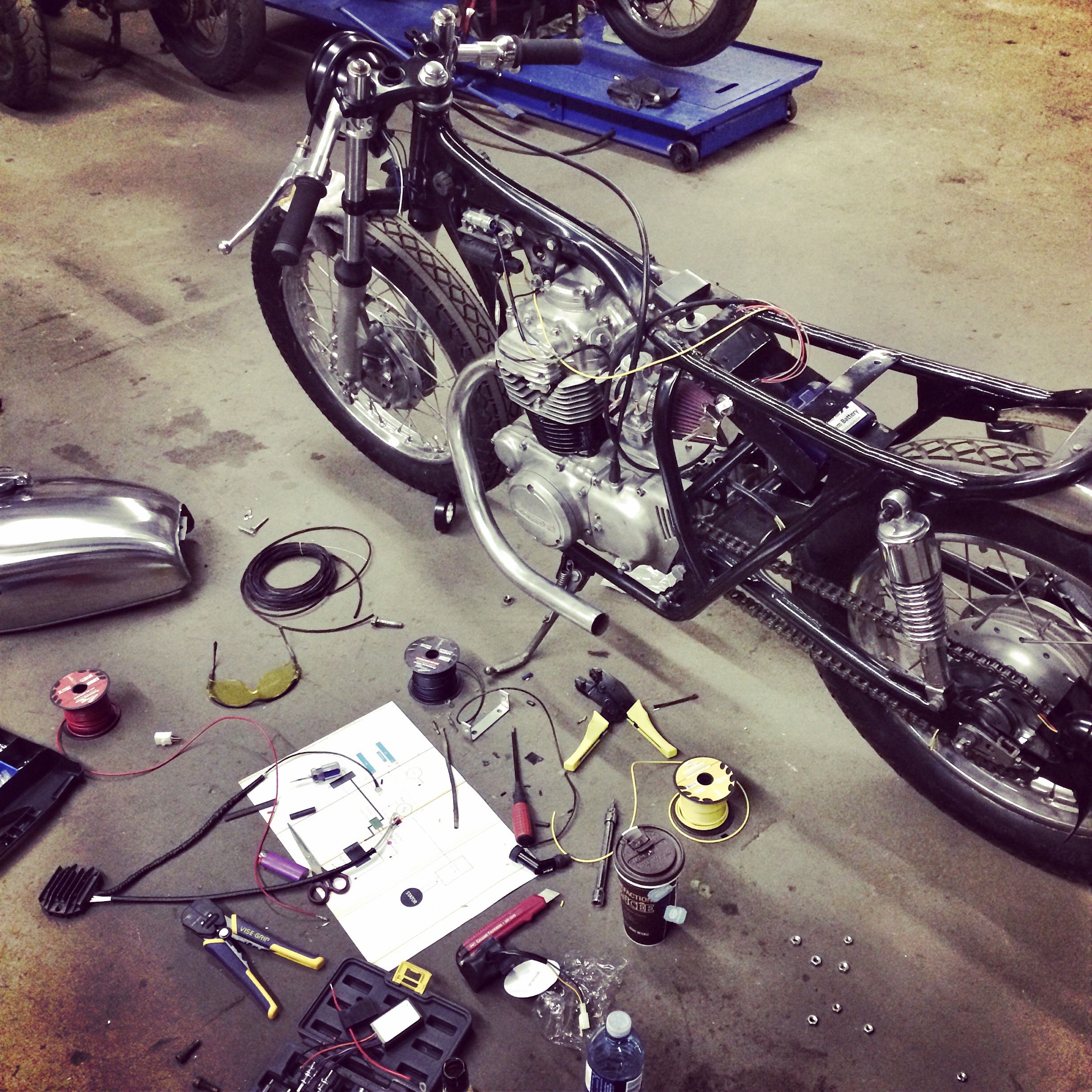

Back to the build!
More Wiring! I know people aren't the biggest fans of these little batteries on these smaller bikes, but I picked the EarthX because it has a built in balance charger, it doesn't require a special charger as well as it has overcharge protection and over discharge protection.... So technically I shouldn't be able to fry this battery.
Honestly, if it was for Sonreir's wise wisdom this bike would have never got wired!
