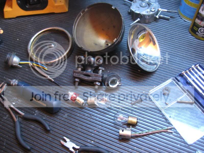

15 min and I modified to take an 1157 LED bulb and turned it into a stop/tail light!!..
Its wicked.. I"ll probabbly use it on my Triumph Bobber, rather than the other one I made from the Carbide lamp!!..
Took it apart:

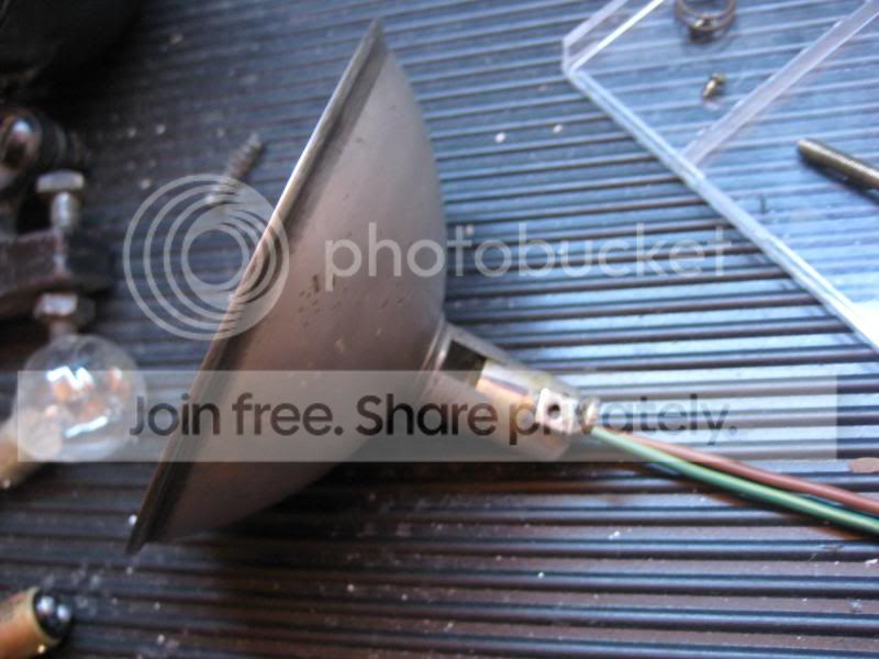

Modified the light buld housing to take an 1157 bulb using the wiring internals from a Yamaha tail light:

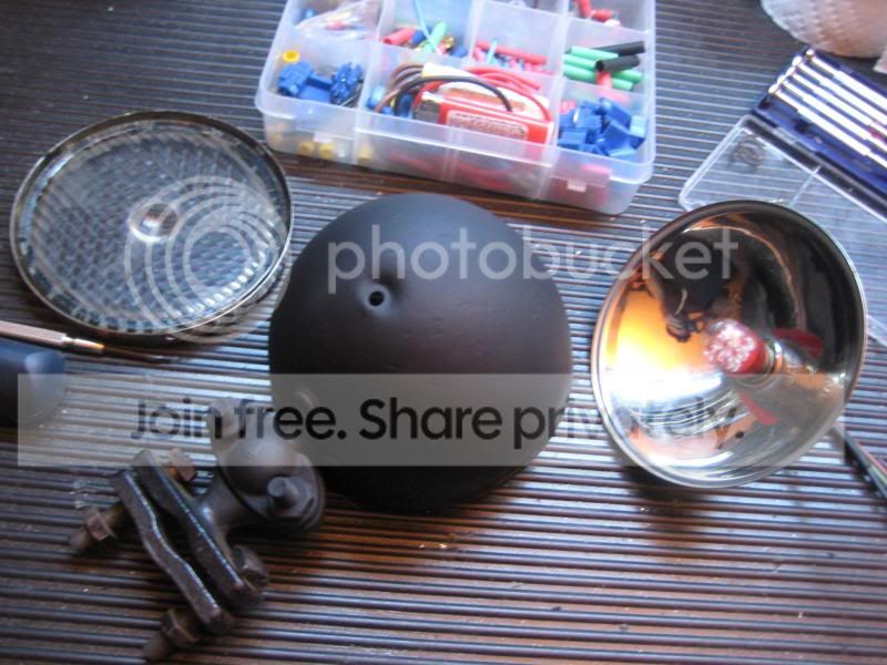

Repainted the shell and reassembeled:
