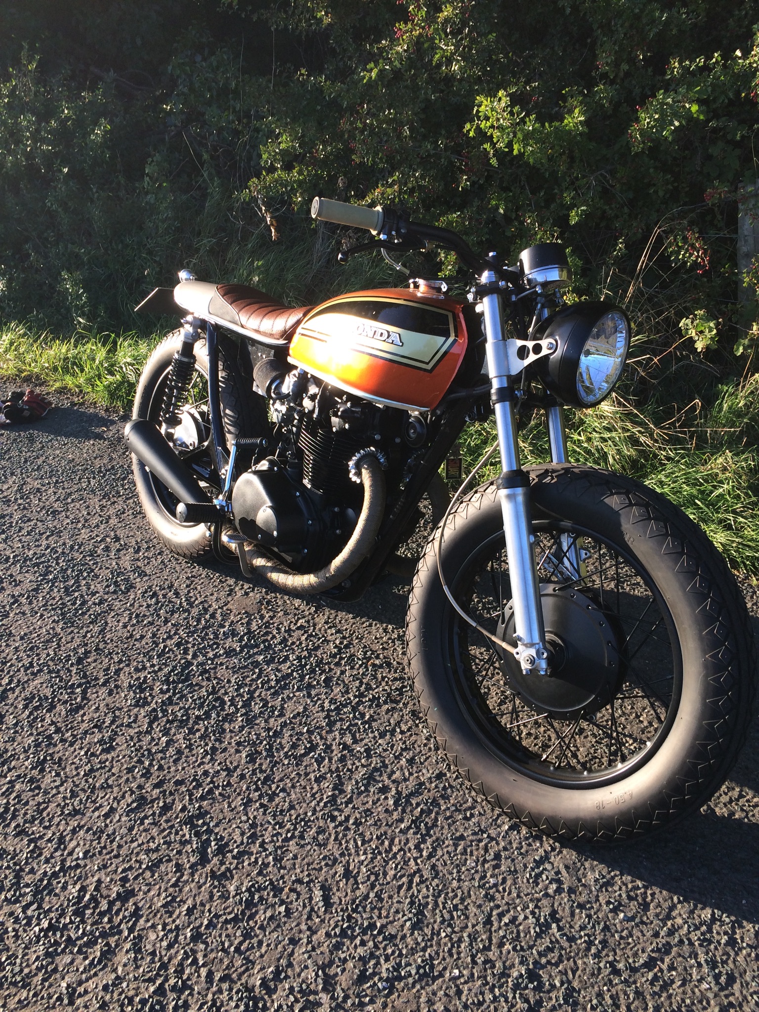

Left for a while for reasons we won't go into but thought I might post up a picture of the finished bike.
Hope you like.
Forgotten how to add pictures aaah jeez!
Ok picture worked so here's a couple more....
Kids have got a bit older and I think this year I'll be digging the shed out and going again ;D
What to do next........
