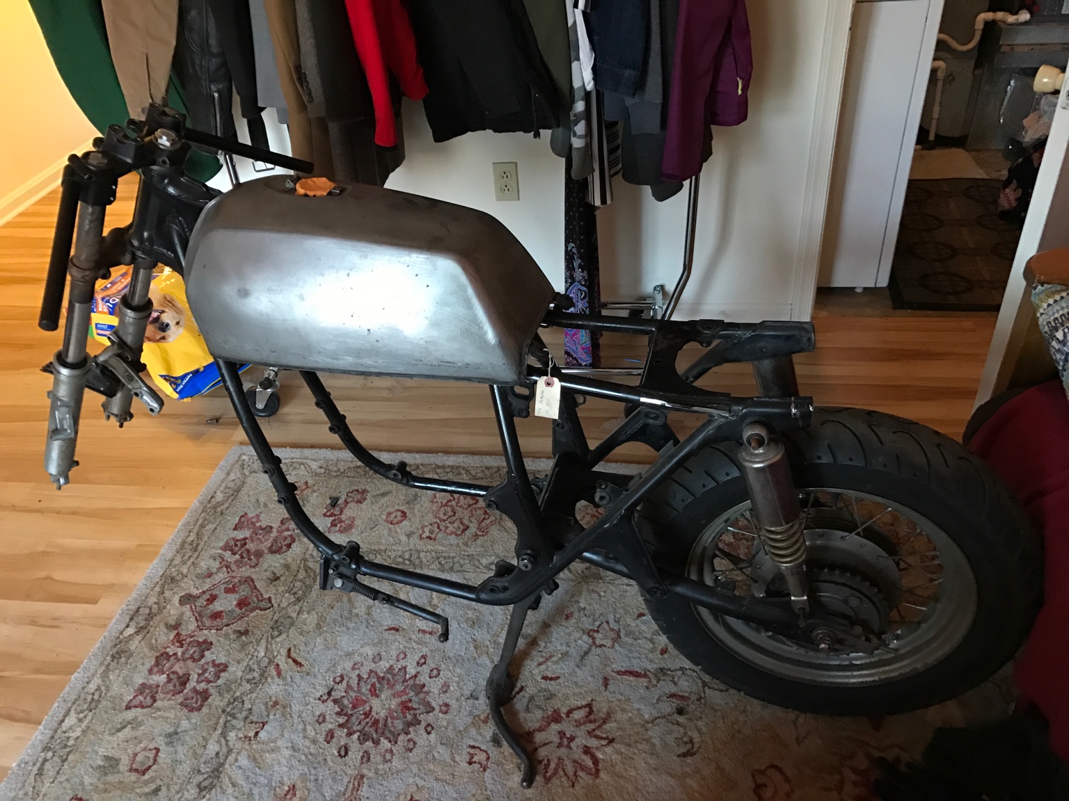

Skip the whole mono-shock conversion. If you want a mono shock for some reason, buy a different bike.
Put it together and get it running.
Put on some shoes
Download the Service Manual and Parts Manual - search the site - I uploaded them 10 years ago
Get some headlight clamps / bucket and get that on there
Put the front wheel back on
Find an original CB550 rear wheel - sell the 16" drop centre Harley conversion to someone building a bobber
Put some fresh AVON RoadRider tires on it (or something else - anything but Firestones)
Sort out your brakes - fresh pads, new brake lines (braided steel would be nice)
Put the wiring harness back on and connect the dots
Put the controls on the handlebars and connect the wires
Rebuild your motor - that's a good starting point given it's out of the frame and in pieces
Get a frame loop welded on the tail end of that thing - someone got happy with a sawzall
Sort out the mounting of that tank - Suzuki GS400? Doesn't look familiar
Put the other Suzuki tank in the garbage
Sort out a rear bump seat with room for a small battery under the hump
Sort out rear brake light and signals
Ride the crap out of it

Yes, for god's sake, skip the mono-shock. This is a useless modification, done wrong 99% of the time, and used mainly for bikes that will have pretty pictures taken in front of an industrial hipster background, and never be driven.
Could I design you a chassis with a mono-shock, yes. Would you even utilize it, no.

As mentioned above, I'd skip mono as well. Also I would ask Mike @ Kinetic what ID their kit uses.

Tank is a xs500
Other tank is gz250
Monoshock is out. Heard it would be good for better center of gravity, but I won't be racing it just riding around town and maybe some weekend trips

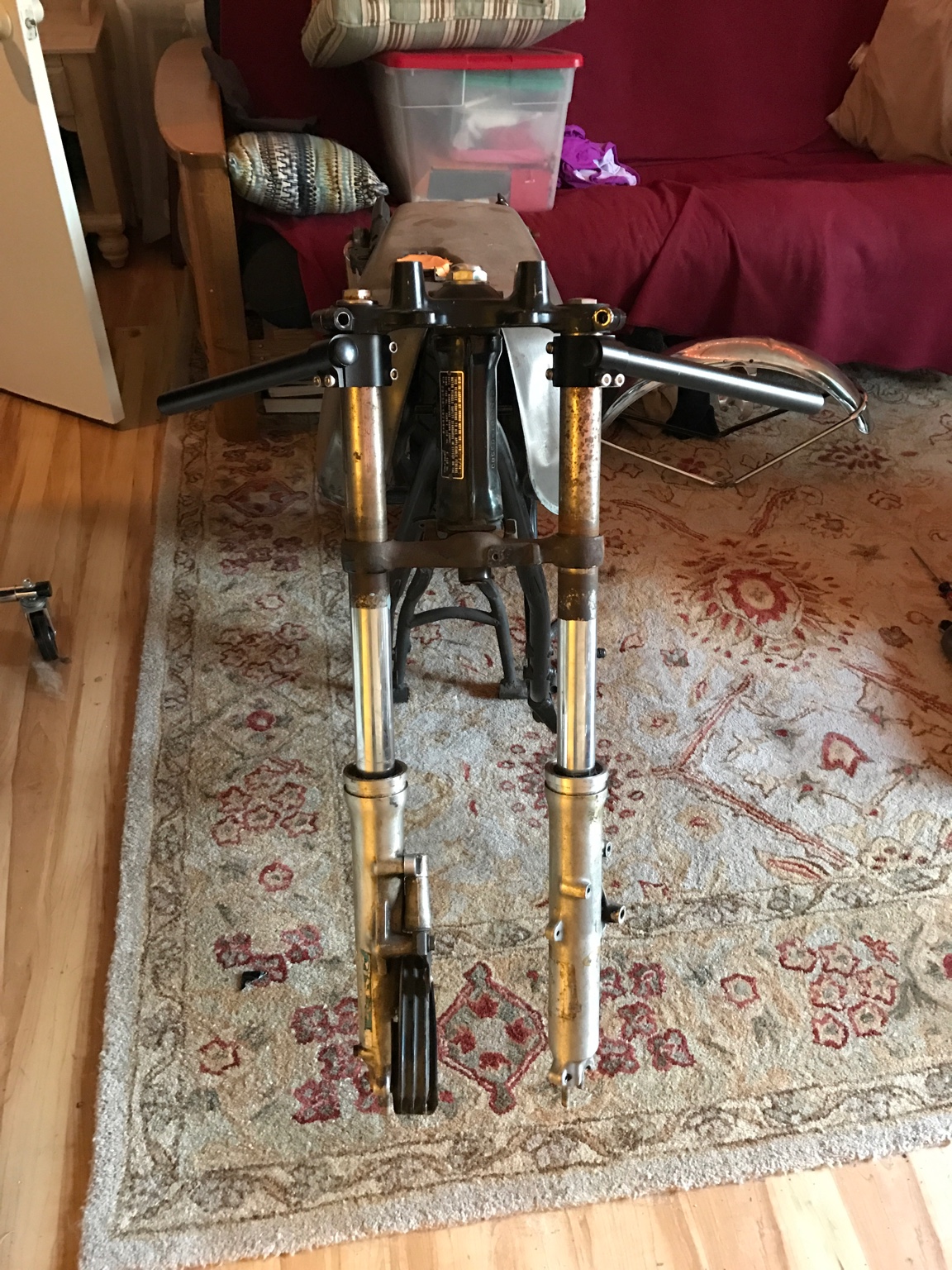

what tim said is pretty spot on. also, your left and right fork legs are mounted on the wrong sides.

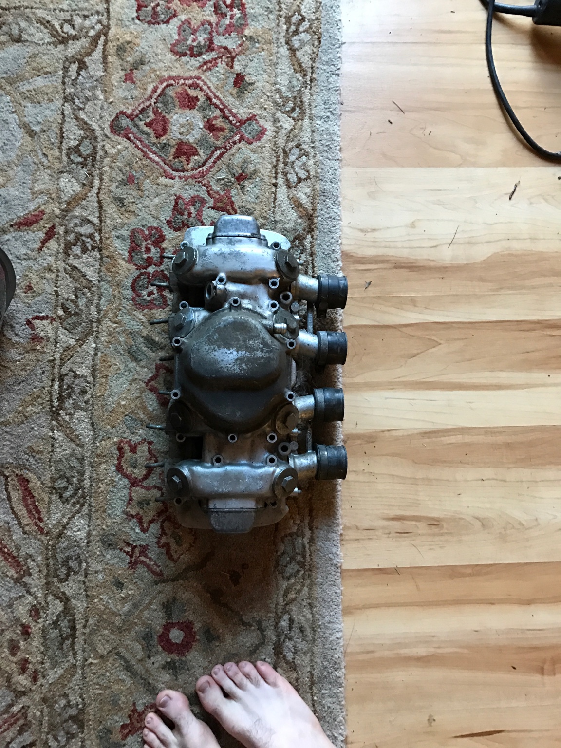

Looks like you're missing quite a bit.....hopefully you aren't missing all the racking components to make those 4 individual carbs into the stock rack of 4 so that they can function again.
definitely ditch the 16" rear.
def. don't waste money on a "monoshock" loop kit. just buy nicer dual shocks to run in stock location. Maybe Hagons

You are lucky to have that xs500 tank, imho they are the best no mods required tank for a custom build. Just make sure you pair it with a compatable seat unit.

Ya currently I've got a carb rebuild kit going on off camera. The guy who sold it to me had brand new gasket kits for the engine and for the carb too. Basically he came to a gaily on the project and the wife wanted a down payment for a house.
