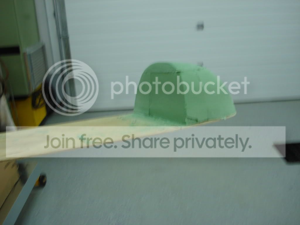

hey thanks for the info zixxer, i'll put it to use on my second attempt. I am almost done carving the mold. I went with the green florist foam bricks this time and it is way easier to carve and shape than that "Great Stuff" I used on the last one. I'll post up some pics when its closer to completion.
