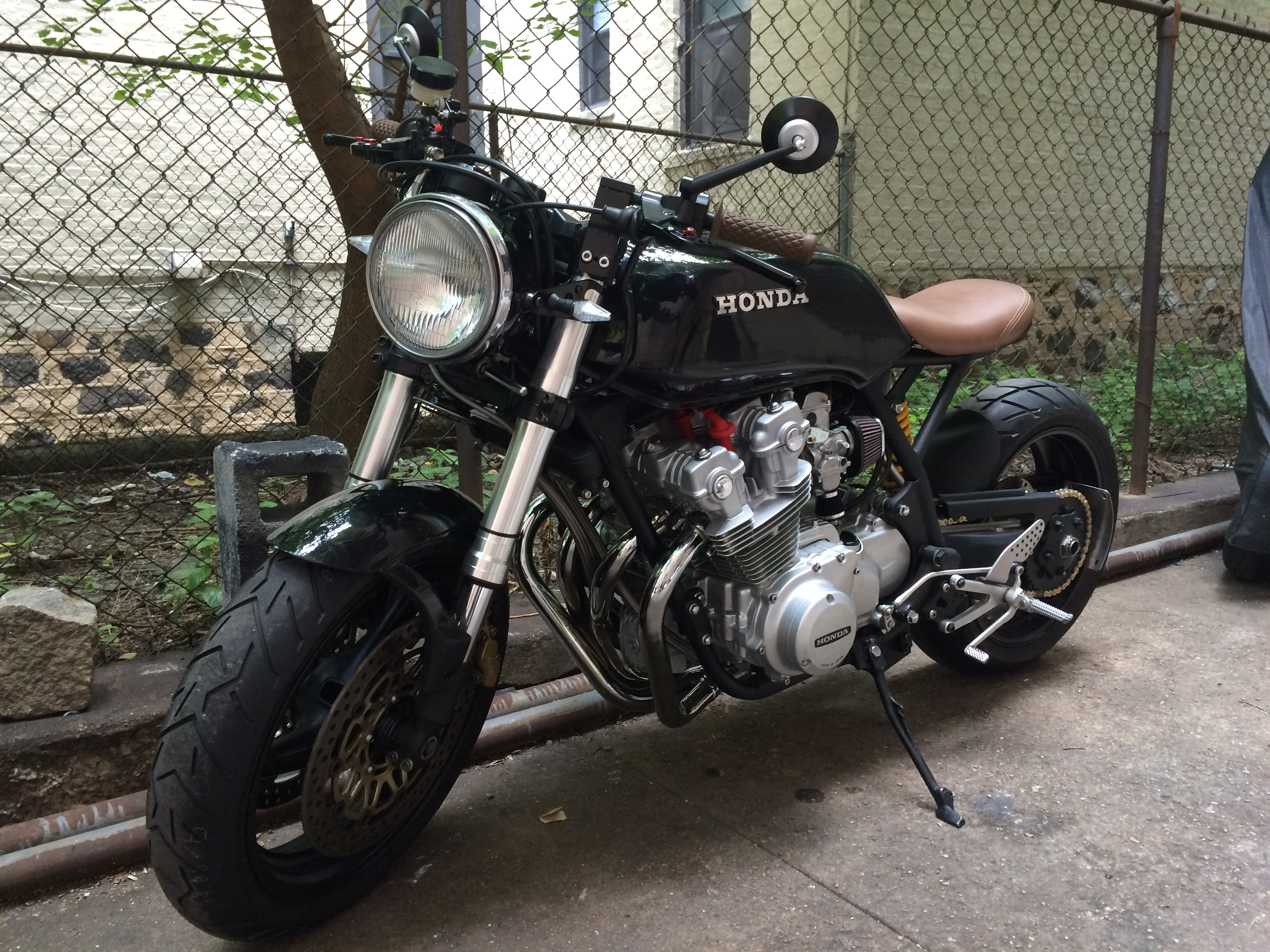

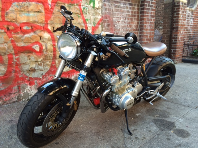

Here's my project i've been working on over the winter and spring. She's almost done. Just need to put the carbs on and button up a few things. She's got a ducati 748 rear and a cbr front with 900 cams. I can't wait to ride her!

Thanks djmaynard! It's a 79 motor that I rebuilt and put in a 1980 frame. Had some bent exhaust valves. I decided to go with a 1980 frame because it has a slightly beefier swingarm pivot. Wanted a little more support for the rear.
Didn’t really have one, I got pics I was just so busy with work and the project I never got it going. :-\
Rearsets are from a 2001 Yamaha R1 and the exhaust is a cycle-x 4-2-1. They sell the can separately.

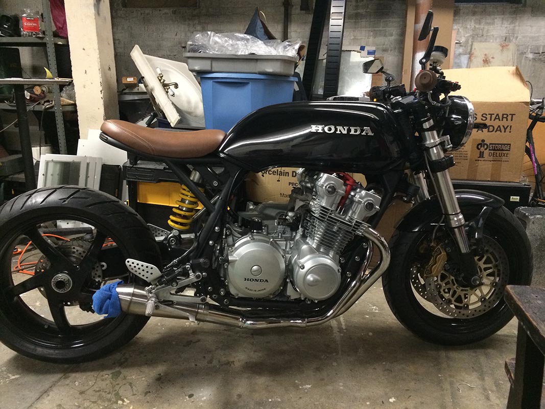

Here’s an updated pic.

I gotta say, I don't really dig DOHC Hondas, and I don't really like bobbers, but your bike looks pretty damn nice.
Especially like the way you've adapted the R1 rearsets / gear change rod. Nice ;D
