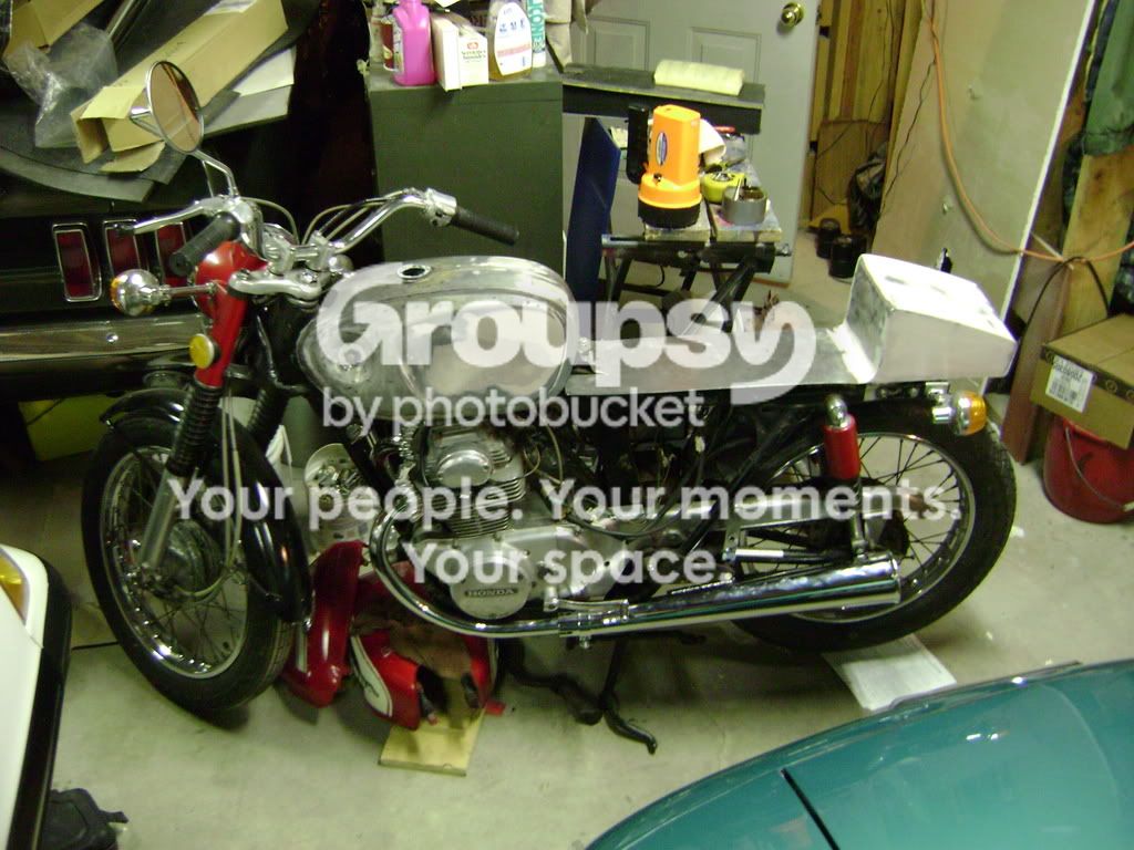

and bought new mufflers, and did new brakes all around, then mocked it up.
here is what it looked liked.

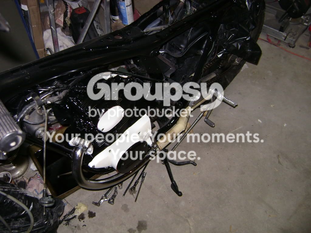

after i did this, i got every thing ready for paint, put on about 6-7 coats of black and took aprt the motor pannels and polished
them up.drilled holes in some pannels for a good look,

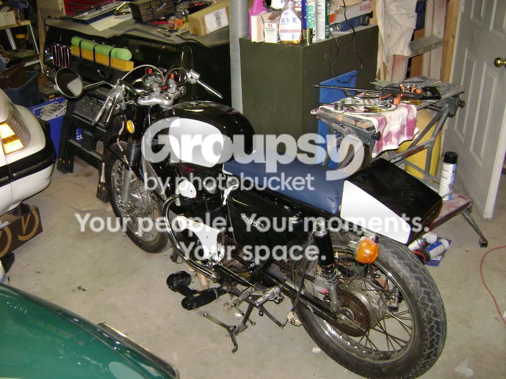

after that i decided to paint the pannels instead of polished look. decided on white, so i did 5-7 coats and 3-4 coats of primer.
and painted the motor black aswell. installed the pannels temp, and mocked up the rest.
also painted the shocks and head light pot.

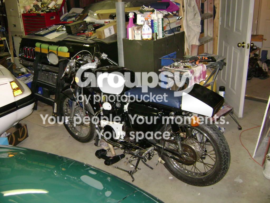

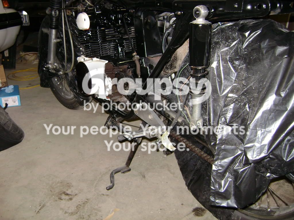

after this i painted the frame after masking every thing off. i was also deciding to or not to, to put on rear sets. was looking around
for a set and found aset from noel and decided to pick them up, ( thanks again ). i installed them as a mock up.
so after all of the muck ups and screwing around i was getting closer to my end product, i installed vynal on the tank and seat
then 1-2 coats of clear coats over them. and put the motor back together, and cleared it one more time.
at this point i mocked up the exhaust aswell.
