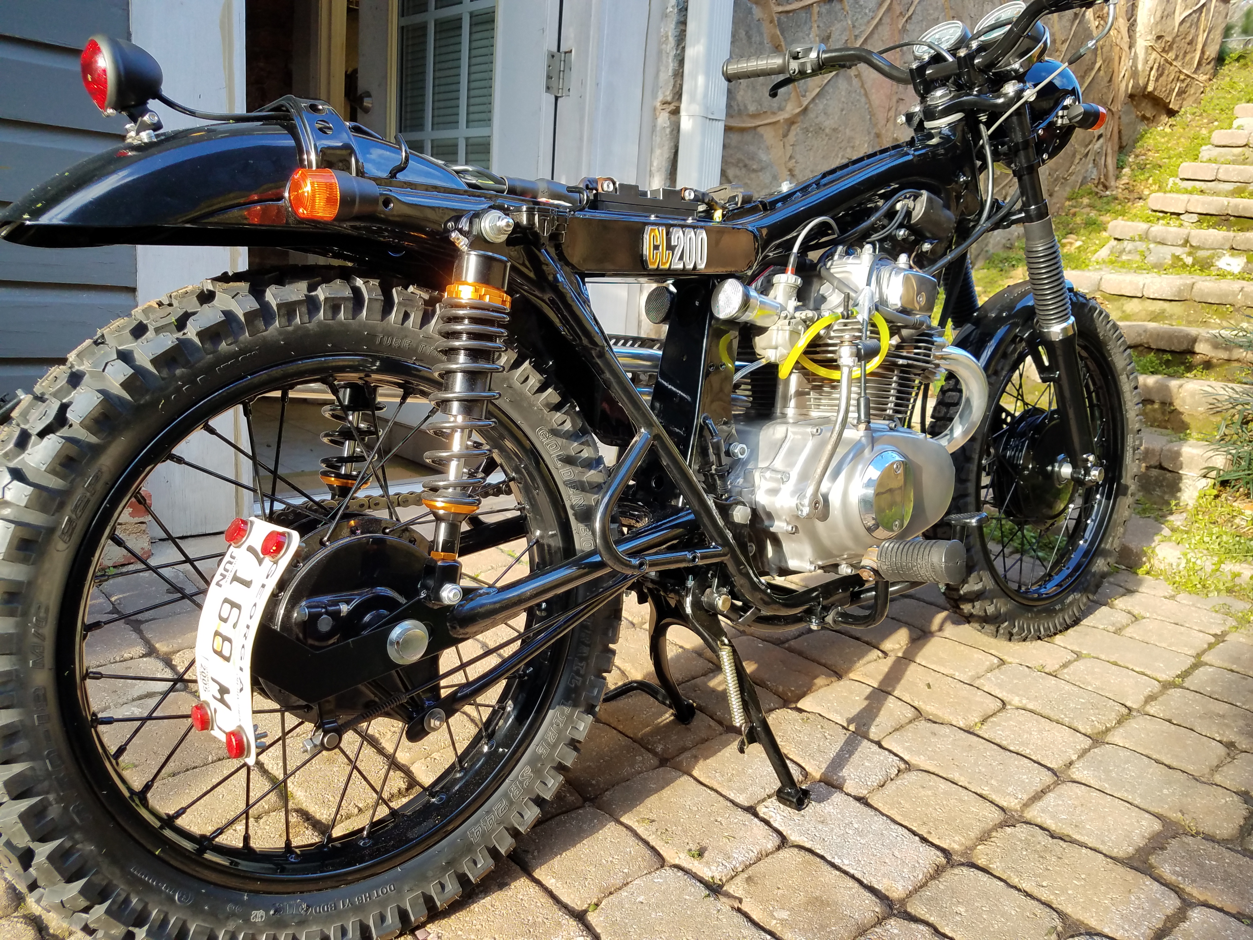

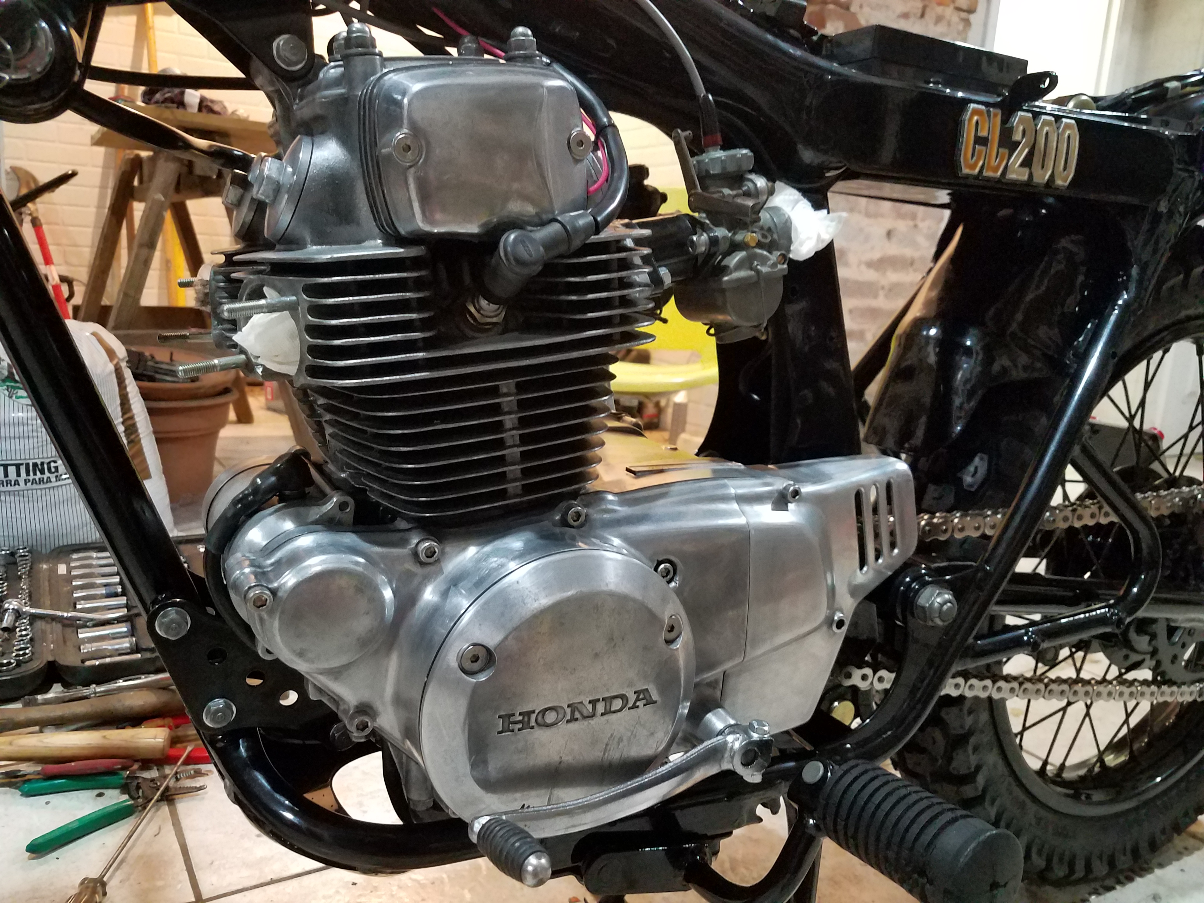

Here are just a few detail shots to show how I ran cables and wiring. I tried forever to get someone local to me to CO2 blast the engine but could never get anyone to commit. So I bought some Aluminum Brightener from Napa and gave that a shot. It kind of worked. It etched into the aluminum despite me only leaving it on there 20-30 seconds. I ended up having to polish it all back out. I also made the decision to trust my 16 year old self and run the engine as is. I had only put 100 or so miles on it back when I was that age after I rebuilt it. Then it sat forever (25 years?). It is still up in the air as to whether or not that was a good decision. Did a full service though. Cleaned oil filter, set valves, adjusted cam chain, etc.

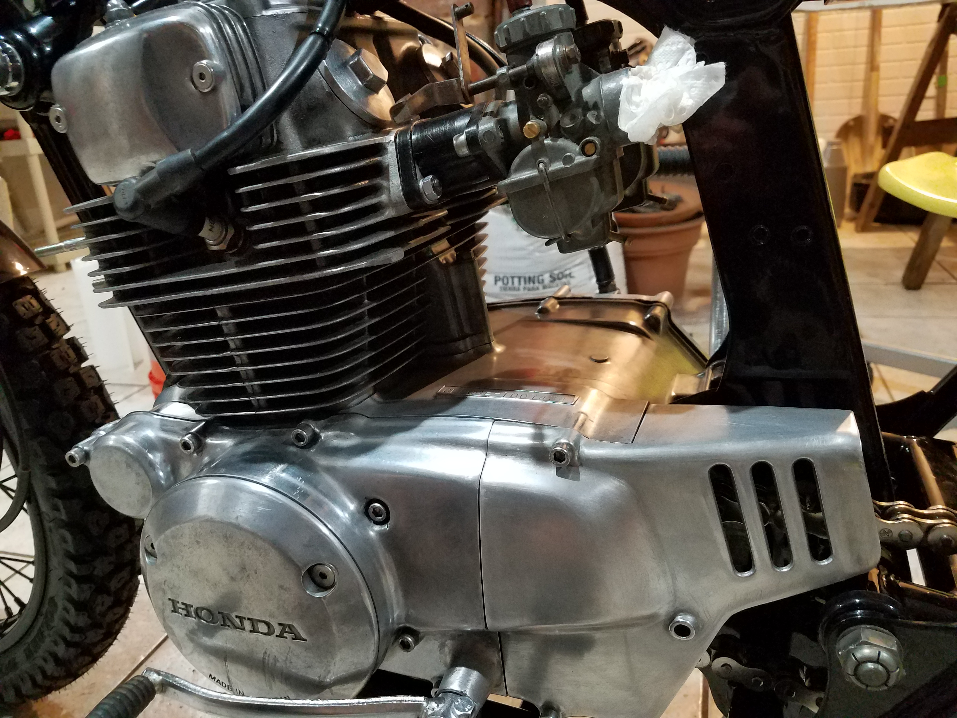

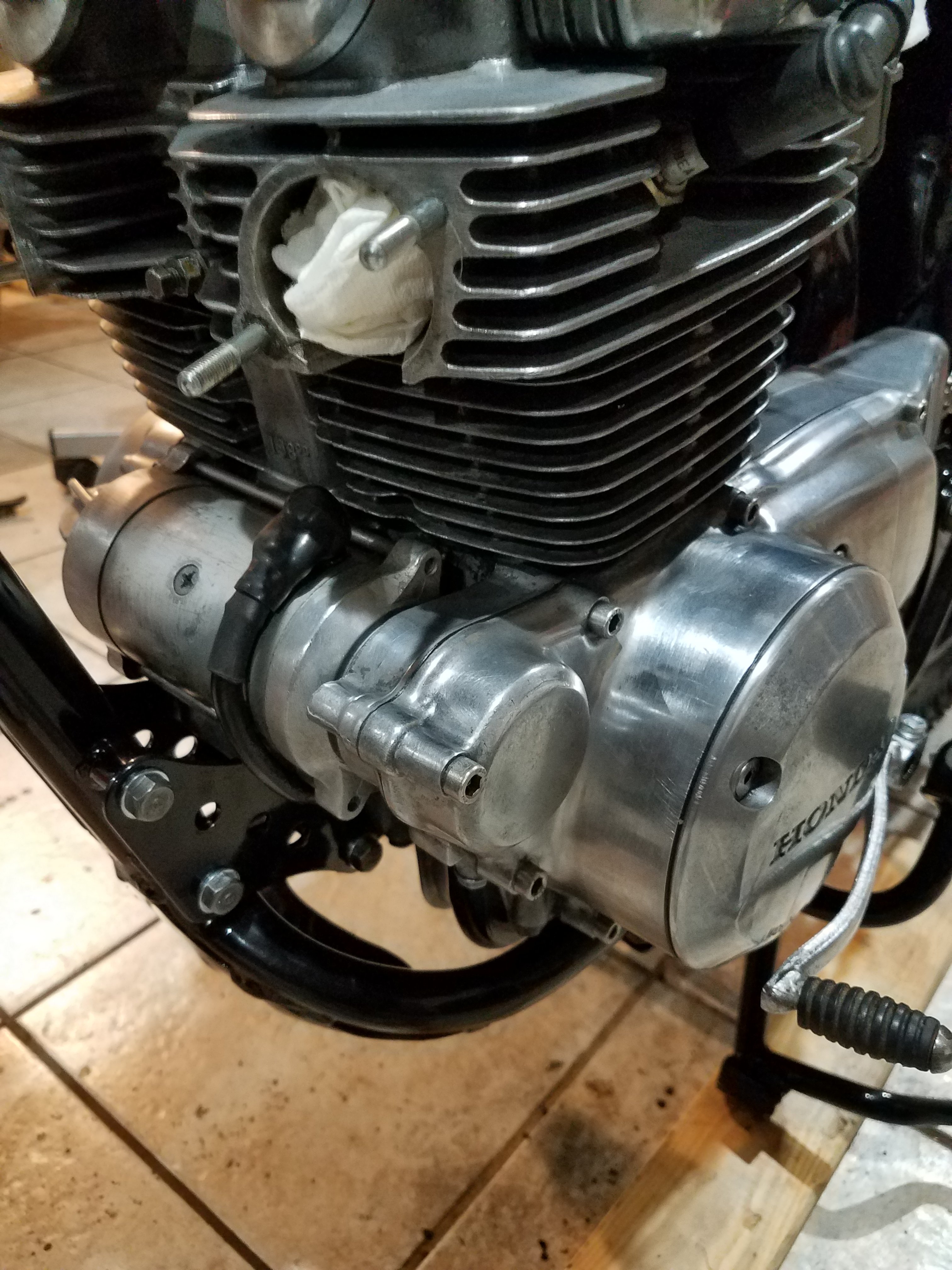

Bunch of new seals on both sides of the engine, new rear brake switch, kick starter seal, etc. Had to replace the left side points base as mine was cracked on the bottom for some reason. The bearing surface was still very nice on the one I pulled off. Surprisingly the bearing surface was also very nice on the replacement I bought on ebay. Made up a new starter cable and ran it all the way back to the relay. Glad I still had the tabs and brackets to hide the cable properly.

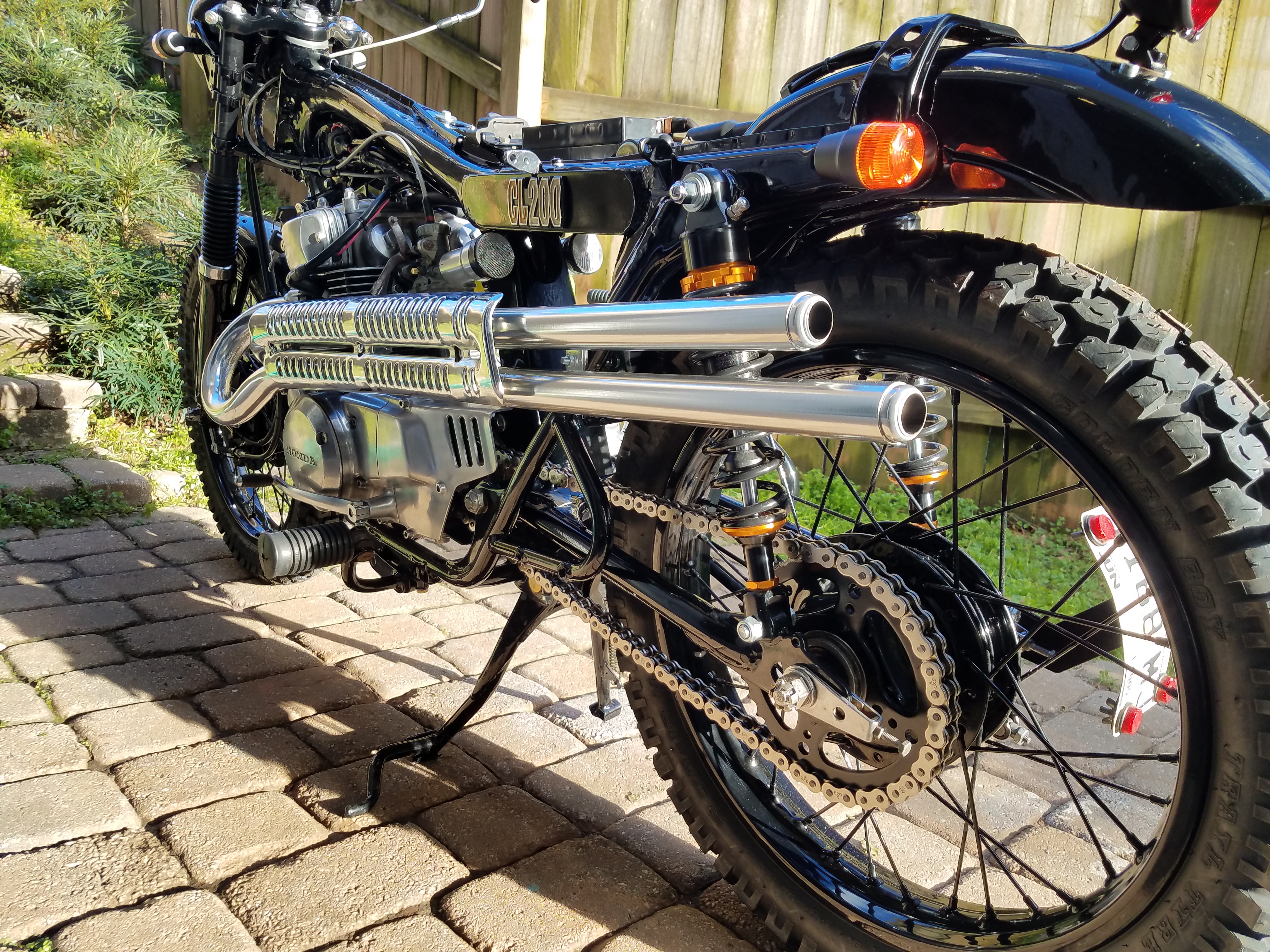

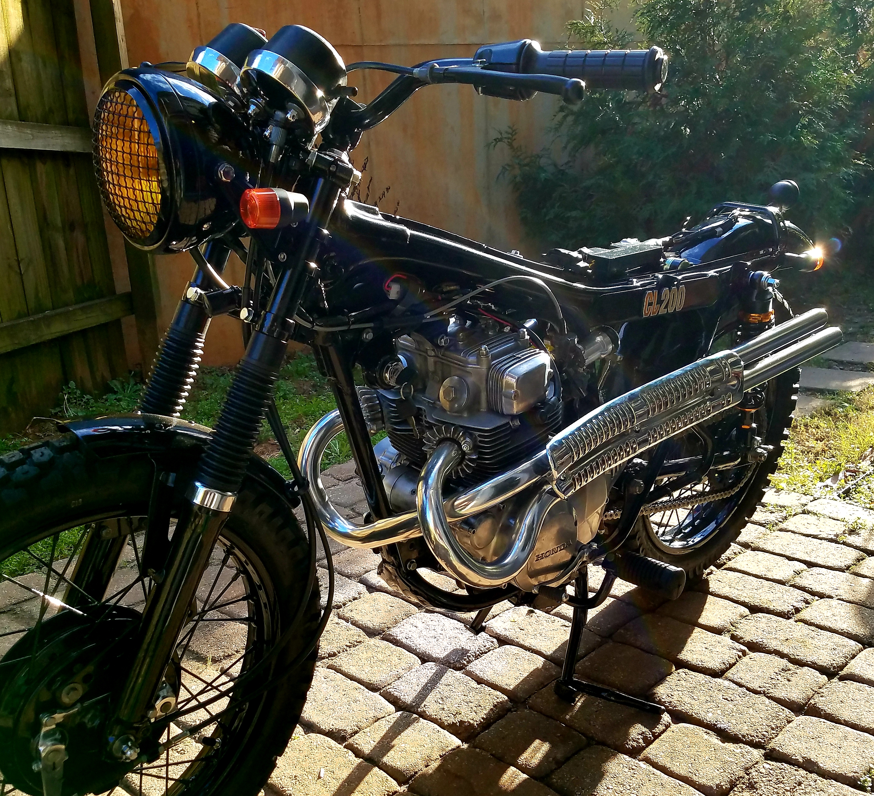

Got the exhaust back from ceramic coating and got it installed. Installed the baffles without issue. They fit perfect. Did a bunch of other stuff and rolled it outside to start tuning.

Forgot to mention, you can see how I hid the exhaust-to-frame bracket in the 4th and 5th pics above...the mount is insulated off of the frame with a rubber spacer
I was gonna mention something about a hanger. I think I had 3 break off and replaced w three different welded designs solid and through bolted, before I came up w a design that employs a rubber hanger. It’s been good for several years now.
I see you are through bolted to the frame. Should work great.
Yep. Bolted through the frame. You got me thinking though that over time the vibration might damage something. Maybe I need to add another thick rubber washer so I have them on both sides of the bracket. A rubber sandwich instead of just a heat insulation point like I have now. That would help dampen the vibration through that bolt and the frame.
