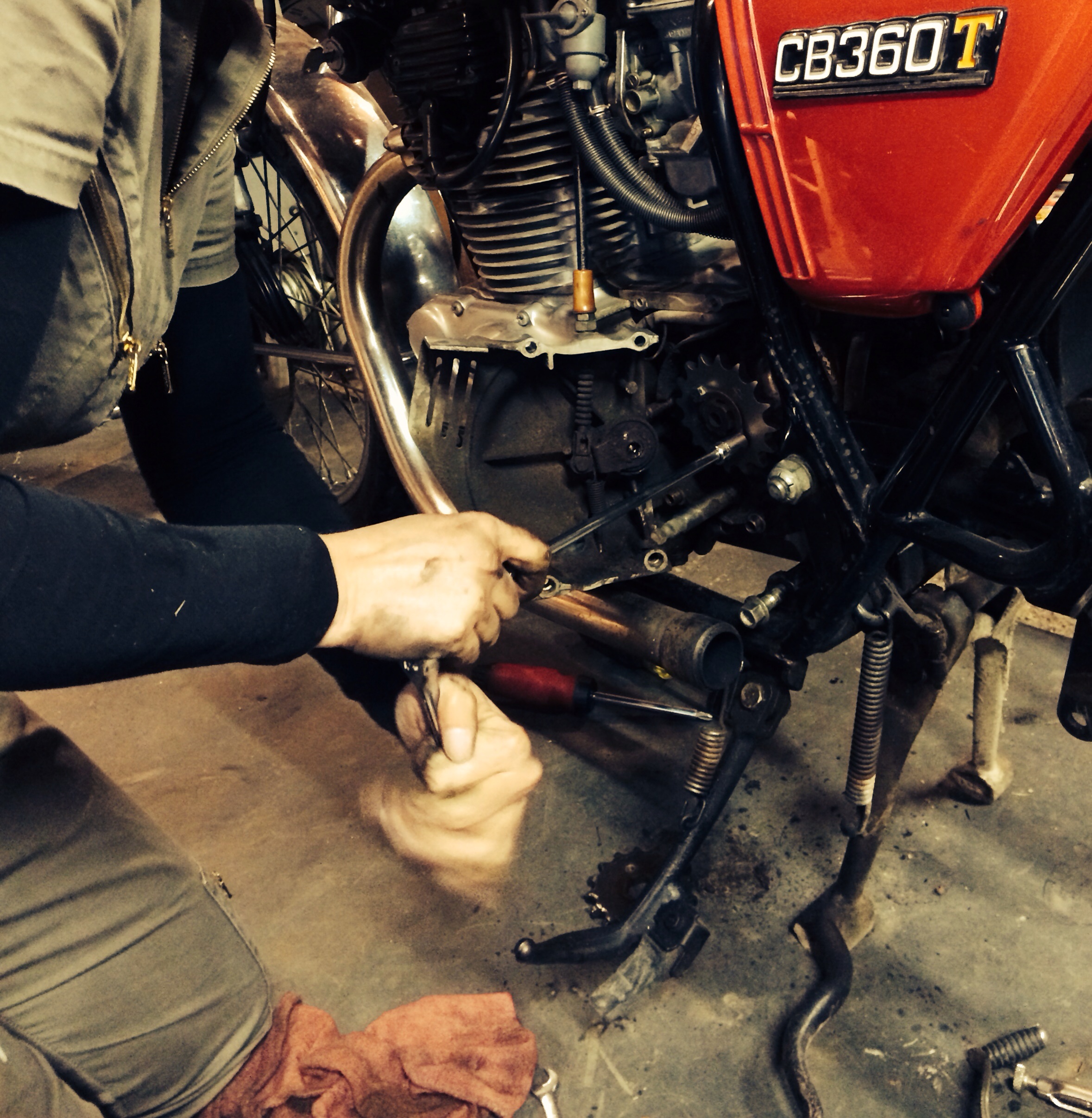

My first bike, still learning to ride but already taking it apart. Picked this up for $500 bucks, couple of dings but runs great. Started with the necessities, chain and sprocket replacement. Oh and had to get rid of those god awful stock mufflers.

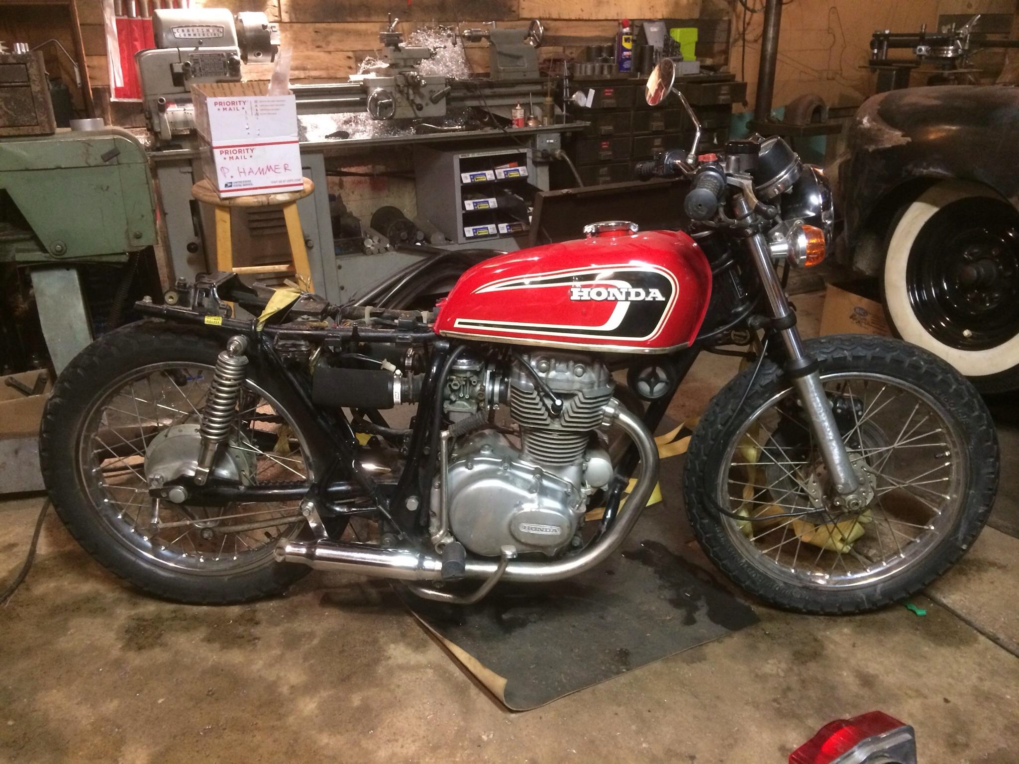

Now we're onto the fun part, my husband (todd) lowered it and removed the seat in preparation to make a new one. Plan to go with much less bulk then the stock seat... More to come... Stay tuned!

that is a great looking bike but it will run like crap with those short muffs,put the stock ones back on
and you really should leave it stock and learn to ride well before you molest it and make it less ridable and less safe
Cool, there is some rad stuff in there along with the bike. Neat dog ;D As for xb33bsa's comments he is a bit ruff, but if you want to use those shorties you may want to add a length of pipe to the headers then re-mount the mufflers farther back to avoid tuning issues. Also those are not quiet at all, they are almost piss the neighbors off loud (Like xb33bsa ;D) I had them on my 450 and I used 2 lawnmower mufflers from tractor supply in them then drilled them slightly until they had a nice sound. Welcome to DTT,

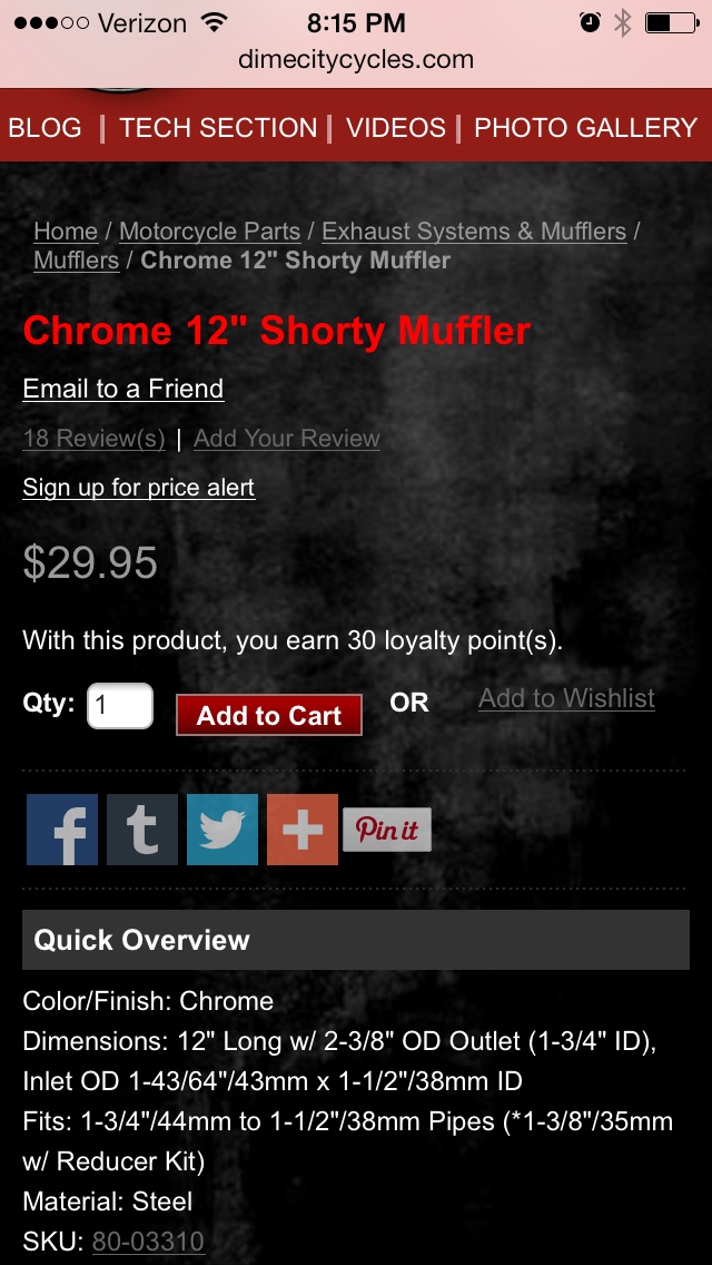

May I ask what brand shorty mufflers those are?
Thanks for the advice maritime, will take a look at extending. As far as the noise goes, haha, wanted to make it louder. Sorry in advance neighbors ;)
