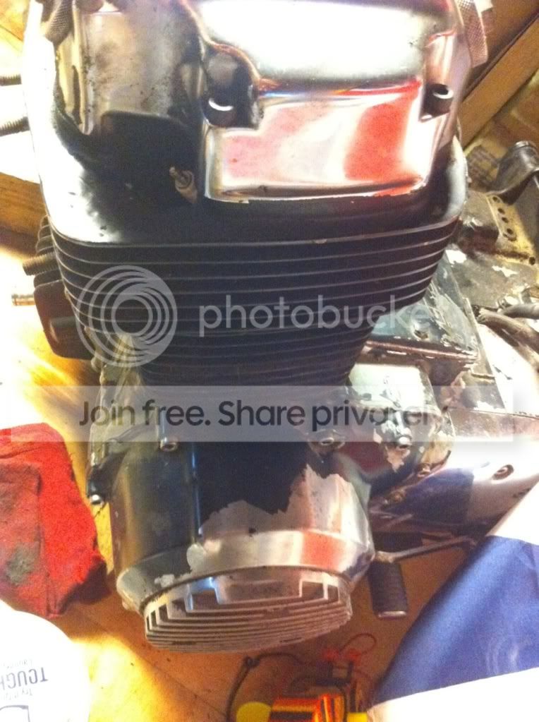

i started cleaning up the engine on the K bike today. ive got my work cut out for me and im not really sure how to get a lot of this stuff clean. the fins are going to be a chore. the old owner painted the entire engine black with some terrible paint that did not stick at all. paint is peeling every where and i want that off. i plan on keeping the jugs black but id like the rest of the engine to go back to its original aluminum color. still i need to get the jugs clean and repainted because if i paint them like they are its gonna look terrible. again... any advice for getting paint off in these hard to reach areas would be much appreciated. basically what do i need to do to get paint off of an entire engine?
sorry the lighting in the garage isnt that great.... we could stand some light in there.

Hey some Aircraft stripper for the paint on the motor. You can try the spray stuff if you want, but you'll need like 5 cans and still be frustrated with it. Get the big can of it - works so much better.
Do you have a bench grinder in your garage? You can actually fit a buffing wheel to one and get a mirror finish on just about everything.

i looked for aircraft stripper at lowes. they used to have it but apparently they no longer do. at least they didnt have any the other day. where can you get it? i can get a bench grinder. what kind of buffing wheel? are there different types?
They sell aircraft stripper at any Advanced / Auto Zone. It's somewhere around $22 a can.
I bought the cheapest bench grinder they had at Sears and a loose cotton wheel. Dont know what the technical term is for it but it looks like a couple rags held together by a disc. And get some rouge too - brown and white.
Try Harbor freight out off of St. Andrews. They have CHEAP bench grinders, pads, etc etc. They're tools are shit, but cheap as hell and there is a TON of useful stuff out there. Also the K-mart near Jersey Mike's/Auto Zone/rosewood is a nice place for 0000 steel wool, scotch brite pads, and sandpaper (all the stuff you'll need to get that engine looking better). While we're at it, that lawnmower shop next to k-mart is a good source for high quality inline fuel filters. Oh yeah, that autozone has the aircraft stripper you need. But, that stuff is nasty and it f's you up if you inhale it, so def do it outdoors.

thanks for all the useful info. ill go grab that 0000 steel wool tonight. do you think the 00 steel wool would be fine on the aluminum parts?
youve really done your shopping around here huh?
You'll want to use a couple different compounds I believe. Do a search on youtube and you'll find there are a bunch of good how-to videos. I just do the broke ass polishing jobs... scotch brite & WD-40, then 0000, then more 0000, then oh god more 0000.
Just make sure you have a strong magnet handy to pick up all the steel wool shavings left behind.
Sounds too much like work to me.
I always wet sand my way through the grits - working up to at least 1000 grit. Then the brown rouge on the buffing wheel, then onto white rouge.

whats your wet sanding procedure? do you use just water and dish soap?
Be sure to use a blow drier or something when attaching the fabric - it will help stretch the vinyl.
And no dish soap, just plenty of water. Keep the part clean so you can see any scratches and keep the sand paper clean since it tends to clog fairly quickly.
A little hand soap helps to stop the paper from clogging. You are looking for Wet and Dry and not Sandpaper, but you probably already know that.
Steel wool for a satin finish - WD40 as wetting agent.
Wet & Dry and polish mop for liquid metal look.
