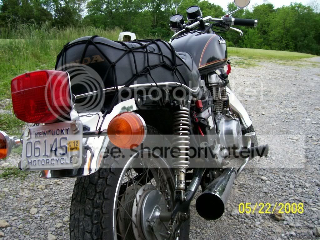

Before we get too far, let me give you some background. I got my CM400E as a gift from my wife about three months ago. She knew I've always wanted a bike, plus since gas is the way it is...it was a practical choice... ;D yeah for practicality!!!! ;D So, I rode it around for barely a couple of weeks before I realized I NEEDED to do something with it. At first I wanted to make it more of a cruiser, so I through some saddlebags on it and almost through some crashbars on it. But, after some www searching I found the cafe racer style. I knew immediatly that this was what I wanted to do...why make this bike something it's not. I figured i should play to the bikes' strengths. It's a small cc bike, what did the rockers do with a small cc bike? exactly...cafe racer
So I took off those evil saddlebags and threw on some clubmans, that alone dramastically changed the look of the bike. Then I took out that HUGE air-box and through on some pod air filters,-hence the other thread about adjusting my carbs.
so here is what the bike looked like after that.

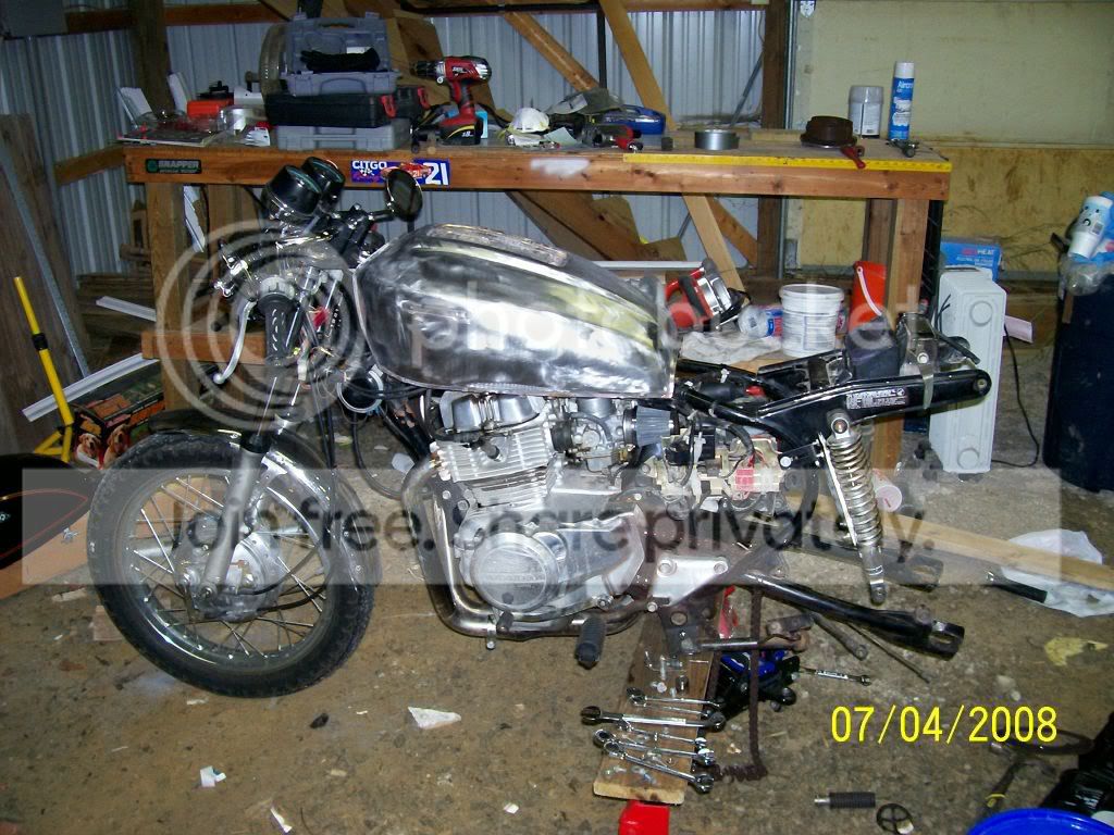

Well, second night after deciding to really get busy. All day today while my wife and I were driving around town in this rainy july 4th, all I could think about was gettin' back to by bike...get some more work done.
Since I don't have a bike lift I had to jimmy rig one. It's a wonder what a piece of wood, an hydraulic jack and some stands will do.
Once i got 'er up I started tearing into her. I took off the tank, chain guard (KD ;D), and rear tire. I'm hoping to get new tires this weekend if I can get them for the right price from the local shop. if not, then online I will go.
I went ahead and took off the rear fender, taillight and, yes, indicators. I relocated the license plate to the left side using a bracket off an old CB radio mount.
I needed to tune my carbs so I decided to go ahead and take them off and see what I could do. This is what slowed me down. Now, like I've stated before this is my first project. When I worked on cars I alway worked on ones that were fuel injected, not carbed. So, when it comes to carbs, I'm a little lost...ok BIG lost. My book isn't very clear on which needles I need to adjust to better my mixture. So, maybe my DTT family will be able to clear up the fog in my head.
When I take apart the carbs I find more than a few needles and I don't know which to adjust. Do I adjust/change the needles in here...
or these?
forgive my ignorance.
So, there you go. Heres a nice mock up with the new tank on. I can't wait till this bike is done!!!
more to come

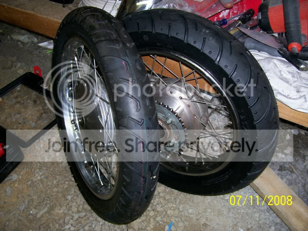

OK so, today in between taking people to the hospital, I was able to order some new tires. Kenda challengers, $41.95 for the front, $51.95 for the rear, and $15 each to put them on the wheels. Gonna go tomorrow and get them changed over. So, when i got home I went straight into the garage and took off the front tire. I also decided to clean the tires up a little. I took a tooth brush and some carb cleaner and washed each spoke till they shined. I wasn't really prepared to get wrenching so I didn't grab my camara...sorry :-\

I also got my wheels and tires back yesterday.
So, yesterday wouldv'e been a GREAT day, since I got the tires on and my new seat in...but since I can't get the bike to start, it's no good.

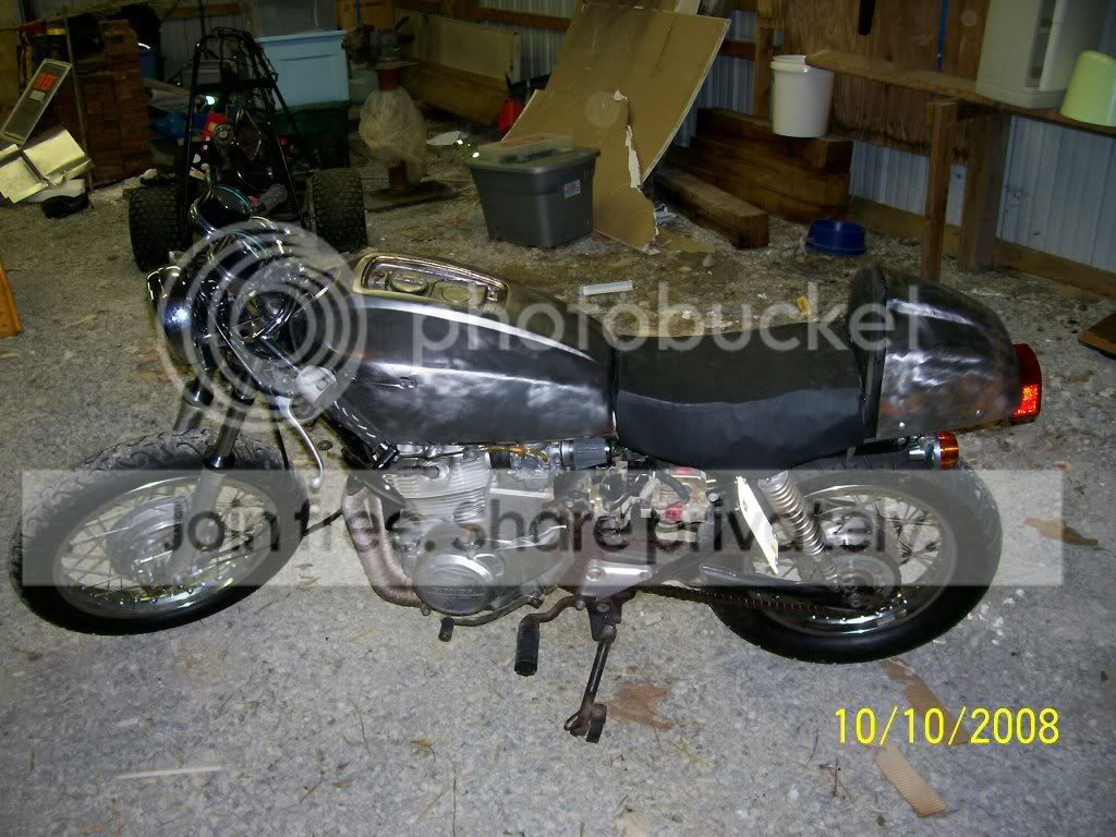

Has promised...pics!!
gimme some feedback...remember, it's NOT done....just "road worthy"! ;)
I couldn't figure out the wiring for the integrated tail light. I figured I'd use the old lights untill I could get things together. I can't figure out my headlight though...for some reason my high beam stays on. I don't have a clue how to fix it. Help would be nice. hint hint wink wink ;)
The cowl is made out of the old original tank. My seat is made partially out of the original foam and that floor tile foam stuff that locks together, same with the "bum stop". I plan on re-opolstering it with leather soon. Now it's just vinyl. Like I said, it's still a work in progress.
