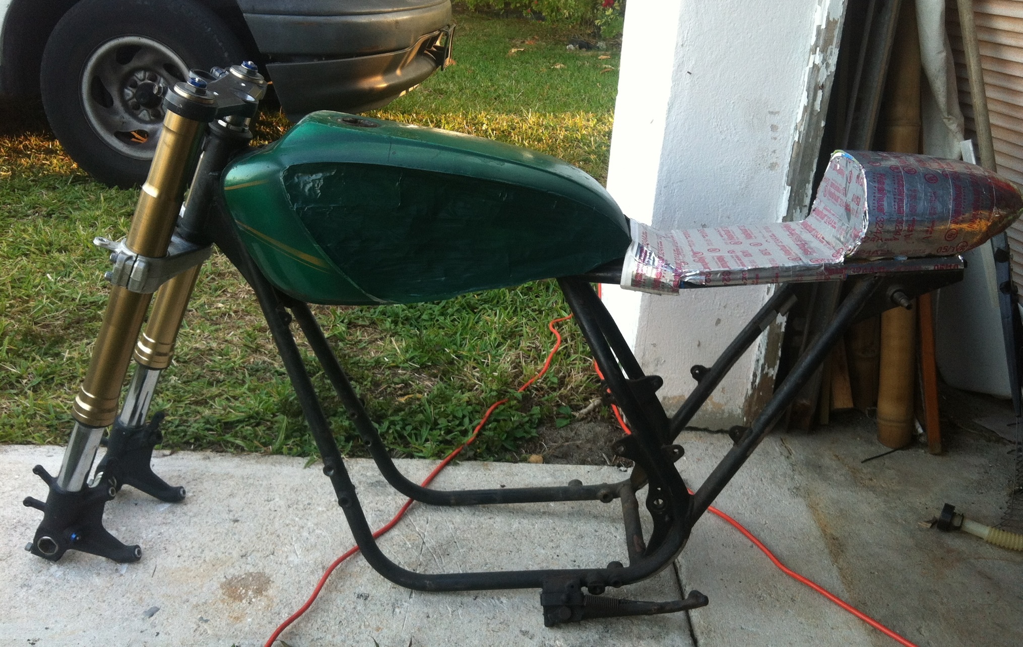

This is my first seat and tank that I ever mold , il be ready for Fiberglas son pls what you kits think of it ?

Now that you mention it it is , good thing is not finish . ::)

Definitely put a radius around the edges, otherwise, you're going to have a hell of a time getting glass to lay down properly.
seat looks great. the tank is too angular. What's your plan on the tank for dealing with ethanol? vinylester? or just polyester plus a good tank coating?
Here in my neinorhod there is a gas station that sale gas whiteout ethanol , is more spensive like $4.12 a gallon .
I'd use vinyl ester, or epoxy. If you ever choose to take it out and ride it, or take it to, say, Barber, Mid-Ohio, etc, you may not be able to find a gas station with no ethanol. And, line the hell out of it.
+1
I would't base my build plan off of the business practice of a gas station, unless I was at minimum, a co-owner of that gas station.

well that is true . i think id use epoxy resign . overall i think looks god , this is my first bike and the true the las time i rode a bike i was 11 and now well ;D

If you don't round off your edges, though, you're going to have a tough time with it, unless you're vacuum bagging.
In this picture have the original tank it was cut I don't like it
