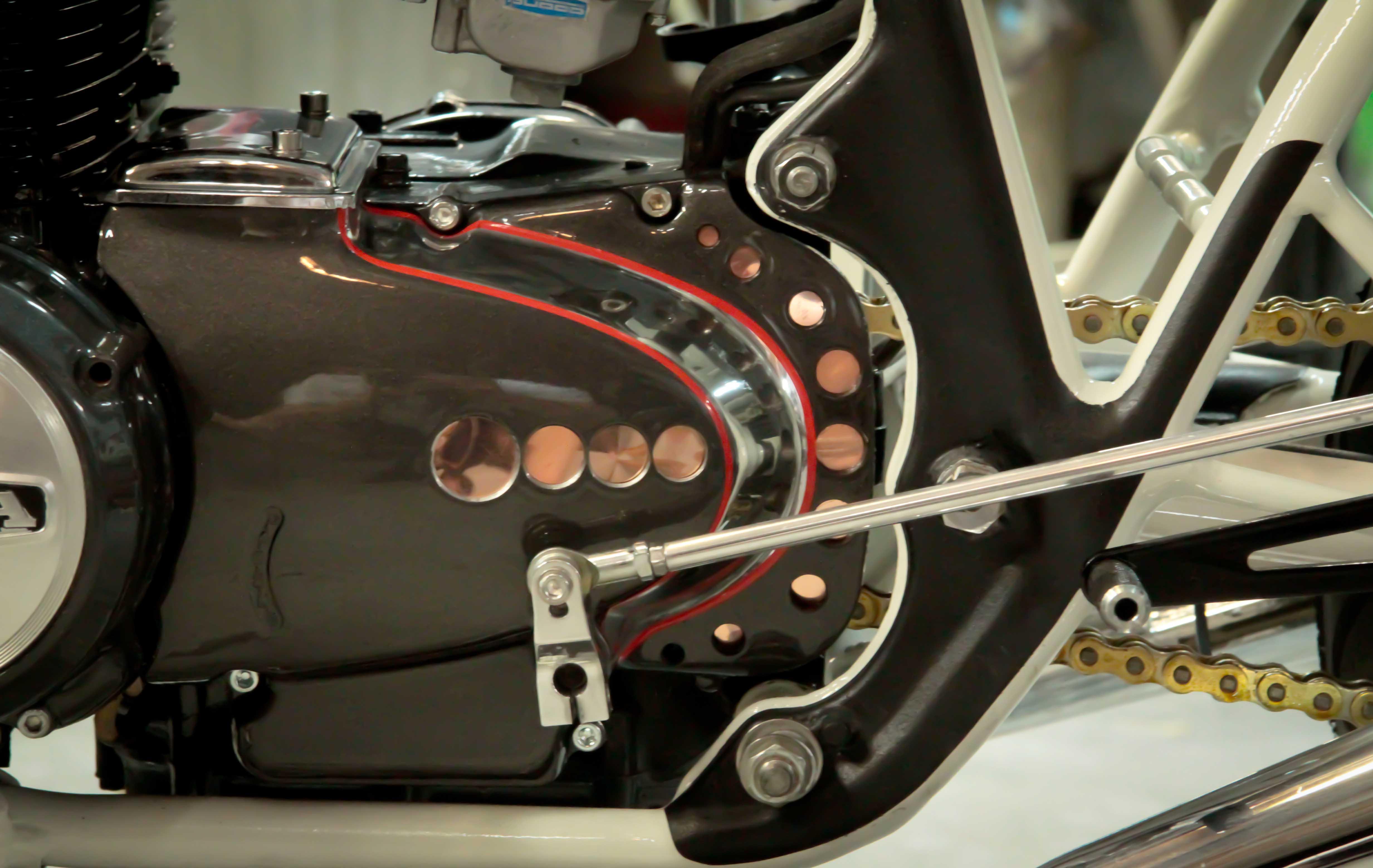

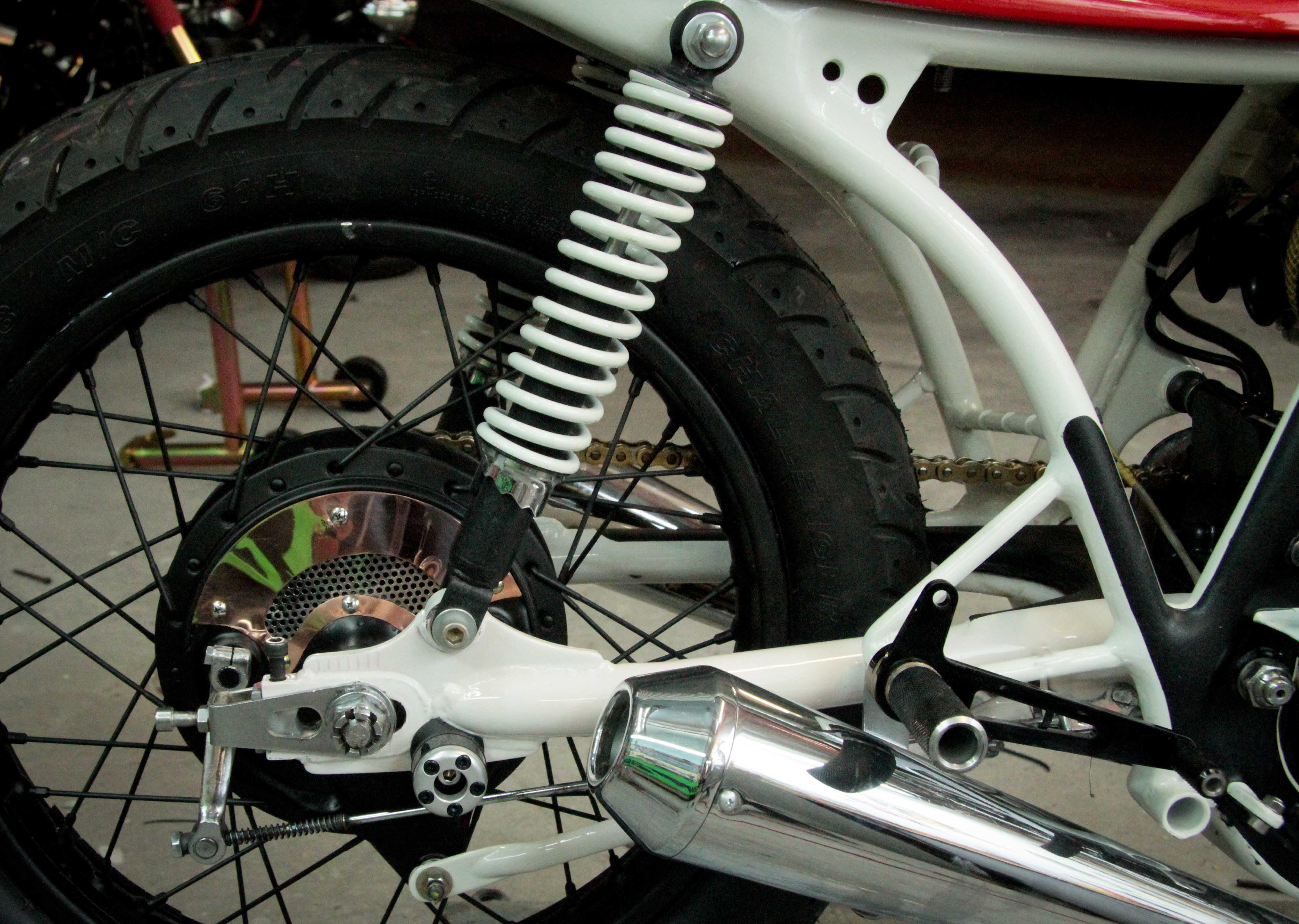

My lastest build 60's GP Racer out of a 74CB550
Mikemach
I'm finishing up this little Cafe and unveiling it at the Iron and Air tent this weekend at Barber. I was hoping to receive the front fairing this week from Airtech but it doesn't look like it will make it in. Hope you guy's like it.
Mike McFadden
M&M Customs.
74 CB550F
CR carbs
Redesigned Sub Frame I like to call it the reverse featherbed
Paint and everything else was done by myself.
Rear hub and Tail section
Last picture is where they are all conceived.. ;D

Very nicely done but too fussy for my own tastes.
As a pro level build I'd make a few suggestions:
Needs an inner rear fender of some sort. It doesn't need all those cross brace tubes but that's mainly styling.
Carbs need to be on proper rubber stubs to bring the carbs forwards and more upright.
White looks stunning until the first time it runs and it's all downhill from there - I tried it a couple of times before - but it does look striking while it's fresh.
Pipes need work to tuck in better at the front of the mufflers. It appears that the lowest part is also the widest and that's a recipe for "negative clearance".
I suspect that the rear light is not DOT compliant and around my home town would get a ticket for obscuring the light.
Good luck. It's a looker all right and with a few minor tweaks will be even better. :-)
Well pretty much everything you just posted is all opinion. I understand what your trying to say but without seeing it in person your wrong. The white will hold up if you look close the areas of black are chip resistant coating. Not cheapo Rino we are talking industrial. The header pipes are atleast 5 to 6 inches higher than stock. I will gladly show you a knee dragging on it and as low as any stock550 will go. Hehehe. The cross bracing if your a professional builder and rider you would know that a frame that has more rigidty the better your bike will handle in most cases. Not always I know but in a bike that is so light it helps. This isn't new to me. I hate inner fenders so no go for me. The tail lamp is from the actual stock 550 light. The lense is also a Dot. The cross braces are not tubes they are solid milled stainless.
