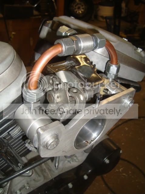

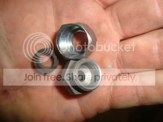

I just finished up with the new breather system I made. I found these cool compression fittings when I went to the Swift Cycles closeout a long time ago and just found a use for them. I finished up the routing of my new breather fittings to a tee I made out of aluminum stock.
These are the fittings
I filled up some 3/8" copper line with sand and bent it to shape to put the rest of it together.

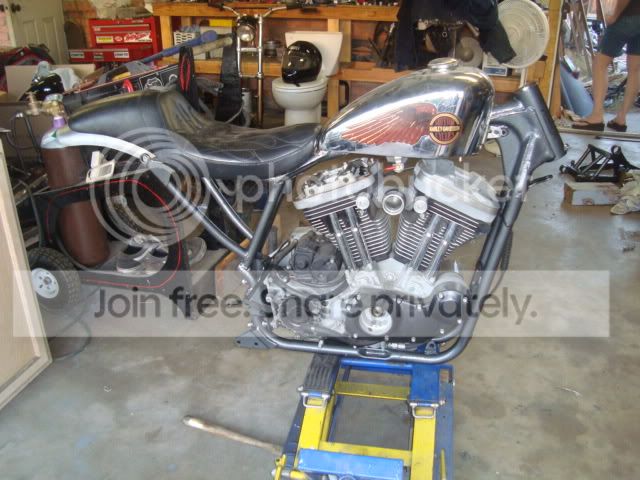

I took the old tach out of its steel casing and made a mount out of aluminum. Much Much lighter. New braided brake lines with silly little mounts to keep them off of the fork tubes.
As you see the bike here it weighs 406lbs. Add 15 lbs for oil tank, oil and wiring, and I'm definitely going to be under my 430lbs wet target weight.
