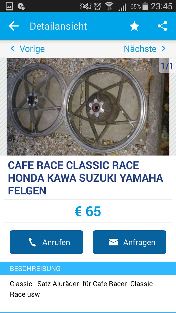

Hey guys!
Do you know where these wheels are off?
Is it yamaha?
Thought about putting them on my Yam RD.
Any help appreciated!
Don't want to be nit-picky but they are not Tempter wheels - the pattern is slightly different.
They are a disc rear wheel too, so that rules out the Tempter and GS250/450's.
Either GS550/650/750/1000.

And the rear is an 18" which limits the models even further.
Enkei makes the wheels, I have a nice set for sale as well, these are gs550e wheels. ;)

Thanks guys for the insight!the owner just wrote me that they were mounted on a egli honda.
Are they worth the money?
Do they tend to crack,they look pretty fragile :-)
Cant say I've ever known Suzuki mags to crack or fail (apart from impact / abuse) but then again I was most active with those bikes about 15 years ago but they're approaching being 40 years old now so I don't know how they are going to behave after this long.
Probably will be OK though.
