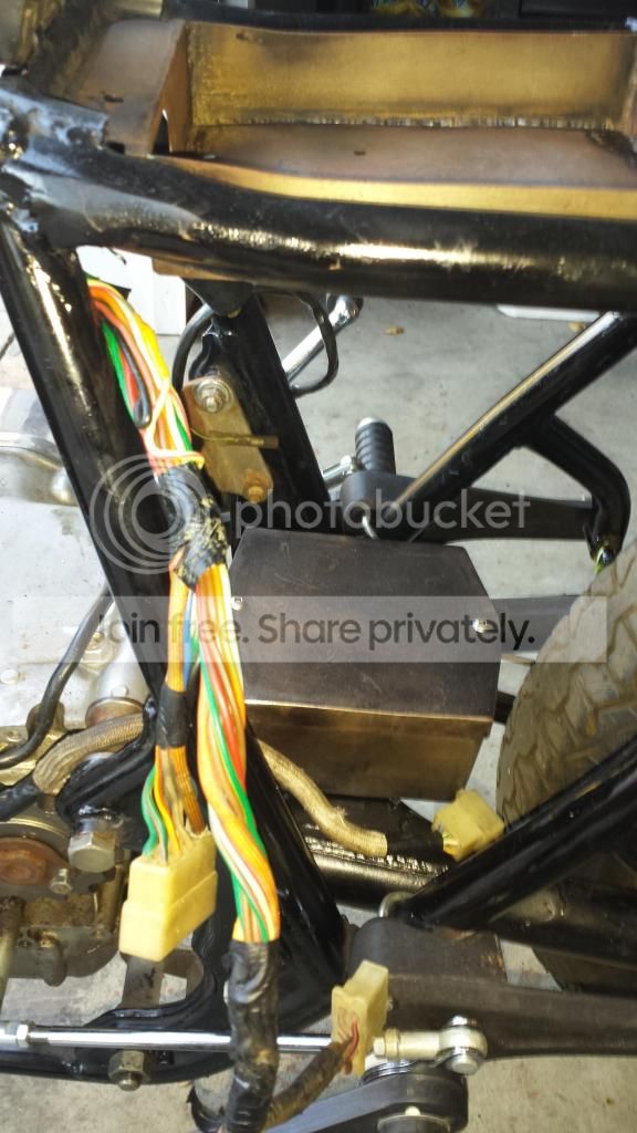

Hey Kevin! Good to see this bike moving forward.
I saw your post about the battery. I didn't make that tray; the frame came to me like that. The small ballistic batteries should work, and I've seen them mounted on the swing arm, etc.

Looks good so far. I love the GS series. Once you get it running be sure to test the charging system, pretty much the only weak point of these engines as far as I know.

Should be easy to fab up some straps out of flat steel that could bolt between the rear frame and the electronics tray. Look at Lowe's for some various sizes of flat stock.

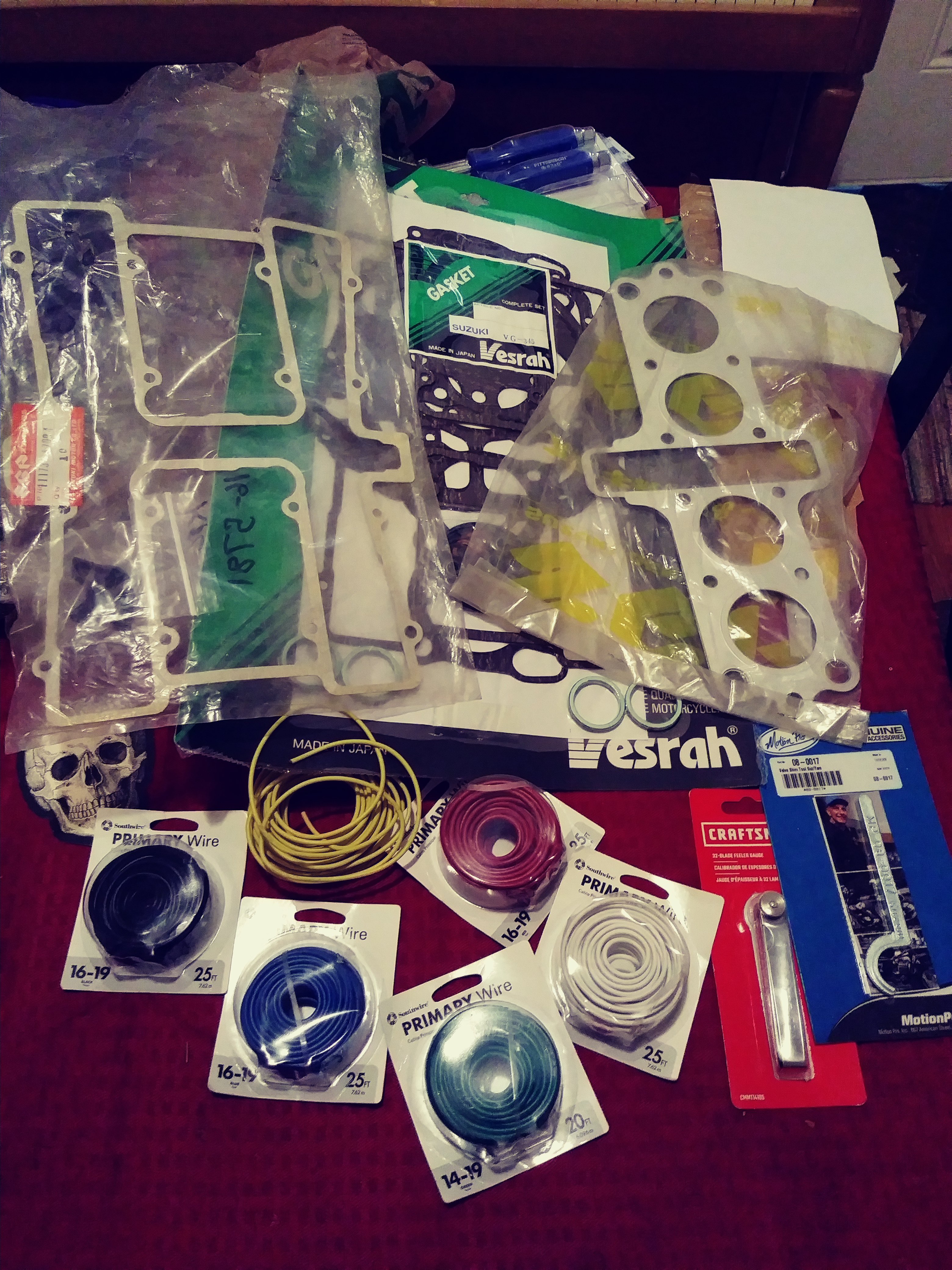

Alright, kids are gone, the lady isn't home... Time to get back into this bike. So I've picked up some wire, I've been reading so much about the wiring and rewiring on these bikes i think I'll just take a stab at rewiring... But that's for later, tonight I'll be getting into the motor and checking the valves, cleaning more and replacing gaskets!!!

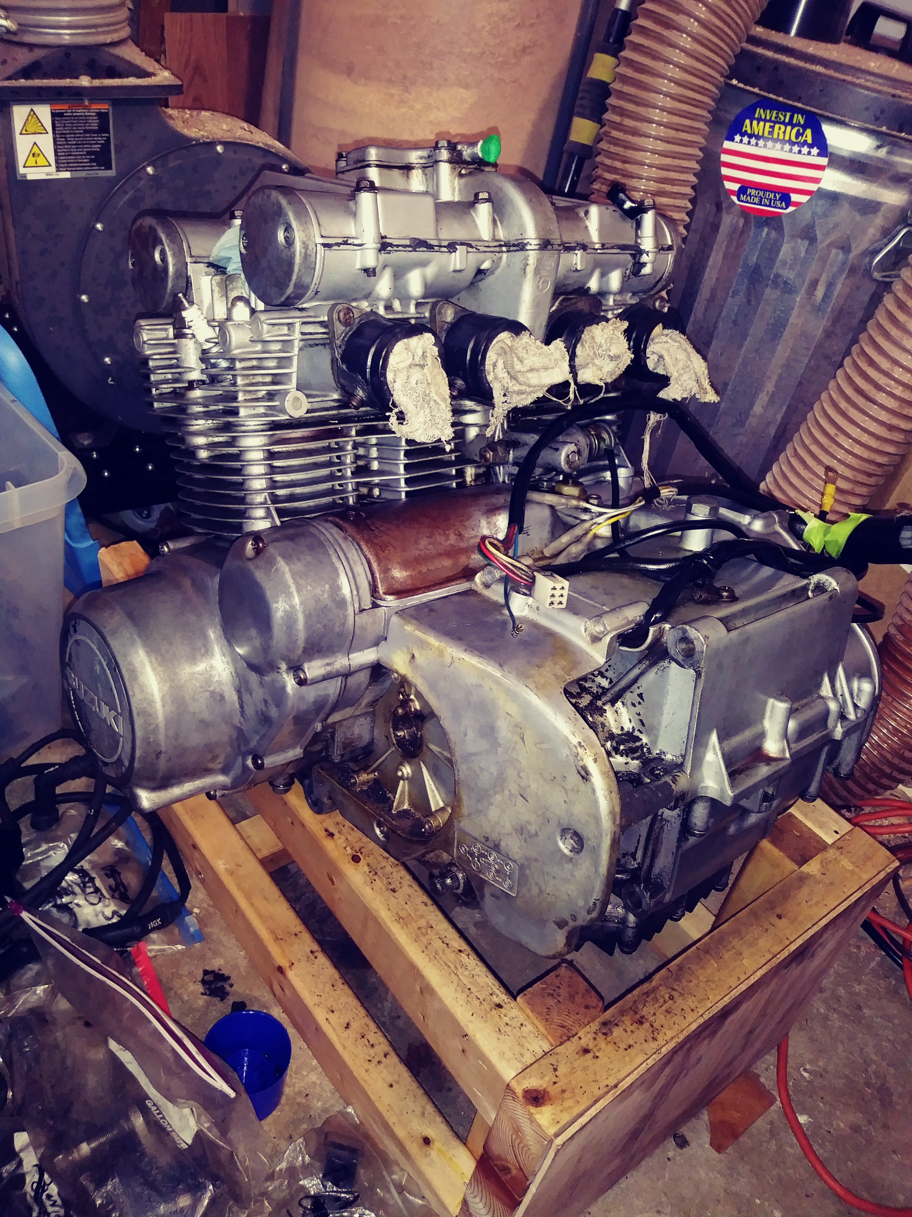

So, sincemy last post I've done A LOT. Motor is rebuilt and painted, and put back in the frame finished the tank, chopped and painted the fenders( the rear still needs a bit more work. New head light, tail light, both with indicators. Chopped the exhaust( still need to weld that up) welded a new battery box. New speedo, still need to get a tach but ran out of money... Fresh carb boots, K&N pods, and dynojet stage 3 kit. New reg/rec, and new battery... Hmmm i feel like I'm forgetting something... Anyway here she is, waiting on some valve shims before i torque everything down, then on to wiring!!! I really wanted an Munit, but again... Ran out of money so that will just have to wait. The whole build is on the GSR forum under my same name if you want to see the progress.
Looks good mate I had a nightmare getting mine running right with those filters on .even with stage 3 kit
Thanks! Don't tell me that lol! I'm having a nightmare trying to get pods that fit!!!! The ones in the picture were too long and hit the frame, i tried grinding them down and they still wanted to pull the carbs off the motor! So i ordered APE, those were too long as well. Then i saw someone said the K&N rc 0884 was the way to go, so i ordered them without hesitation, they came in yesterday and they dont fit my carbs!!! So now I'm looking at the RC 2344, and UNI( though i don't much like the look of them) , those should both theoretically fit... Just have to wait, till they get here, i wish i could start tuning already!!! Where are you located? What did you end up jet and needle wise? I have the DJ 155 main, 3rd clip down from the top, air correctors in, drilled out the needle slide hole, and I'm sitting at 2.5 turns out. She starts up and idles fine with no filters i rubber banded a paper towle over the carbs and took her down the street and rode fine through the gears, i didn't get on it, i just wanted to see if she would run, and she did!
In the end I was 3 and a half turns out on air screw 3rd clip down on needles. 170 on main jets. Sorry for late reply good look with it .and my filters touched the frame too but did fit on carbs ok
