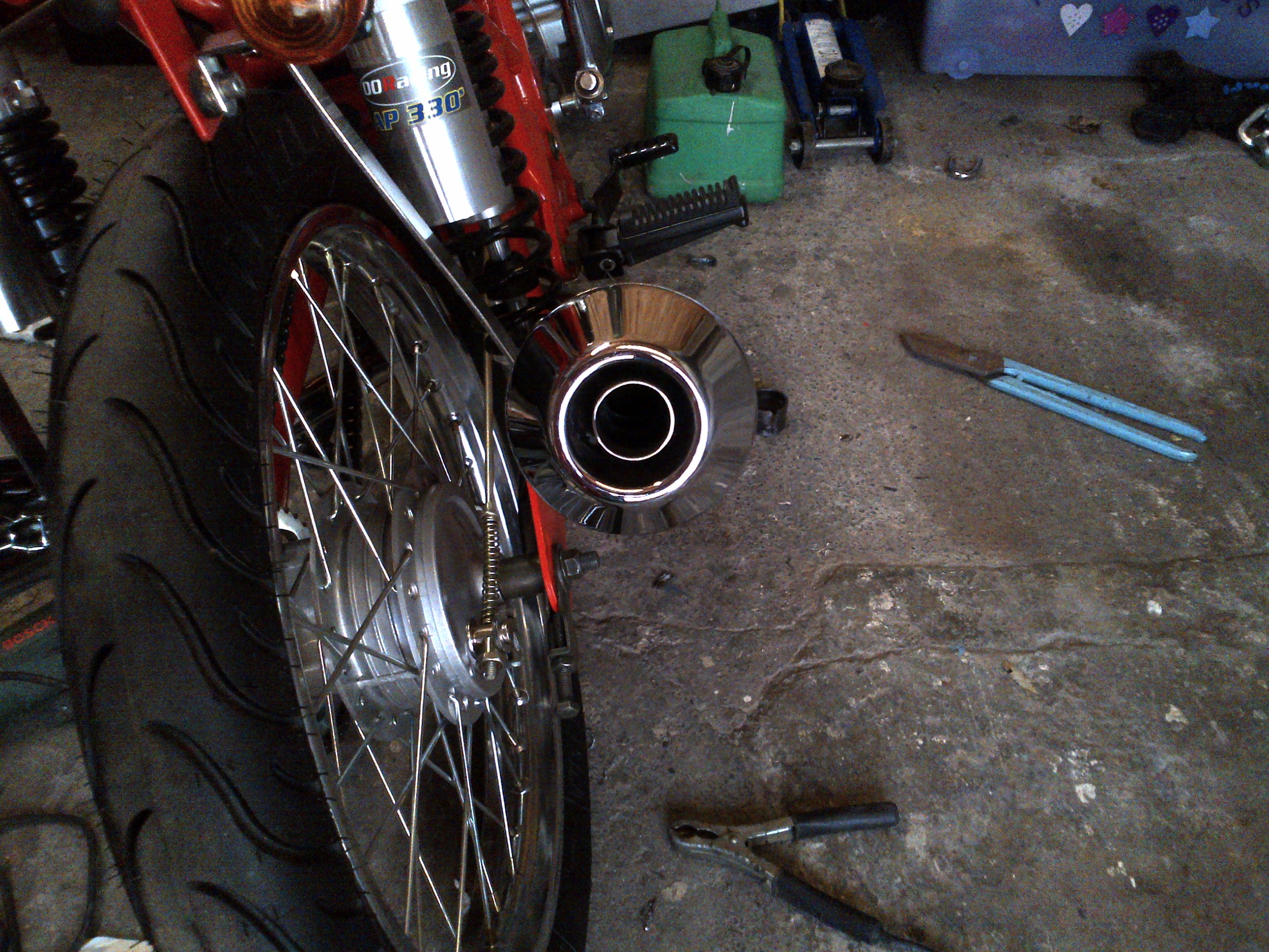

Thanks for this Borrachadog ;D - packed my mega as hard as I could with the new wadding , pop rivetted the plate to the end and fitted it back on the bike . Still as loud and "harsh" as before - not convinced I placed a bit of pipe on the end extending well beyond the reverse cone - relative silence 8) - removed the reverse cone altogether and with my extra plate and reduced dia pipe it was probably as quiet as the original despite being a straight through exhaust - result . So new pipe needed but hopefully that will be it .........thanks again for the insight ;D
Fitted it this morning - much better :) - hard to make out in the pic but a bit of 1" tube did the job .
