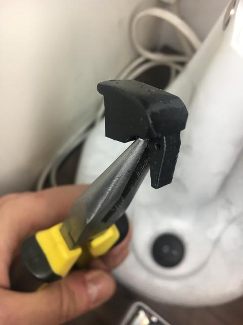

Start-button
As I wrote, I got start-button from a friend.
We scan it to 3D-model and after that printed it.
It came pretty good. Few minor grinding to do, but it works!
Original button
First version
Final version
Need to polish it and its good to go

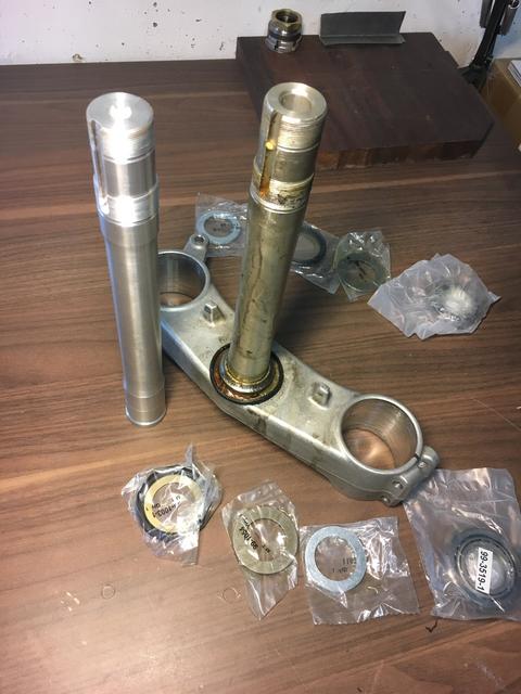

Steeringstem
Way back I ordered steering stem adapter to fit GSXR front end to CB750 frame from Cognitomoto. Like they said, it is bolt-on.
Original GSXR stem in triple tree, next to new stem.
Just press the old one out and new one in
Here you go.
