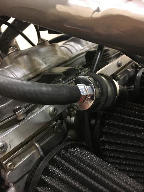

Fuel lines done
Fuel line from the tank -> fuel filter -> carbs.
It was little tricky to figure out where and how to put fuel filter without too much "uphills" and turns to the hose.
I used pipeclamp with rubber insulation to hold fuel filter in its place

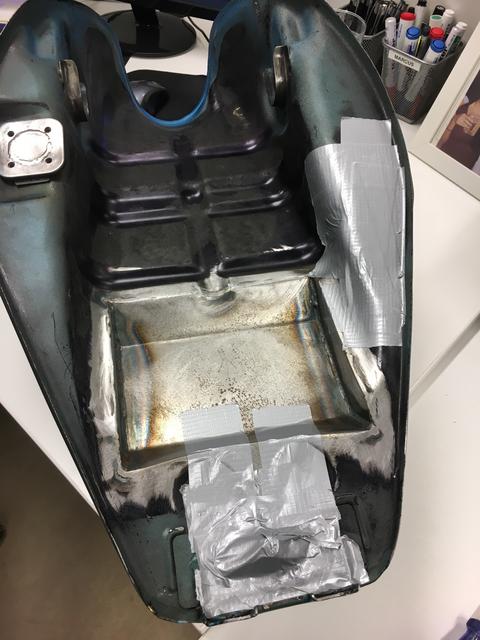

Coating the tank
The fuel tank is old and has little rust inside. When I filled it with water, it was all over rust-colored when I poured it out.
Also you could hear little crumbles rolling around at bottom of the tank.
I bought Por15-kit.
First I have to say you all who are planning to do this: the process is from hell and takes huge amount of your time ;D
First instructions advice you to flush the tank with fresh water to get bigger particles out straight away.
Remove every removable part (petcock, fuelcap etc.)
After that you have to clog all holes excluding filling hole.
First issue comes at this point. As you may know or guessed, these duct tapes doens't hold when you are going to use hot water...
My advice to you is to fabricate pieces from a sheet metal or something that you could bolt tightly to cover holes.

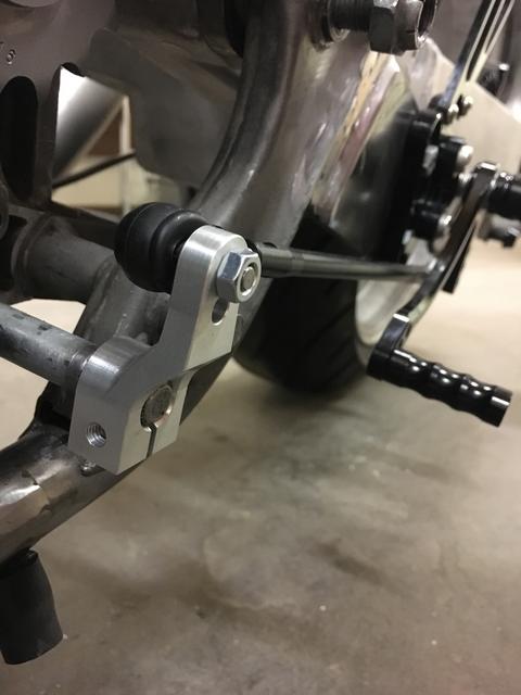

I'm not sure did I post picture of this already, but my friend from the states dropped me cognitomotos gearlever adapter.
In these pics adapter is in wrong way because gear selection order is upsidedown.
