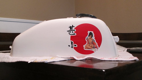

Had a few setbacks with painting the tank and am currently using the roller method as described elswhere on the forum. I have decide to take this bike more to a Brat than anything. Here is a rendering of the tank idea.
The Kanjii says "Very Small" or Midget.

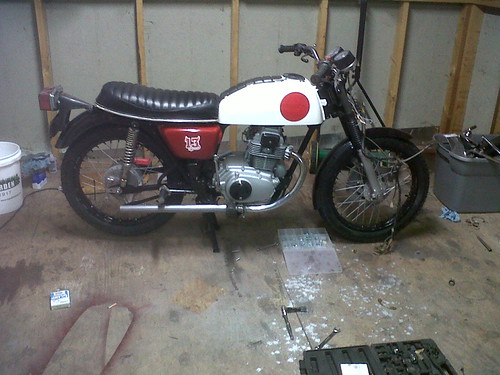

Day Two of Vacation. Not alot done, but trying to take my time and do it right. Spent most of the day trying to decide if the Euro bars were going to work out for me.
midge 040 by Crash13666, on Flickr
Going Foward in Reverse. Had to take it apart to do the wiring. Exhaust, chain and other minor dtails today and it should be done. :)
