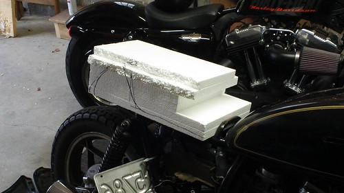

Instead of using the foam blocks mentioned, i used some styrofoam sheets laying around the garage. Worked nicely.

After a couple hours of carving and shaving with some random ass tools, the shape was coming together.

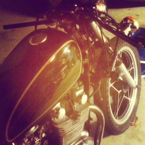

Getting a little side tracked but had to see a quick mock up view. I had a buddy of mine weld a 1 1/2" riser for my gas tank today to level the lines a bit. Used the angle grinder on the front fender to trim it down, then painted it black.
Happy with results

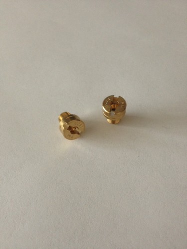

Okay so, i am in the process of taking the carbs off and cleaning them thoroughly. With the purchase of the shorties and pod filters, i felt i would need to rejet. Ordered a pair of 132.5 mains? I am sure someone out there went the route that i am going haha i do feel good about my choice of 132's, but am curious about the response i will get.

I haven't quite started yet but I'm in the process of re-jetting for pods and a free-er flowing exhaust on the same bike.
I was wondering what made you choose 7 sizes up for the main? I'm not saying you've made a mistake or anything I just wondered what steered you to go with 132.5's. I've read a lot of conflicting information for the CV carbs and right now I'm thinking anywhere from 4-8 sizes up for mine should do it.

As for my decision on the jet sizes, i spent alot of time doing research on this subject, looking at the post' here on DTT and also the gsresources (great info. site). I eventually found a thread here on DTT posted by "gk45011" titled "Stuck..please help. carb issue...". http://www.dotheton.com/forum/index.php?topic=43343.0.
They get into deep discussion on proper jetting for the 450, and especially with the pod filters and flowing exhaust mods. I feel pretty confident with this thread and also with my decision on the sizing, now just to see how she performs ;D
Will keep you posted
