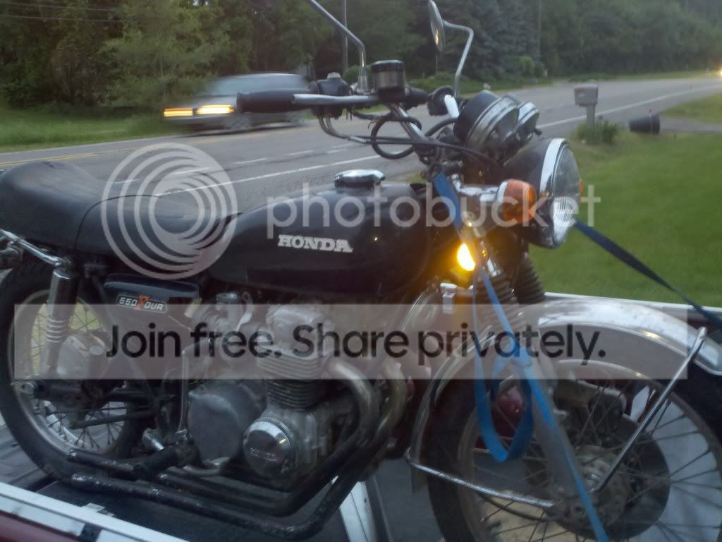

I actually just picked this up yesterday. $250. Everything is there. No rust in the tank in fact only rust on the bike is on the rear spokes. Original title 18k on the clock. Motor is free even has oil in it still. Brand new rear tire. Just needs some general items then itll get chopped up
Nice start!!!, Let me know whebn your ready for rearsets, and a billet upper clamp for it. Ill hook you up!!
