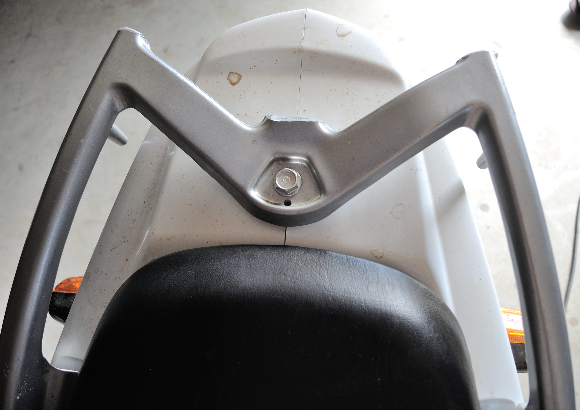

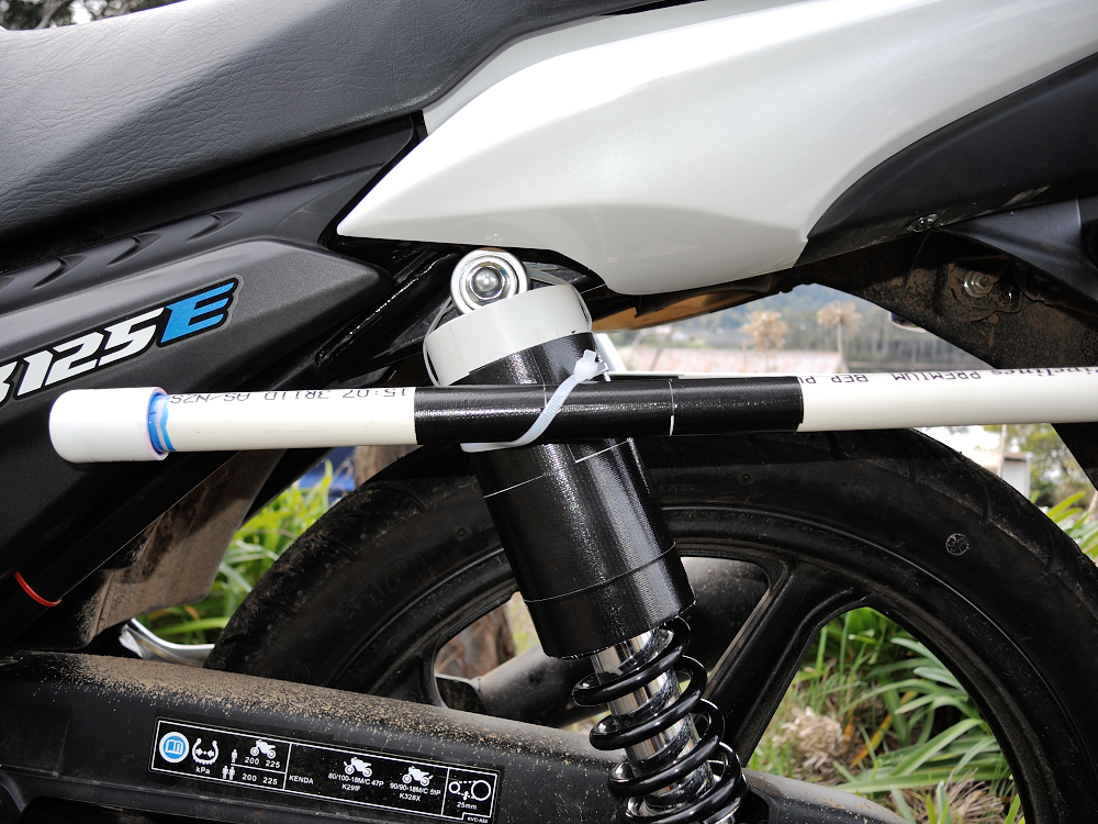

I finally spent some time finishing off the pannier racks. I'm really happy with them. I've had an off road (muddy) ride today and nothing budged.
I've used cloth tape (or hundred mph tape) and zip ties to hold it together. The cloth tape is just to give the zip ties something to grip to.
The rail can be lowered about 4 or 5 inches (both ends) to accommodate deeper bags.

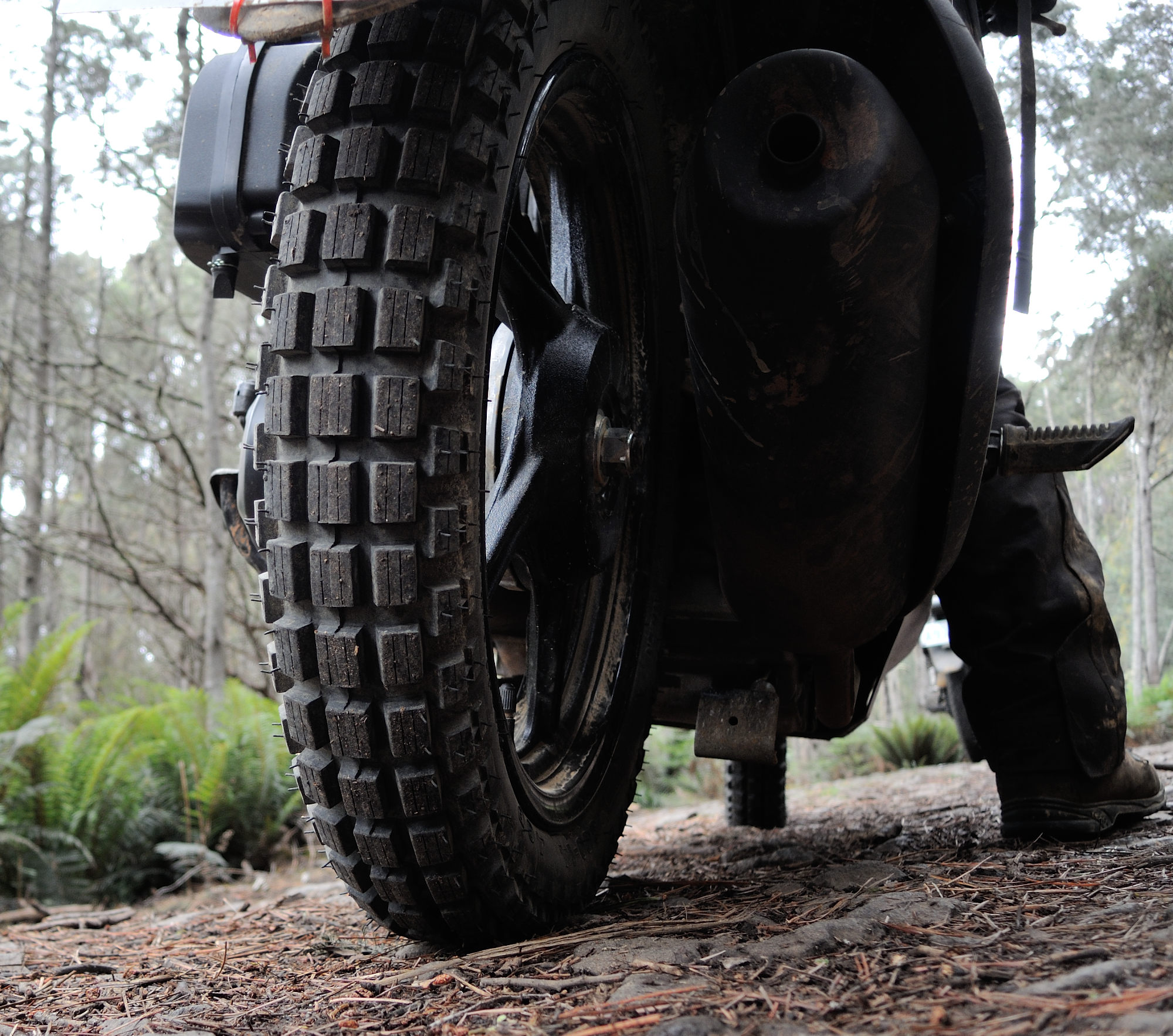

A tyre review. I know these tyres are amazing for this bike, and there aren't a lot of options here in Aus for a 50/50 tyre. So, I'm keeping this thread alive for any fellow cb125e owners looking for info.
I've been using kenda block trails - these are the same as in the picture above of Gail's bike. I think they are the best 50/50 tyre I've used. They are better than the original road tyres on road. I always go edge to edge on or off road, both front and rear. The rear has about 3mm left in the centre and I still roll onto the sides with no drama - I've never had that in the past (they always slid at this point). Although past dual sports I owned were always bigger, heavier and more powerful. Where I live it is rocky or hardpack or loose over hard.
Anyway, I went for a ride yesterday (first time in a month, Winter :( ), and tried out a new action cam. I thought it would make a good tyre review - an objective rather than this subjective review. The roads in the review are tight and twisty. The bike looks fast, but I haven't gone over 80km/ph and generally peg out at 70km/ph. The roads make it look fast - it's where little bikes rule :) Enjoy
https://youtu.be/2JuOq7sGNpE
