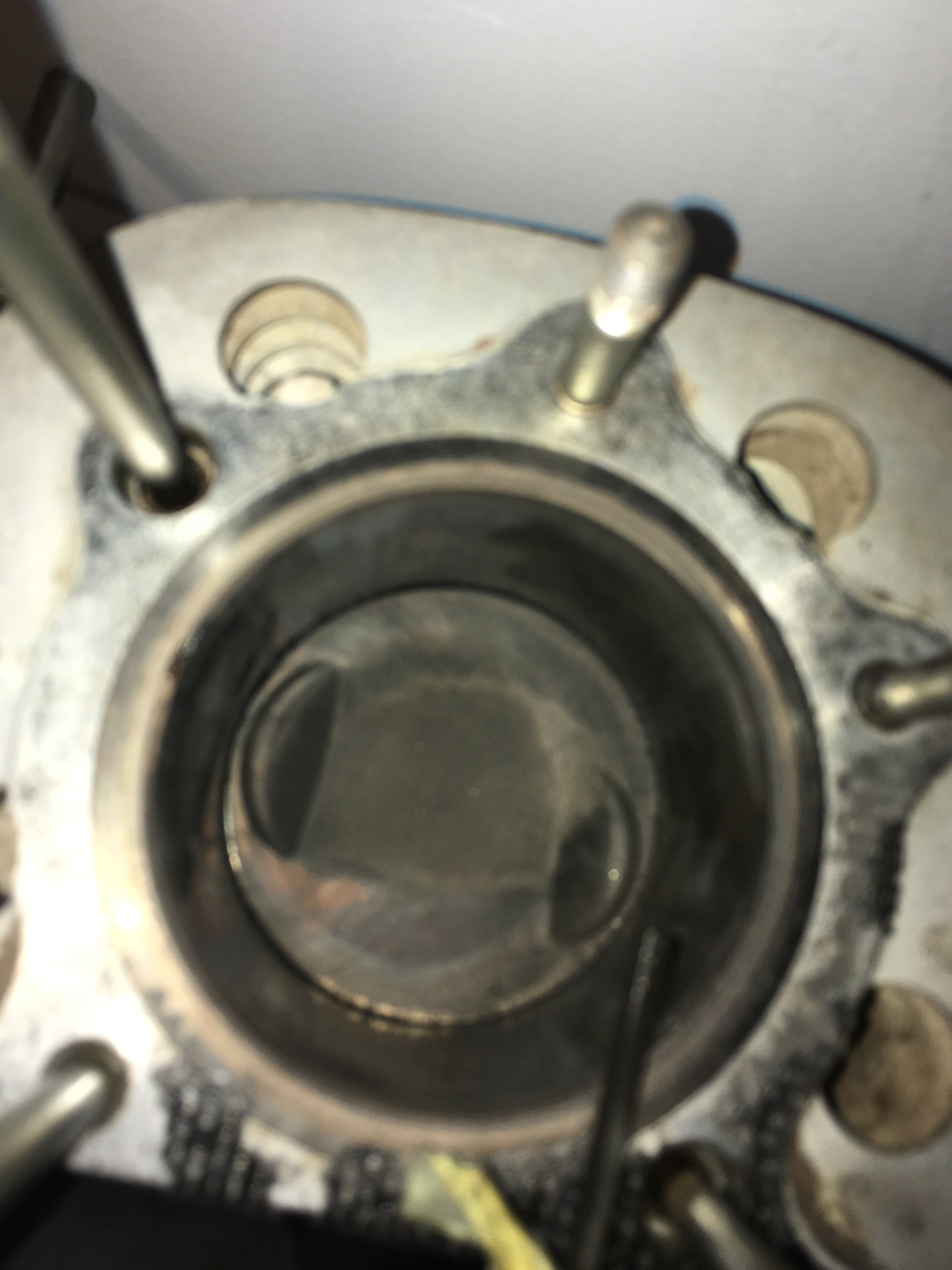

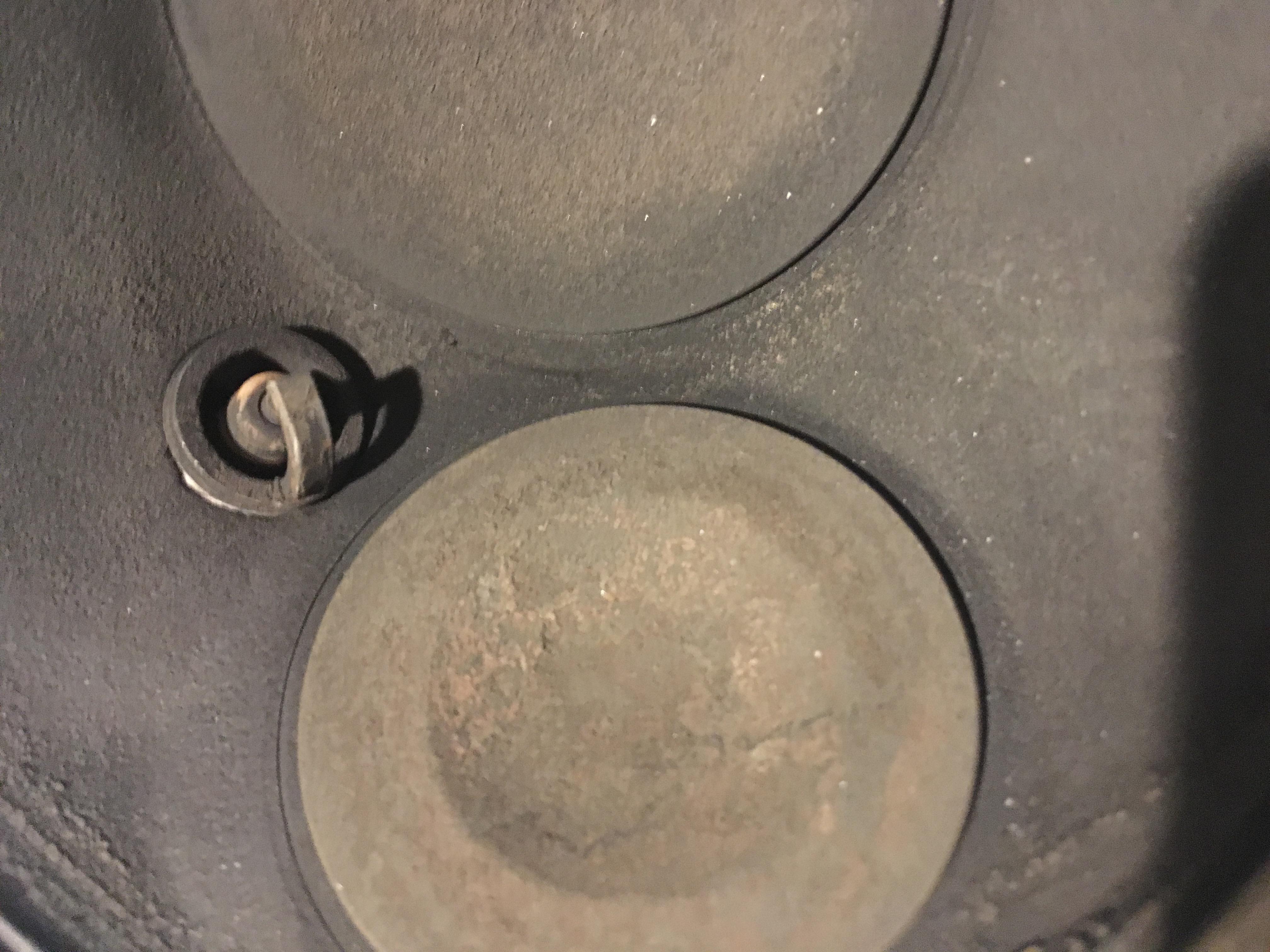

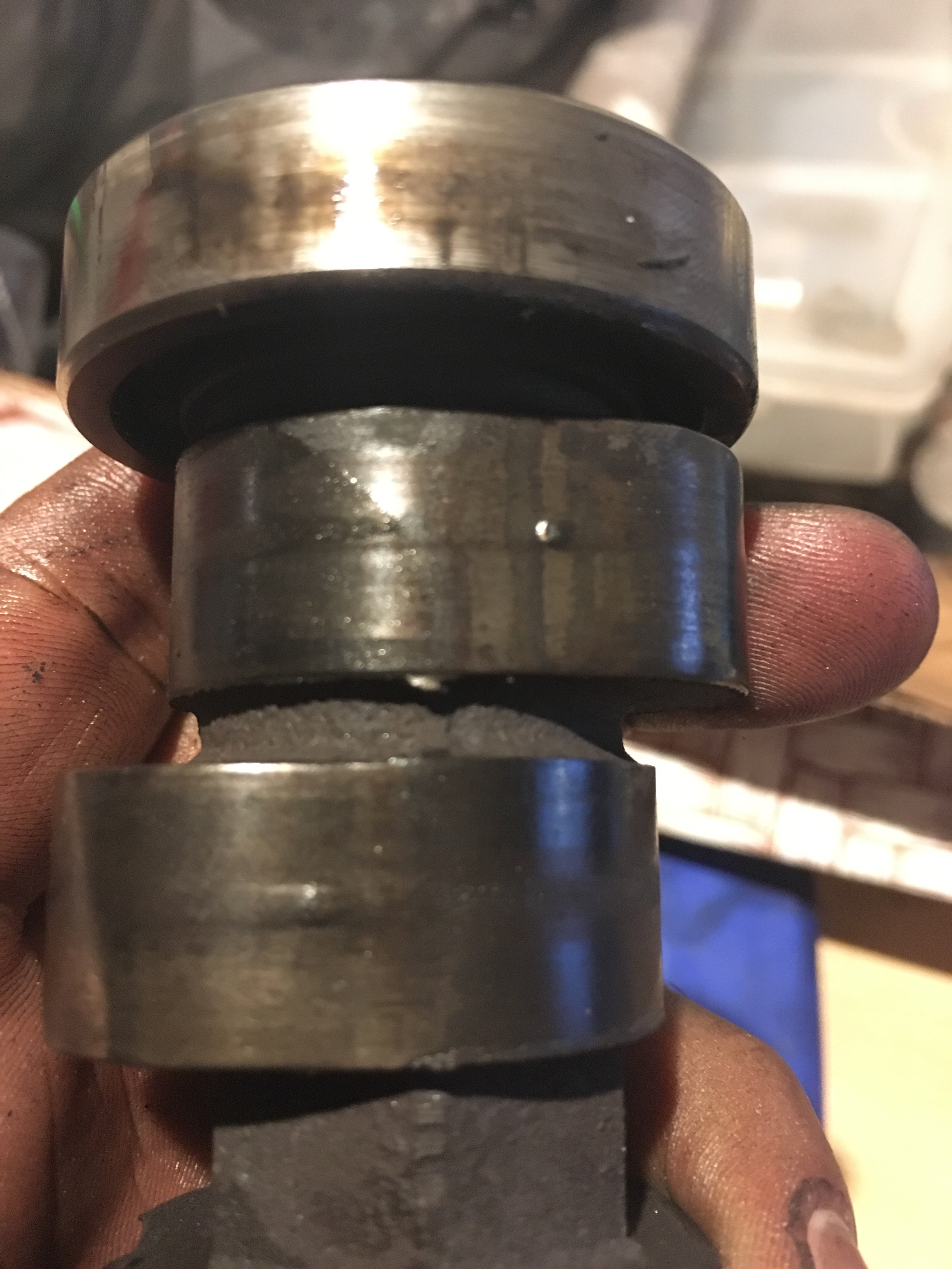

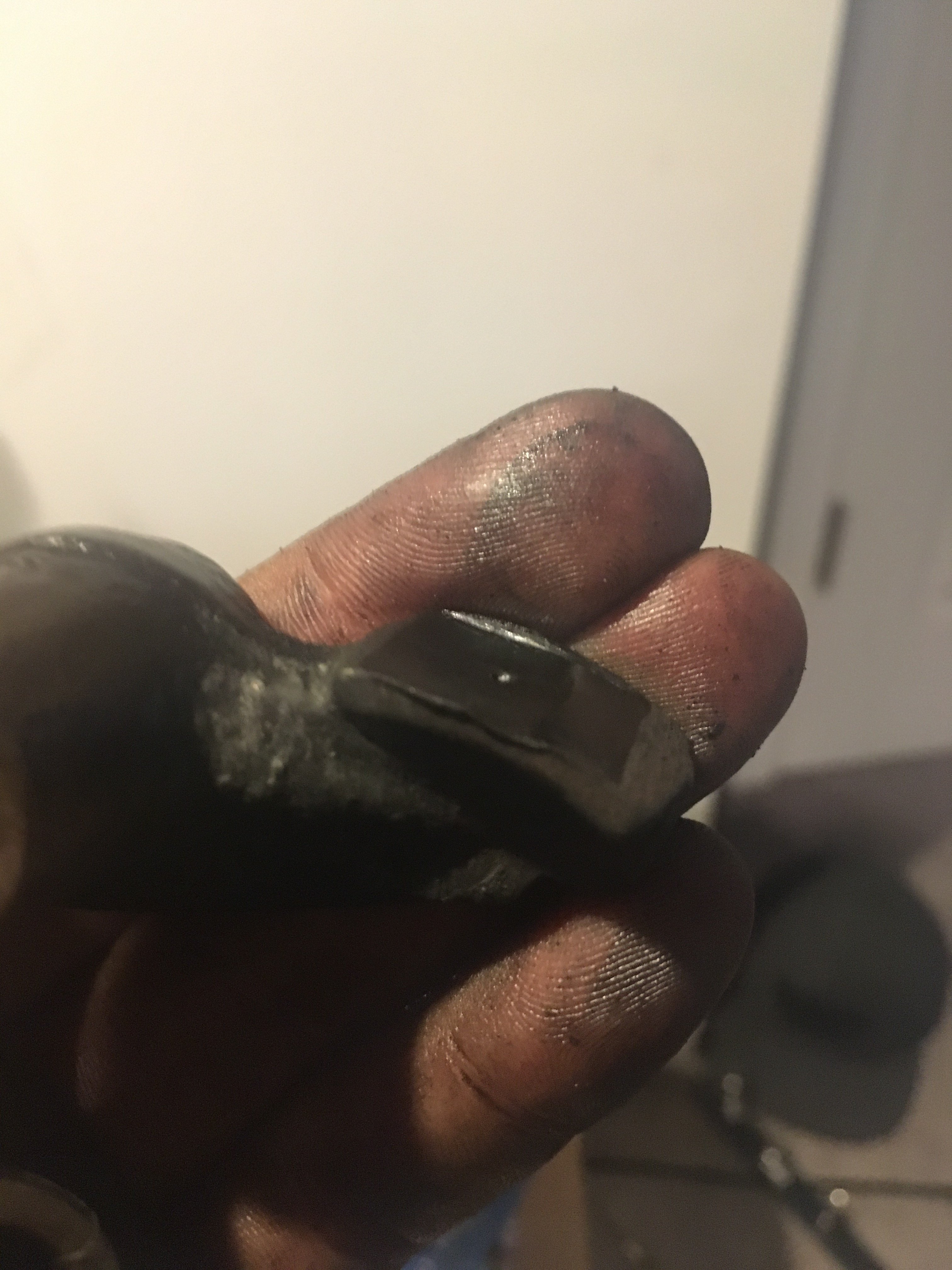

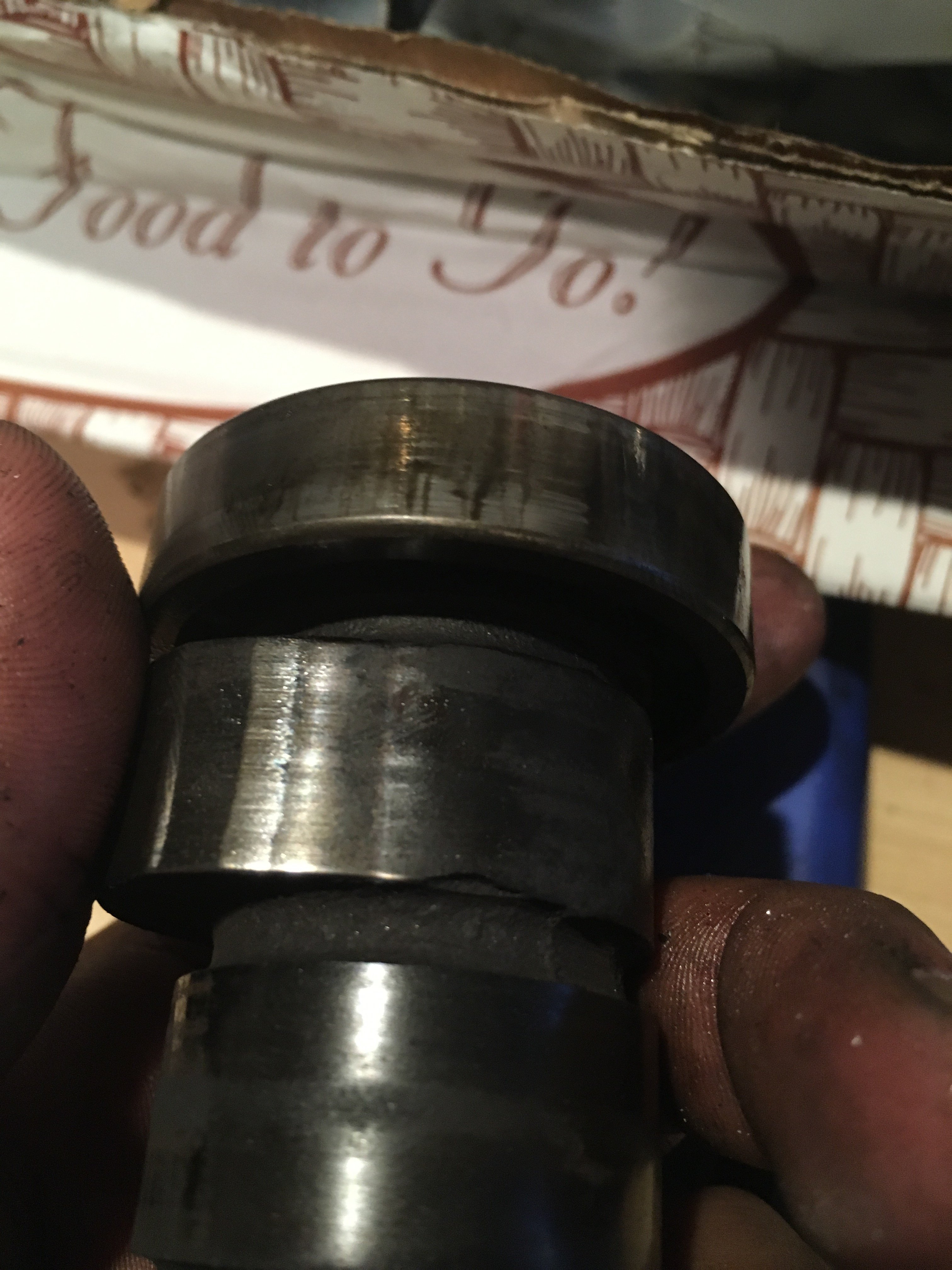

Make sure you tight everything or else... the piston is also melted to the connecting rod -_- who has replacement parts :)

with all the ground up metal that has gone thru the pump back thru the motor
its a lawn ornament or needs more new parts than you can imagine
bet its easy to find a new oil pump ???

I have a dual oil feed to the head, the exhaust banjo bolt backed out I replaced the banjo bolt and crush washer not realizing there were two crush washers, I had an oil leak, then I had no oil, then things melted :(
