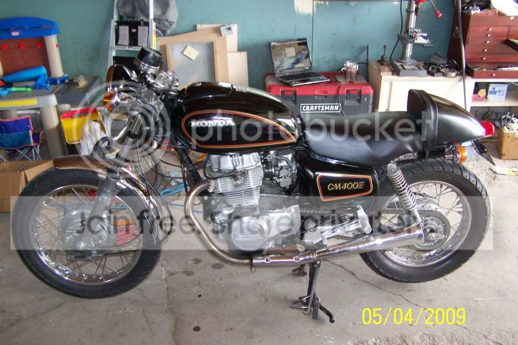

New plate I made up to cover the riser holes and hold the instruments... I think I'm gonna paint the letters, then polish the hell outta the face and clearcoat it..
Man, I didn't realize how close the riding season is... Crap! I gotta get my ass moving!!
As long as I've got her ready by race weekend, I'll be happy... So that gives me a couple months yet to iron out all the bugs... I should look pretty sweet running around at the vintage races on my cafe!

thats awesome!... hell i like the brake lever as well! I think i may use the EDM machine to make a plate as well... i am liking that!
Yeah, that would look pretty damn slick EDM'ing it... Unfortunately we dont have one here, I just milled it out with a .125 dia endmill

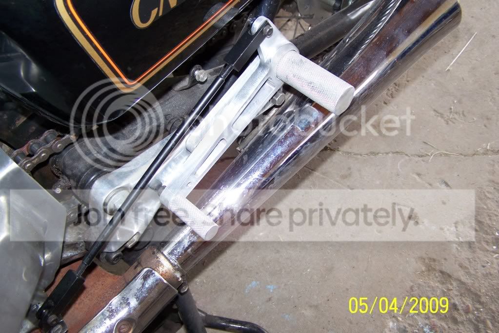

Ok guys... It's been awhile, thought I'd update... I got quite a bit done over the last week..
Machined up some new rearsets....
Chopped the stalks for the turn signals...
Cleaned up the instruments... Ditched the idiot lights and re mounted the speedo
Lookin a lot more streamlined now!
Looks great - not to nitpick, but it looks like the shifter linkage rod could be a spec longer - the shifter and the arm of the footpeg should ideally be parallel to each other, and it looks like you're close to maxing out the threaded adjustable area on the rod.
It also looks like you could use rod-ends instead of the clevis ends you have. Looks like there's enough clearance that you could mount the rod-ends on the inside of the footpeg and shifter mounts, taking them inboard away from pants etc. and just an overal cleaner look.
tHERE'S ACTUALLY QUITE A BIT OF THREAD LEFT INSIDE THE CLEVIS'.... lOTS OF ROOM FOR ADJUSTMENT. i'M PLANNING ON SWITHING TO THE BALL STYLE ROD ENDS AT SOME POINT. THE ONLY REASON i'M USING THE CLEVIS IS JUST THE SIMPLE FACT THAT i WAS ABLE TO MACHINE THEM FROM SCRAP STOCK AT WORK... tHE ONLYT HING i'VE ACTUALLY PAID FOR ON THESE SO FAR IS THE BEARINGS i PUT IN THEM... jUST BEEN KEEPING MY EYE OUT AT WORK FOR SCRAPS THAT i CAN USE... ;)
