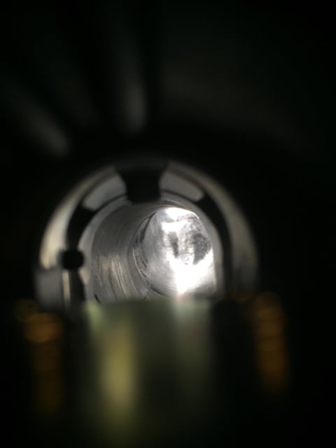

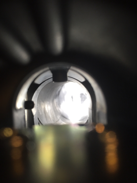

Th se are taken down the throat of carby. Smooth transition through to valve
Light source is through valve opening, no valve fitted to head . It is upside down
That inlet track looks great. Makes you want to remove the biggest restriction left which is the choke flap. Maybe even modify it by using a thinner plate and spot welding it to a thinner pin. Not sure if this is your race setup or for street use?

I would remove choke but it likes choke in the cold . Race and road are the same setup apart from minor jet change due to exhaust baffle fitted for road. Makes only a small difference to horsepower
