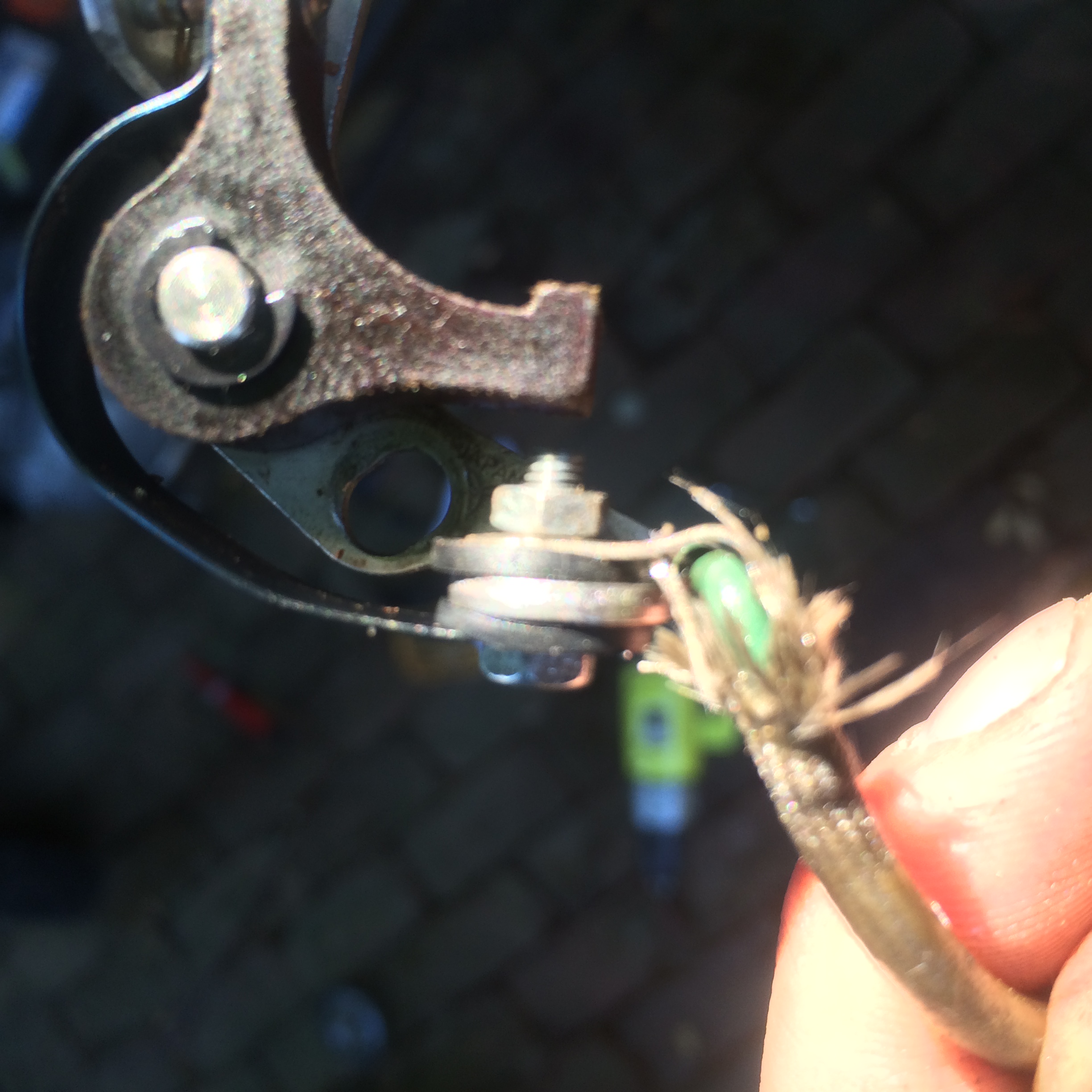

Tonight I went to check the static timing and spark advancer for the tenth time and realize that I was no longer getting power to the point plate. The wire is getting power and the plate is right up until I mount it, then nada.

Sounds like your points wire is grounding out somewhere on the engine case or cover. Make sure the plastic and metal washers are installed in the correct order on the points assembly, there is a very specific way the wire needs to be insulated. When you route the wire, make sure any exposed copper isn't contacting anything it's not supposed to. Make sure y got a gasket on the cover some people use 2 to get some extra clearance for the cover

Sorry adventurco but that may be wrong. His connection and points could be working correctly.
Power takes path of least resistance.
Thus, Oldbikesailor, your findings are correct. As long as your points are closed when the plate is installed on the engine. you WONT read power. On the movable contact or wire.
Turn engine slowly CCW until the points open. Then you will read power again. This is proper operation.
The 6v will take easiest path to ground through the closed points. It wont take the long way through your meter. Once the points open, power must go to ground through the meter...cause it cant go through open points.
After setting static timing are you dialing it in w a strobe light? You must finish timing adjustment w a strobe light.
Unless of course your connection is made wrong as adventurco stated. And the wire is hooked up incorrectly at the movable contact connection and grounding through the points plate. (no power reading on the movable contact w points open or closed).

Yep, then as adventurco said. Check the wire to movable contact connection. its easy to get those tiny insulating washers in wrong. Or your connector is touching the plate.

So you guys were right. The plastic(?) washer had melted and was connecting the plate. I replaced those parts and put it back in and static timed it. Good spark, no start. Pulled the carb and am cleaning that again and rechecking the float height. Jets were clear. Had some backfiring and sputter running but cant get it to idle. Will keep updating as I get progress.
Attached some pictures of the day I got the bike, the bike put together, the melted washer, and the reassebly
