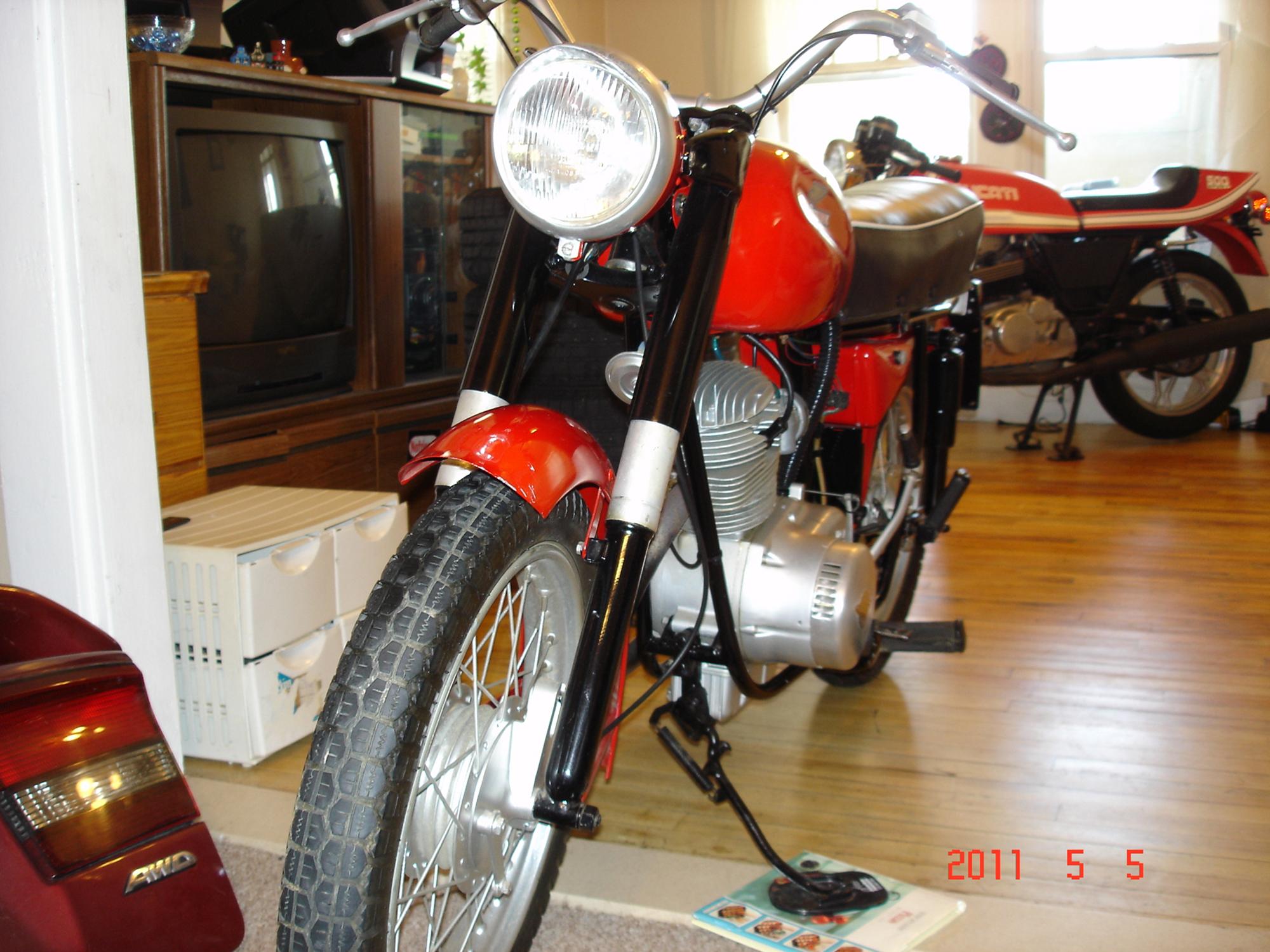

Rossa Corsa Red and Black (maybe a touch of white to break it up).....Is it me or does that Kay look Fast as a Ferrari?
Desmo, you're a bad boy - you have a RED obsession ! ;)
Don't forget the TR1 60's Cafe Racer will be FO Red - with Gold / chrome / polish - ie typical 60's colourways.
