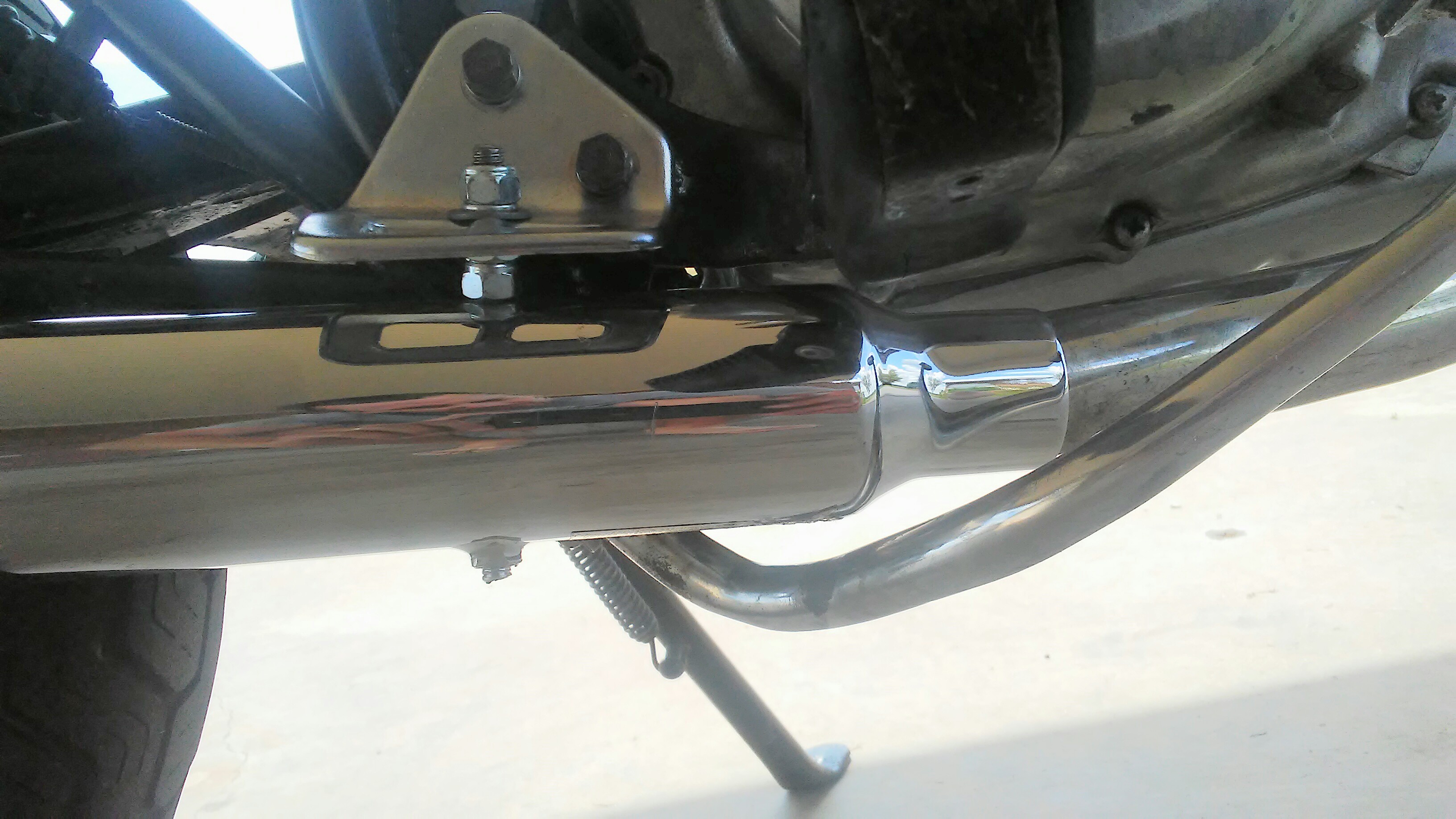

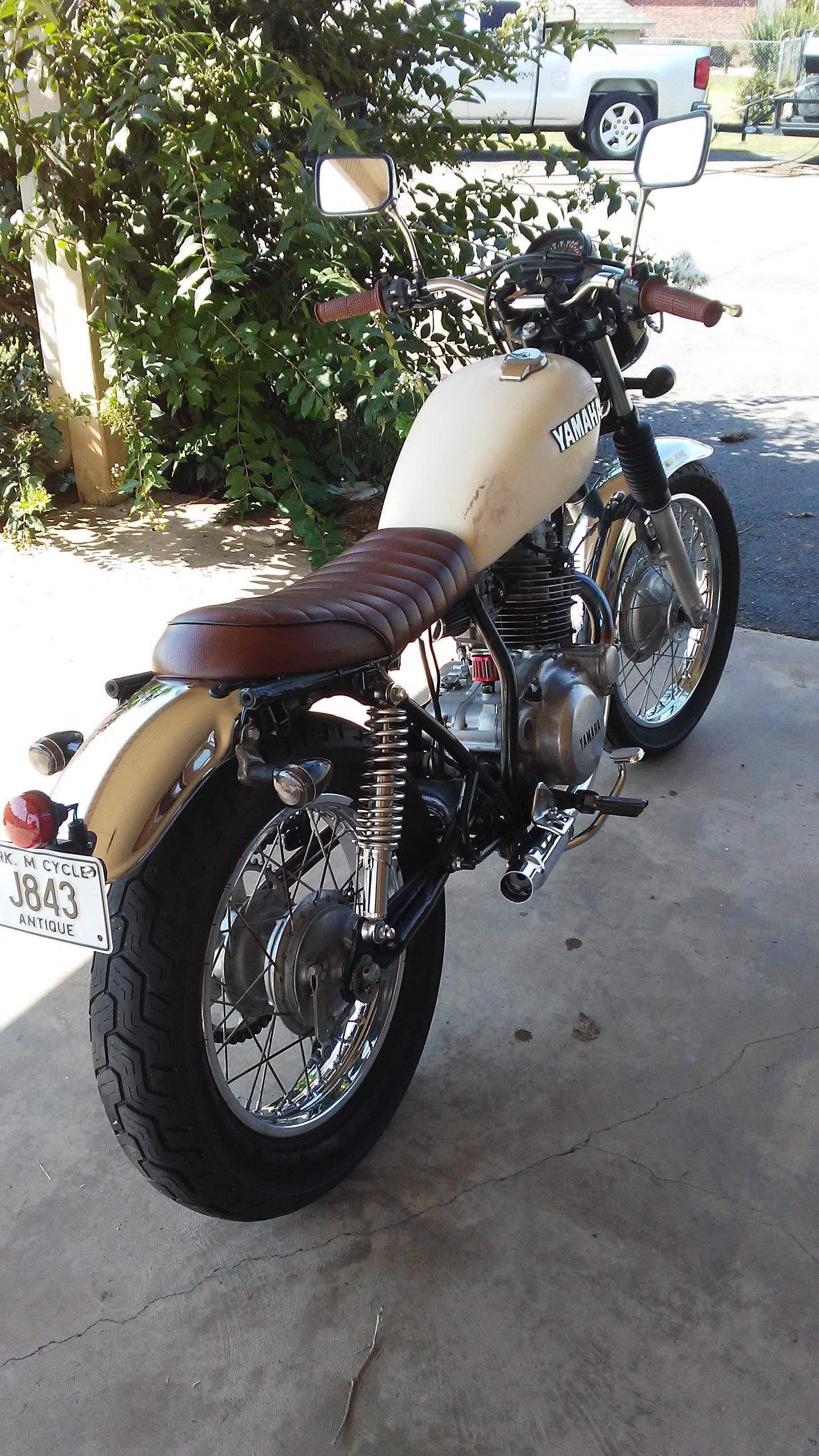

12" Emgo muffler installed. It needs packing. ;D. Very loud. Saddest part is the center stand doesn't work without the stock muffler. Hopefully I can find a way to modify it to work again so I can reinstall it. I found this muffler to be a bit too loud so I installed a washer at the end that has a hole about the same size as the stock muffler had. This quietened it down a bit.

Cool! I'm considering the same muffler for mine. Did you use the stock header pipe and just cut the stock muffler off? If so, did you have any fitment issues other than the centre stand? I'm not planning to use mine anyway....
I would just weld a chunk of steel tube with 1 side cut off, trimmed to fit around the centerstand - so it hits somewhere on the frame as a stop. Maybe drill a hole where it contacts the frame and push in a rubber grommet like they use on OEM seats. A pic of underneath would be good, you may be able to even bolt something on if you don't have access to a welder.
No fitment issues. I cut off the muffler at the end of the header.
I wish I had taken a pic of what was going on underside before removing it. I went to move the bike and the stand pivoted up to the tire acting as a brake! Ill have to do like you said and wield some sort of bump stop.
The muffler has an attachment bolt wielded out the side. I drilled a hole in the foot muffler shield and pushed the bolt through the hole.

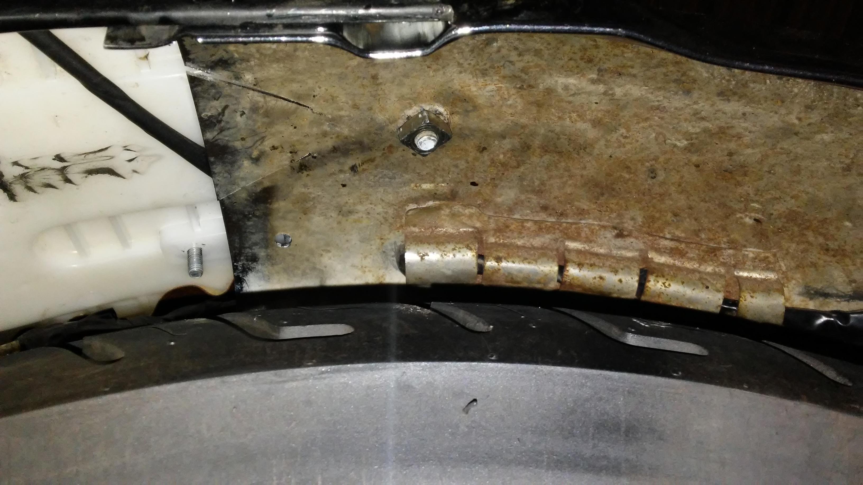

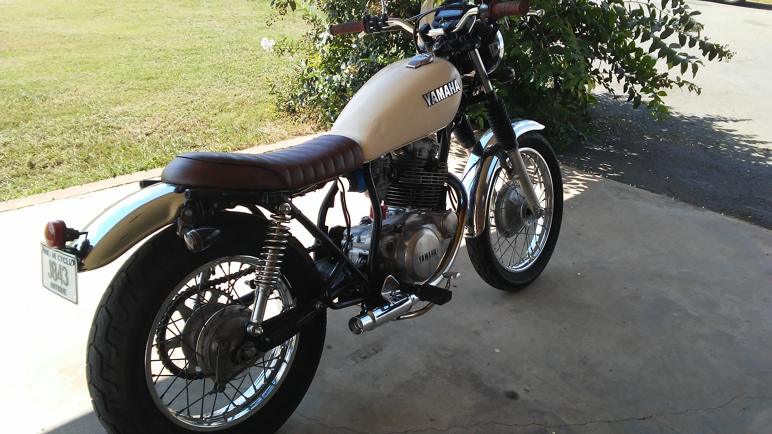

I moved the battery higher to be less visible. This was actually a lot of work. After trying different mirrors and grips I went back with the old.

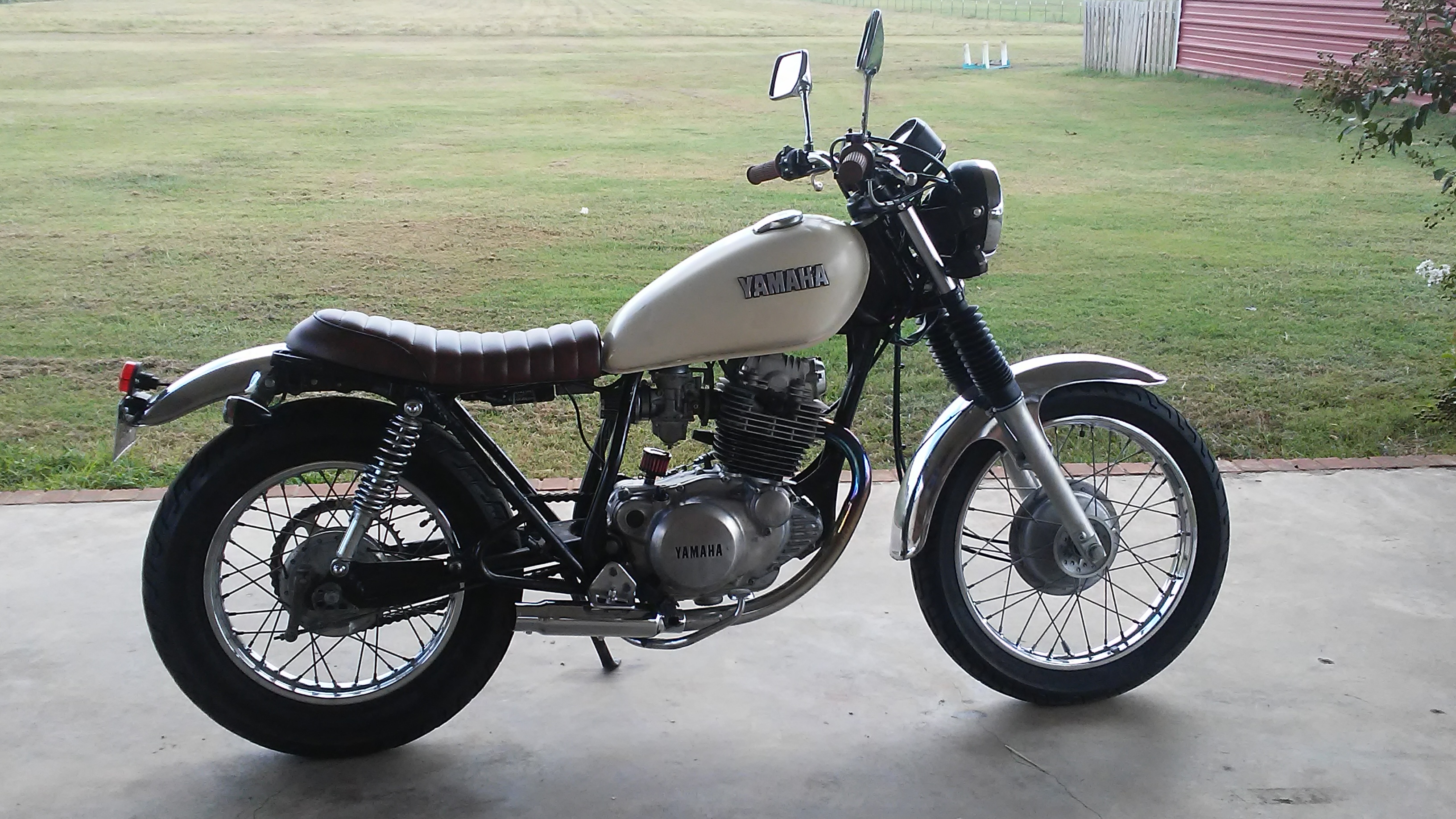

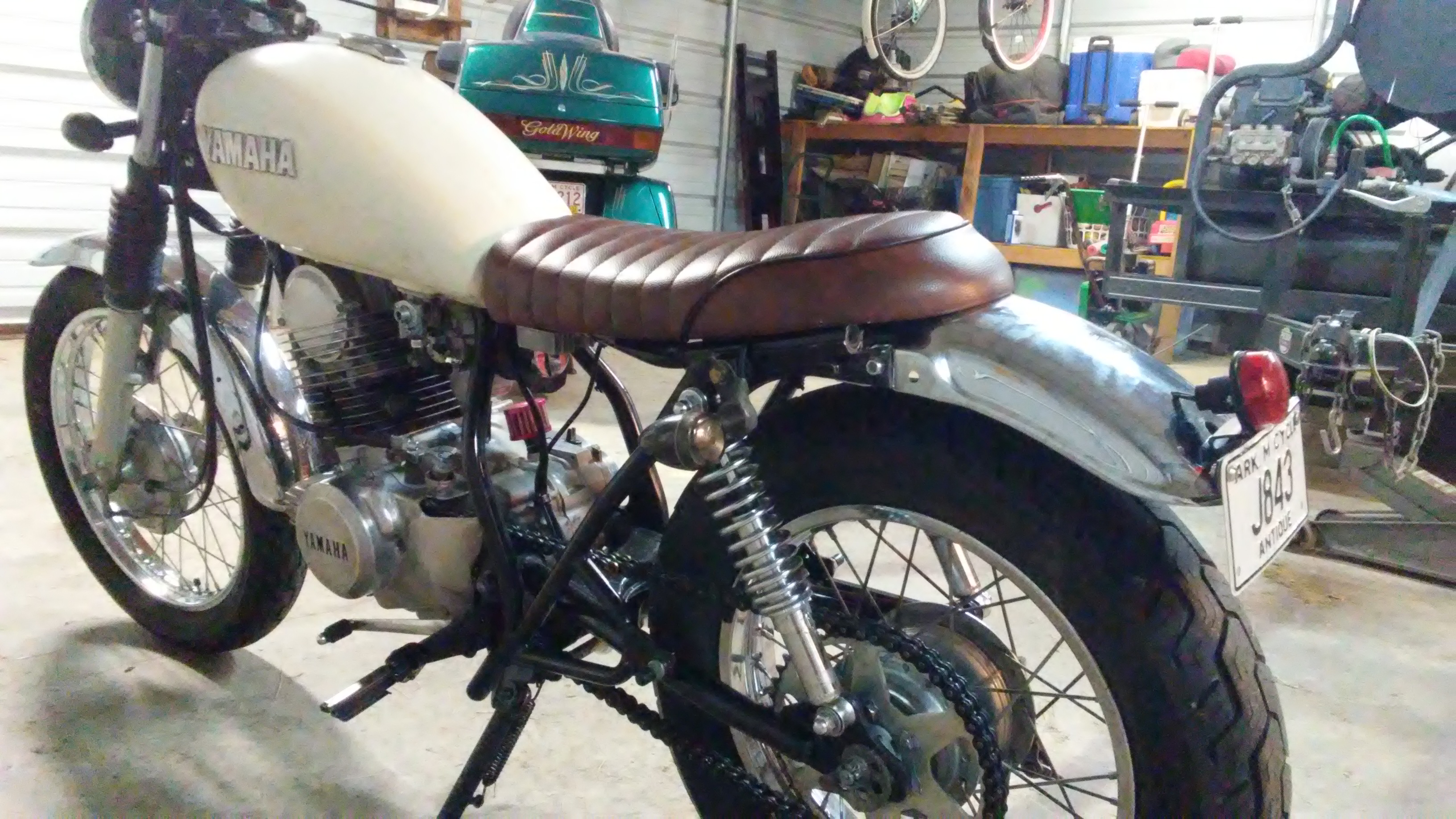

Tonight I trimmed up some of the rear frame cleaning it up a bit. The rear fender is now forward at least 2 inches as well. I had to find a way to attach the seat which was quite a challenge. I ended up pulling back the seat cover and installing a bolt through the pan towards the rear. Then I drilled a hole through the fender for the bolt to go through. One nut and the seat can be removed. I think this looks much better.

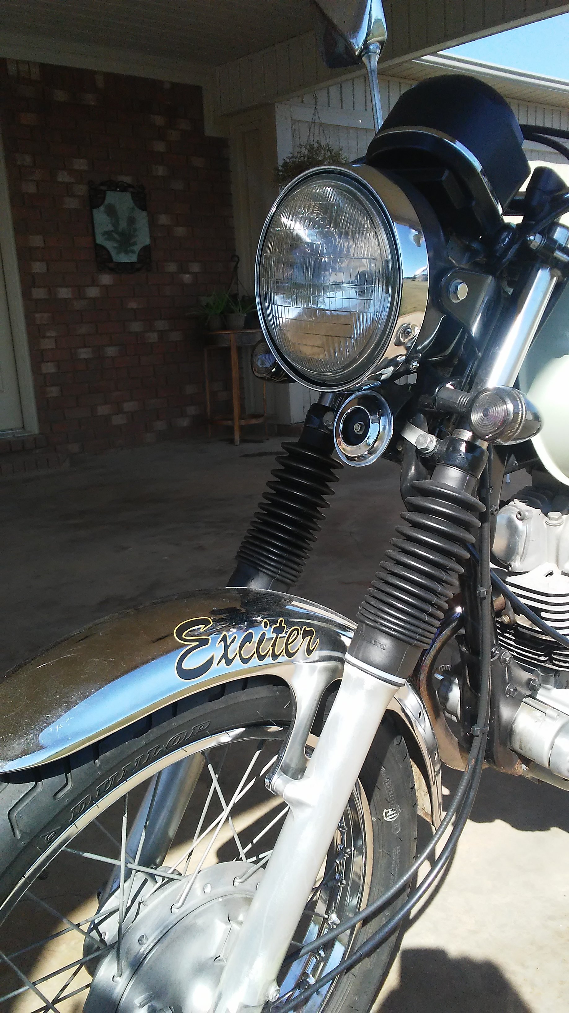

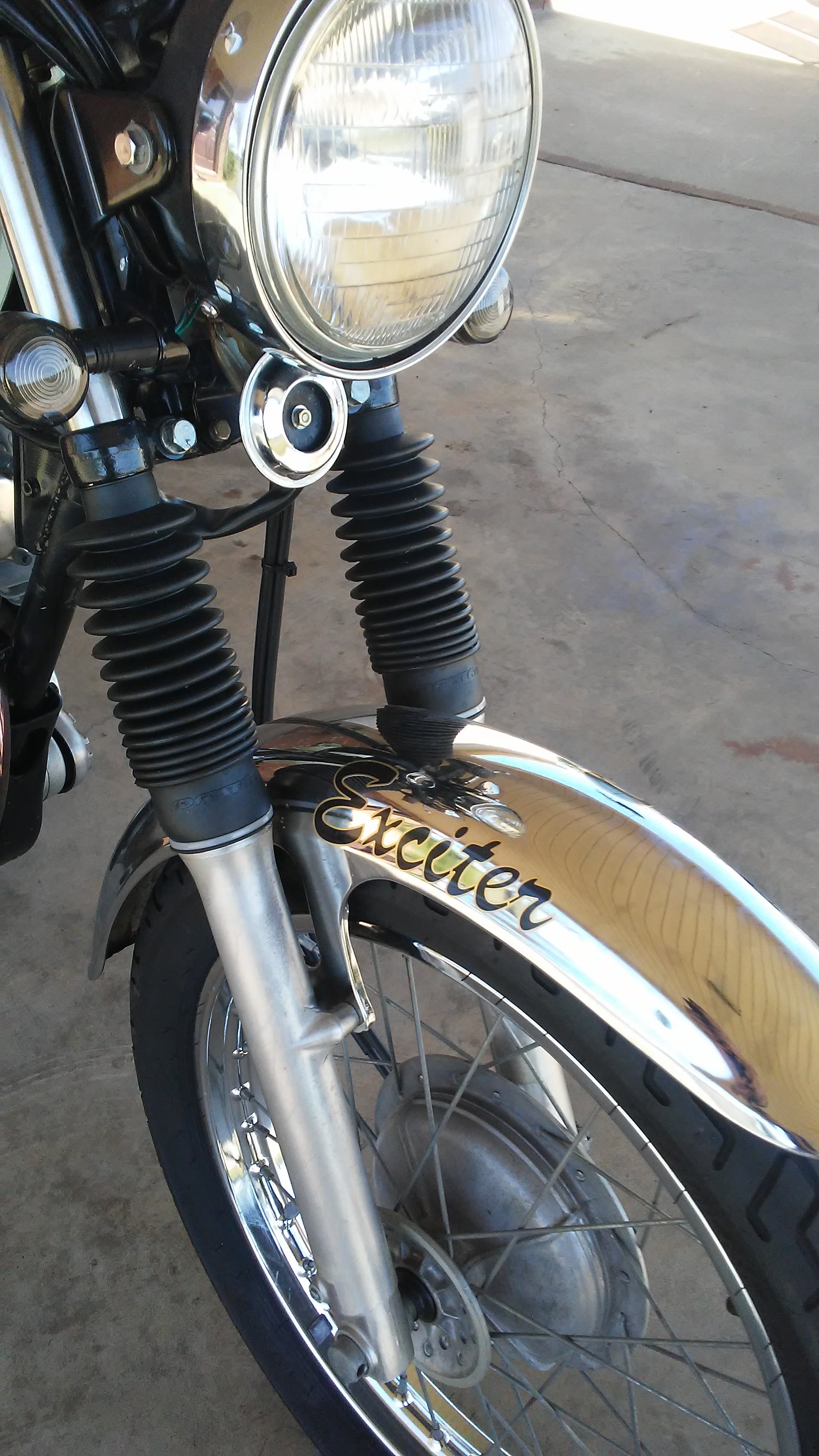

I use an online company for my business and had some Exciter decals made. I originally had these made for the tank but like the emblems better. Here they are on the fender. Ill keep them there a while and see if they grow on me.

The stickers are sweet man. By two pac maybe I meant 2 pack or 2 component. Its stuff they use to paint cars - like epoxy or polyesters, the two parts react together and go off to harden solid. The industry might have shifted to more environmentally friendly alternatives now I am not sure.
