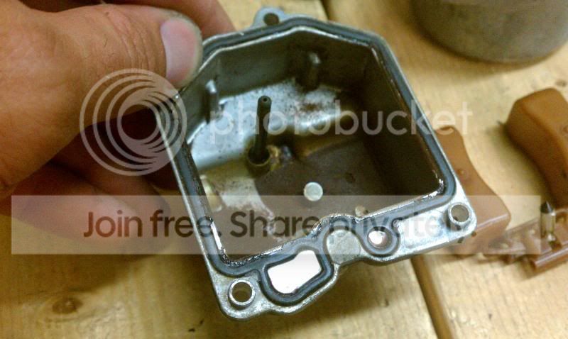

Okay, so first update. I got a bunch of parts taken off the bike to get a good image of the real condition of the bike. A little surface rust here and there on the frame, but overall good shape. The engine appears to be in fairly good condition, but as of yet I haven't had the opportunity to try turning the engine over. Tank, rear fender, carbs, chain, and wiring harness have all been removed. After pulling apart the carbs, I found a bunch of crud in the bowls, and they reek of varnish. As the petcock came off, there was a bunch of red veal in the gas tank. I assumed its rust, but its the same color as the veal in the carbs. I think the first item to purchase is a rear hoop so that I can spend some free time on making a seat, then a new hammer to make knee pockets, and finally a carb rebuild kit. I hope to have this finished and ready as a birthday present to myself as my deadline, which is new years eve. Pics tomorrow!
Get it running first. Also there should not be any veal in your motorcycle, that's gross.
Your tank already has indents at the back - don't waste your time on knee dents.
Just concentrate on trying to get the bike to run.
PS: Did you get a couple of boxes of parts with the bike or is the rolling chassis as per the pics all you got? If not, then you need A LOT of parts before you have a runner.
Welcome! Nice to see another C model make it to the forum.
These guy's are right, at the very minimum pull the spark plugs a add about a teaspoon of oil to the cylinders, then take off the timing cover and put a socket on the crank shaft and try to turn the engine over. Don't want to waste a bunch of time and money on "look pretty" if it is siezed.
Well I already have the bike in my possession and these are all things I can do for free. I haven't been able to locate my socket set small enough to take off any of the covers on the engine, so I just haven't gotten to that yet. The only one I have gotten off so far is the pulse generator cover as it was held on with phillips head screws. Little bit of oil down in the bottom. Harness looks great and unmodified. Until money comes in to rebuild the carbs, I can't put any focus on getting it to run. It also has the issue of only having half a header. So just to get it to run right, I'm out for at least $300.

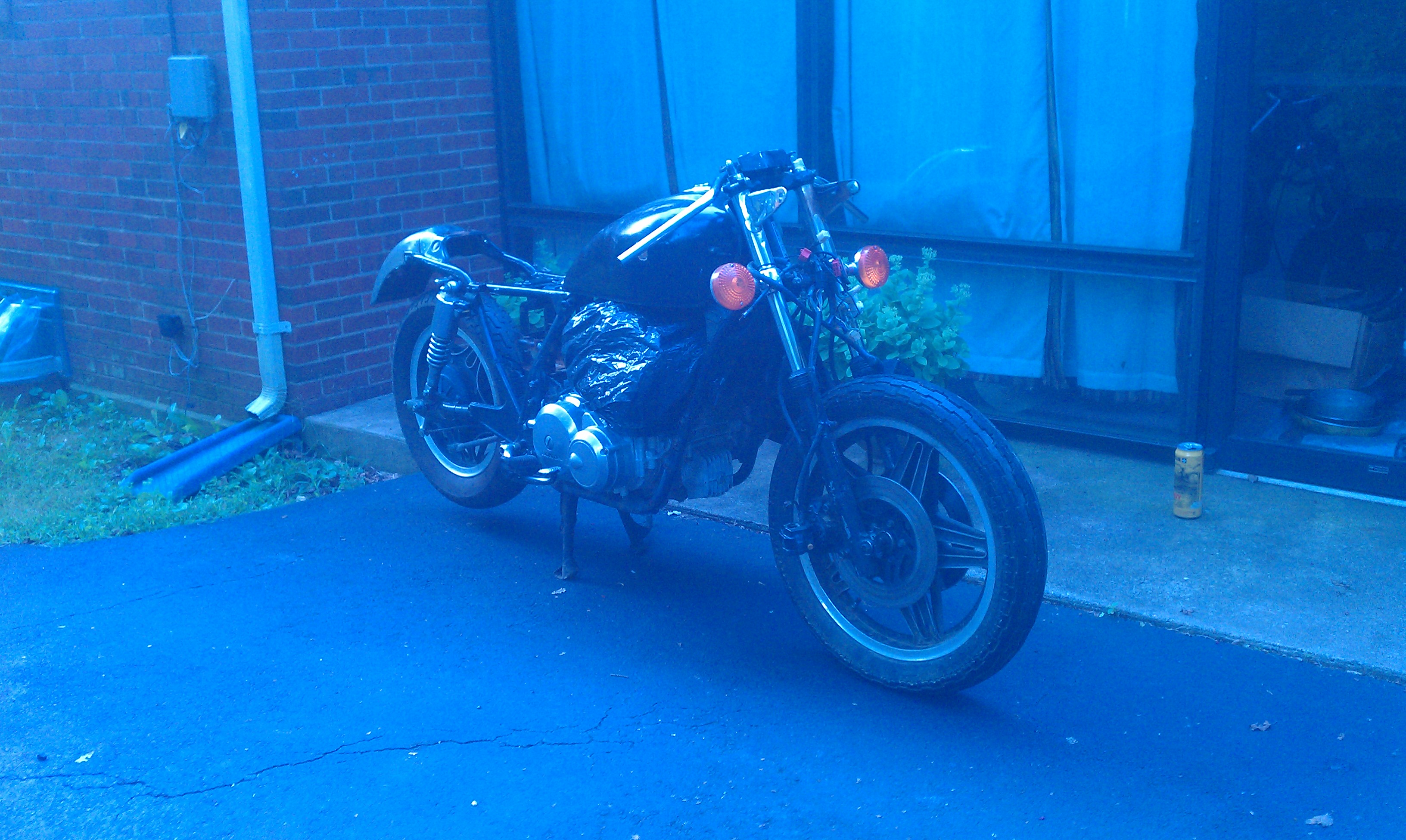

First up, how it sits now

Dirty dirty carbs
The "veal" inside the float bowl

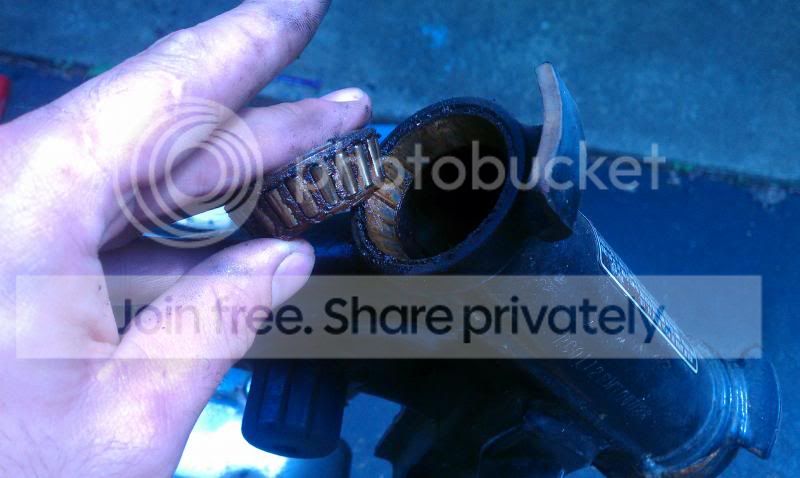

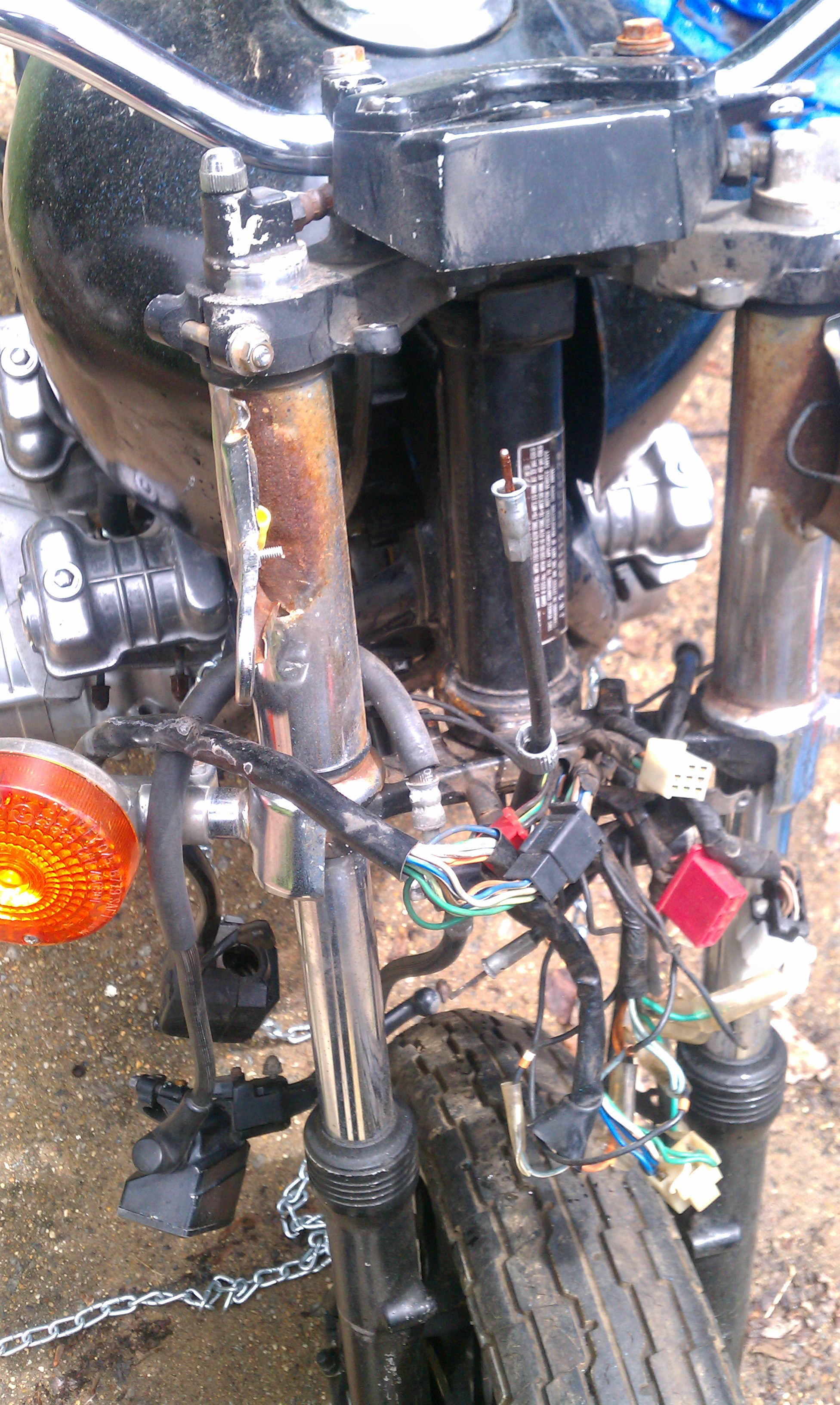

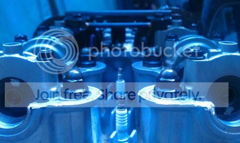

This weekend's update, got some more stuff done. I took the front end off to get the headlight brackets off the fork tubes. To get those off, I had to get off the front brakes and turns out one of the brake calipers was slightly clamped on the rotor, this made pushing the bike around the yard very difficult. Not ever owning a motorcycle before, I assumed that was the norm like "hey, it's just difficult moving these things around." Not the case... While the front wheel was off, I broke the bead and replaced the valve stem, so now both tires hold are. Turns out it's actually pretty easy moving around. Cleaned and regreased the steering stem bearing, and got the valve cover off to get a better idea of the engine condition. Everything looks good up top, but looking at the valve tappet, there were valves open on the engine. I'm taking my smaller ratchet set home today to get the covers off and see if this thing will turn over. I have a sneaking suspicion the cylinder may be rusted out... So... pics for the day.
As she sits now
Looking down the cams
Open valve
Stem bearing
That's all for today!
Shaggydoo
This weekends update, although small is pointing in a good direction. As suggested, I poured a little oil in each cylinder, and had no trouble spinning the engine at all! Seeing the engine and rotor in reasonably good condition make me think that there might not be anything troublesome other than the gummy carbs. Wish me luck!
