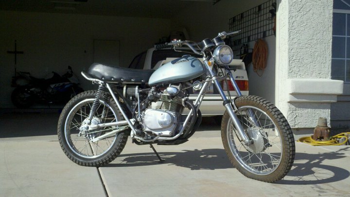

Hi guys, My name is Tyler... I'm an automotive technician for ford at the moment although most of my experience is in the euro world of BMW and Porsche. I've just purchased my first bike which isn't what i was originally looking at getting but i do think it will be a great first bike and first build. Its a 1971 Honda sl175. I've been wanting to build a BMW r75/5 for a long time but cant find one in my budget. so far im into my sl $300, so i think i did alright considering I bought it from the original owners son who was also my service writer at ford, and it only has a little over 1000 miles on it. but i wanted to see if anyone out there and I'm sure there is, but if someone out there knows anything about these bikes and where i can find some good parts and what all i can do to it, that is without breaking the bank.
I guess I should show you all what I'm working with, so here she is

What I'd suggest first is gathering up some 'inspirational' pics of what you want it to look like.
I think it's awesome now, but that's because I have a cafe racer already and am working on more of an 'enduro' / board track/flat track inspired SR500 currently.
It's a great bike for a cafe racer - swap out the tank and seat, put some clubmans on and some fresh street rubber and you're 90% of the way there!
Yeah so far I removed the fenders, I've been looking at allot of pics of other cb and cl 175's not to many sl's that actually have been converted. I have a good friend who is building a cb360 right now and he already had a few suggestions. His build is turning out amazing so i may be taking some of his ideas. I think the one thing I'm having trouble with so far is figuring out what stuff will fit on my SL. My brother has been riding for a few years now and has a bmw s1000rr which is an awesome bike which he wont let me touch lol. But i do have a wrecked r6 that has some good stuff on it. I was looking at taking the forks off and seeing is they might be able to be modified to fit or vise verse. either way I haven't done much research. any help with sites for cool stuff or ideas would be much appreciated

I also have an SL175. Really neat bikes. The frame really lends itself to the cafe style being all tube construction.
A couple things you'll want to do right away:
1. Get a CB or CL 175 front end (fork legs and 18" wheel at least). The SL forks can be used, but are a bit long. You can internally shorten them to save some money though. The SL wheel is too big for a good handling road bike.
2. Get yourself some shorter (and better, old Honda shocks blow) rear shocks.
3. Find an early CL175 tank. They look terrific. Its just my opinion, but the SL tank (though really cool) is too short and bulbous for a "cafe" bike.
Other than that, its all personal preference.
Keep us posted man! You'll have a blast with her Im sure. Theyre really fun little bikes.
sweet! thanks for the advise. my buddy with the cb360 used cbr600 forks for his build so he said i could have his old forks from his bike if I wanted them. Would they fit though?. and would you say to keep the drum brakes or go disc?
The 360s arent a direct bolt on. The easiest way to do it is to do a bearing swap. The best way is to have a good fab guy swap the steering stem from the 175 trees into the 360 trees. Than they'll bolt right up. If you do that though, you'll have a front tire thats as wide as your rear. You could use a CL175 wheel, but youll have to get new spacers made, and do a wheel bearing swap to use the 360 axle.
Honestly, a 360 front end would be rad. A definite upgrade from the little 31mm forks on the SL.
For the 175 Id keep the drums. They (in my opinion) look better and if in good shape, perform fine for a sub 300lb bike that tops out at 80mph.
