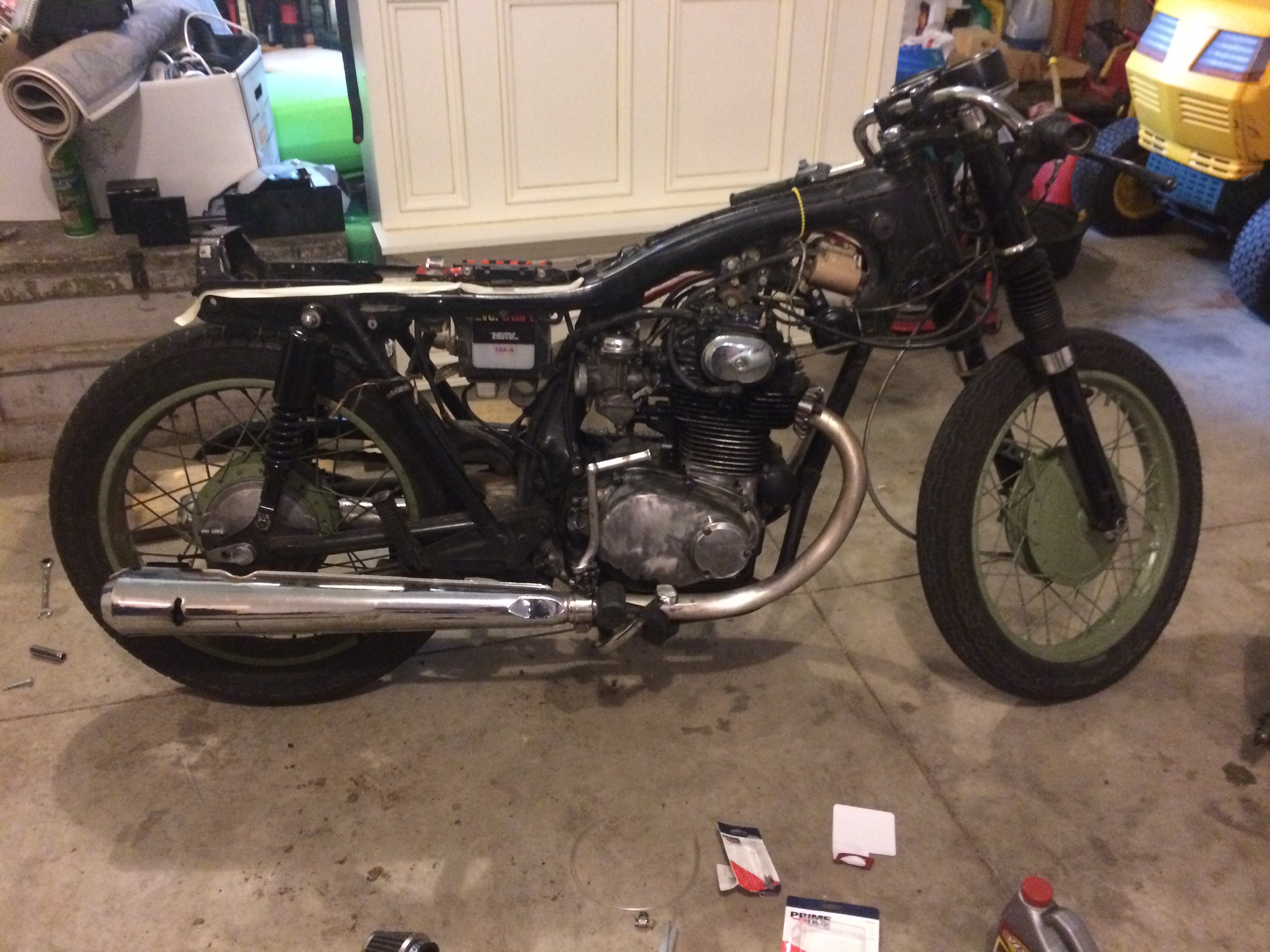

Anyway here is what I am working with.

except for the horrible clubman's, that is a great looking lil 350
if you go bratarded just try not to make the same fail 99% of the bratarders do by putting a flat seat base down on the frame so it slams into the rear tire
you would be far better off just getting a stock seat anyway
I haven't read everything here yet, but did read enough to suggest you leave the whole kick-only / simplify wiring (the electric start only consists of a couple of wires, so don't associate the two changes) until the very end. Get the bike running perfectly, handling properly (steering bearings, swingarm bushings, rebuild front suspension, buy new rear shocks, tires), STOPPING well (new brake pads, braided lines, new caliper piston seals)...
Your front forks are not braced - you can't just remove the front fender. You need the U shaped thick metal bracket the fender is riveted to. It locks the fork lowers together so they travel at the same time. The mounts where the axle clamps down WILL flex under load. Best case, you have less than great handling in corners. Worst case, one of the axle clamps snaps and your front wheel bounces off your face.
Get it running, safe, handling well - then worry about stuff like the 5 pounds you'll save by removing the electric starter. You still need your battery, e-start or not. A smaller one perhaps, but Shorai and other lithium-iron motorcycle battery suppliers have solved that problem - a lot easier to replace your battery and keep your e-start if all you want is a smaller battery. You'll get the weight savings too.
Once you get all that nailed down, sort out
The picture above was how I got the bike. I just started working on it. It's good to know that the forks aren't braced, I knew something looked a little funny up front. I also don't think that I will put rear sets on it right now, I can always add those later. As far as the club mans....yeah I don't like them either and would prefer clip ons or drag bars. The bikes runs well and handles well, just needs the tank cleaned and a new right muffler which I found on eBay super cheap :). It just had a rust hole coming from the heat shield.

You're gonna need some form of fork brace for safety's sake, especially if you're gonna be carting around 100lbs of precious cargo on the back. It's easy enough to find a cheap stock fender. Just cut it down to the length you want and maybe spray paint it.

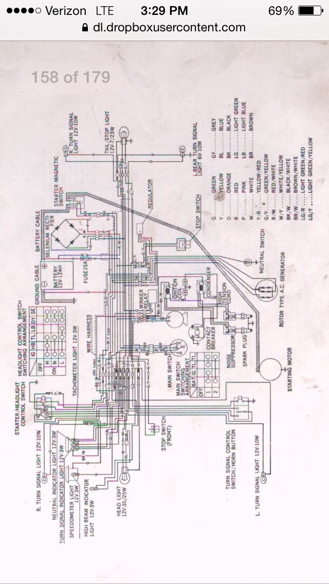

My wiring turned out to not want to work with me at all. It's frayed in some places from the previous owners, there are wires that should be hot and don't come up as ground or hot to my multimeter. Looks like I will be spending time rerunning wires using the stock harness. This is my build nightmare as I am not good with wiring at all. I have entertained the thought of a simple wiring harness but I'm not sure how that would work.
If the picture comes out...that's what I'm looking at for wiring on the front. The lights that are supposed to be for the headlight and blinkers currently have no voltage through them at all. The white wire that is supposed to supply the power for the light leads to a yellow wire when it gets to the forks....then disappears back into the harness. Its becoming a pain to try to sort out this harness even with two diagrams. Ah well, slow and steady.

as far as the wiring there is a fella here sparck moto who will make you a custom simplified wiring harness
