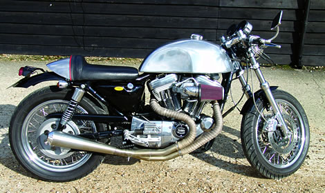

Here are some more H-D's to give you an idea of what you can do. I have a ton more saved on my PC since I am hoping to get an XL883 (cheaper insurance! lol) to cafe. I can always do the 1200 engine upgrade later.
Oh, and I only included NON-peanut tank cafes for your viewing pleasure.
Even though I warned you in my PM, I'm going to do it on here as well for all those thinking to follow a similar route as you. MOST "cafe racer" Harley-Davidsons that you find out there have "flat tracker" seats and bars. Yet many still call them "cafe". To many they are so similar in style that they are the same, but to purists out there they are vastly different. So just make sure that you have a clear idea of what style you want and call it as such.
