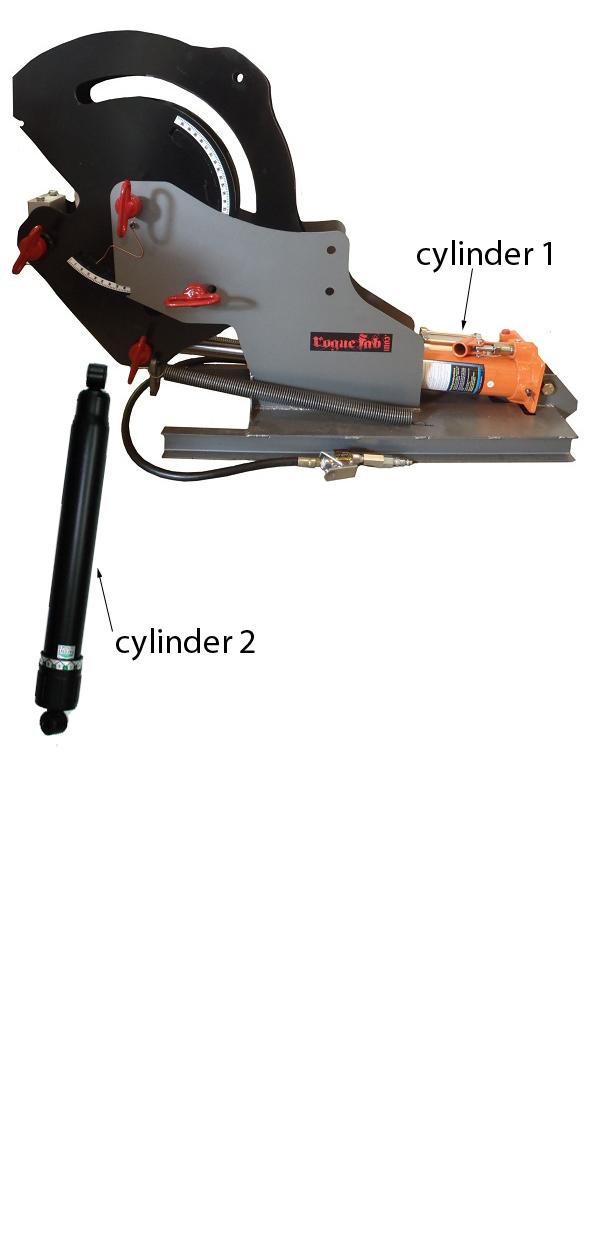

That's what makes the Hossfeld benders so good I guess, minus the fact that their manual. Have you seen the Rogue tubing bender? It'll at least get you to 90 degrees. They have a second pin mount that pushes it the final 90. What I wonder though... what if you take their design but install a second cylinder at 90 from the first cylinder, then when the first cylinder fully extends, you pull the pin from cylinder 1, pin the second cylinder and complete the cycle. Also, it looks like your running a one way cylinder. If you go with two way cylinders, then you can cycle them closed without having to push them in manually.
Here's a quick and crappy photoshop rendering of what I'm talking about with a pic of the Rogue bender:
