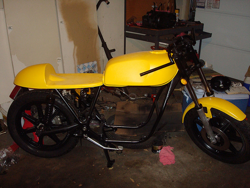

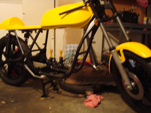

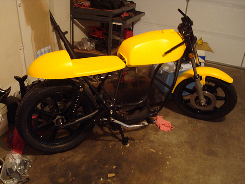

yeah, the shocks eye bushings are a bit bigger than the mounting studs. I will have to fit some sort of sleeve to take up the room. Prob go to autozone or something, no big deal. I saw your posts and replied on the triples site. Your bike is going to be pretty colorful! I will def remember to install the engine from the left. Whenever that may be, I need to split the cases and will prob end up doing a complete rebuild and powdercoat. I wish I could post pics directly on the forums, but my camera is hd or something and every pic it takes is like, almost 2mb and I dont know how to compress them. I was able to put them on flickr, so if you click the link, you could see all the pics I took. Sorry, I hate clicking on links too.

Wow thats bright, looks like you did a great job on the paint! Are you going to break it up with some stripes or anything?
I don't know about a stripe yet, I think it will be broken up enough onnce I get the seat pad/cover. But I think I will be painting the gas cap black to break up the gas tank a little

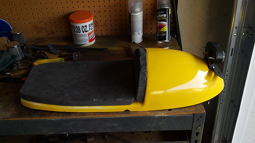

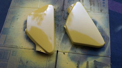

Dont know if anyone is still following, but heres another update. Bike is out getting the head redone. Guy I had do it the first time didnt do it right, so I got my money back but taking more time to get another guy to do it has been a pain. In the mean time, I got bored today, so I painted my seat and side covers. Also installed some seat padding and my taillight/turnsignal/plate holder. Will post some pics below along with how she's looking so far.

waited too long to edit, but the seat foam will not stay that way. It will be covered with some vinyl. Side covers are same color as the seat, crappy cell pics.
