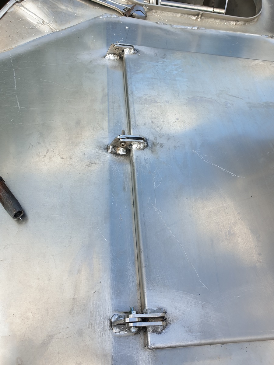

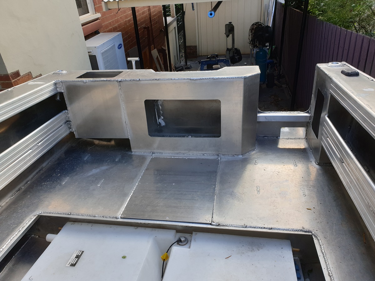

Managed to get some more work done on the boat. The rub rails are stitched on. The front hatch hinges are done. The double height shelves are installed all the way from the transom to front benches. With the bait tank where it is, there was no path to get to the batteries, I used some 20mm X 50mm hollow section, to make up a conduit to go under the bait tank and up into the starboard shelf. The sun shade that shades the electronic dash (Lowrance HDS9) has been formed and welded in. The cutout has been enlarged to fit the unit. There are 3 rod holders per side that are welded in.

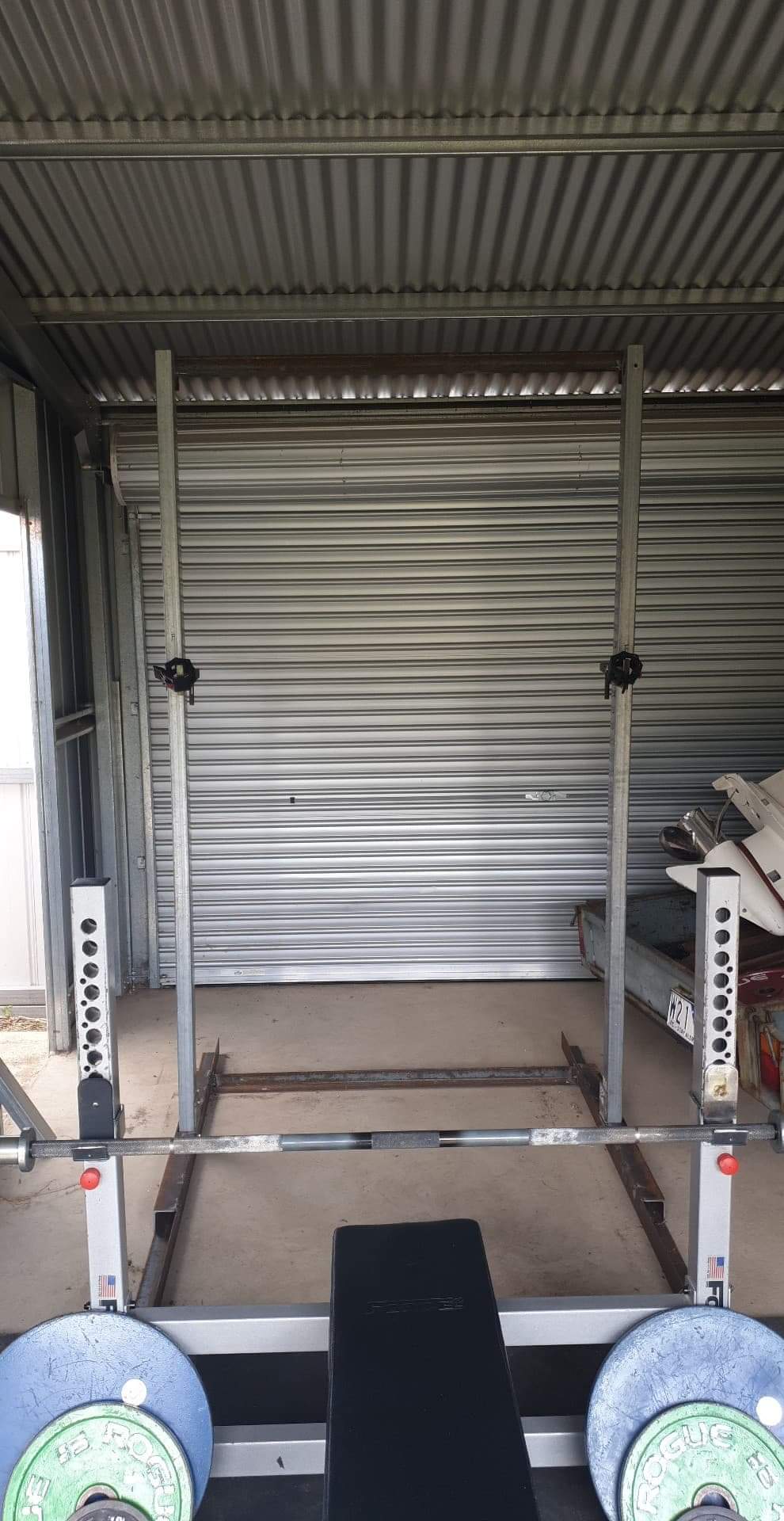

With staying isolated, has meant having to adapt. For my boys that means their gym has closed. They are a very close knit community, and we are maintaining our membership payments (luckily we still have work) thus the gym has allowed us to take some equipment home for the boys to train (stay sane). They have bars, plates and a bench press but they did not have a squat stand. Saturday was spent re-purposing the angle iron from the boat hardback building frame into a squat stand. I did not MIG weld it, it was back to a $100 Rossi inverter stick welder, that worked perfectly OK. I figure if the stand is OK with 230Kg for squats training, then it will be perfectly OK hoisting 180kg outboard so I can get it onto the boat.

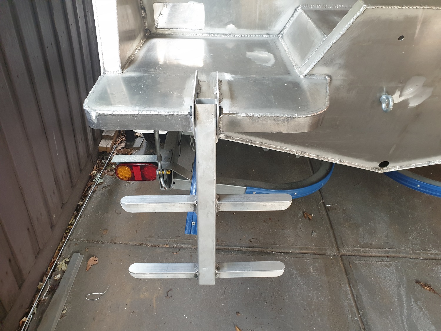

The only other item completed was the boarding ladder. The hinge is a stepped bush turned out of delron rod, attached with a M8 bolt and nut.

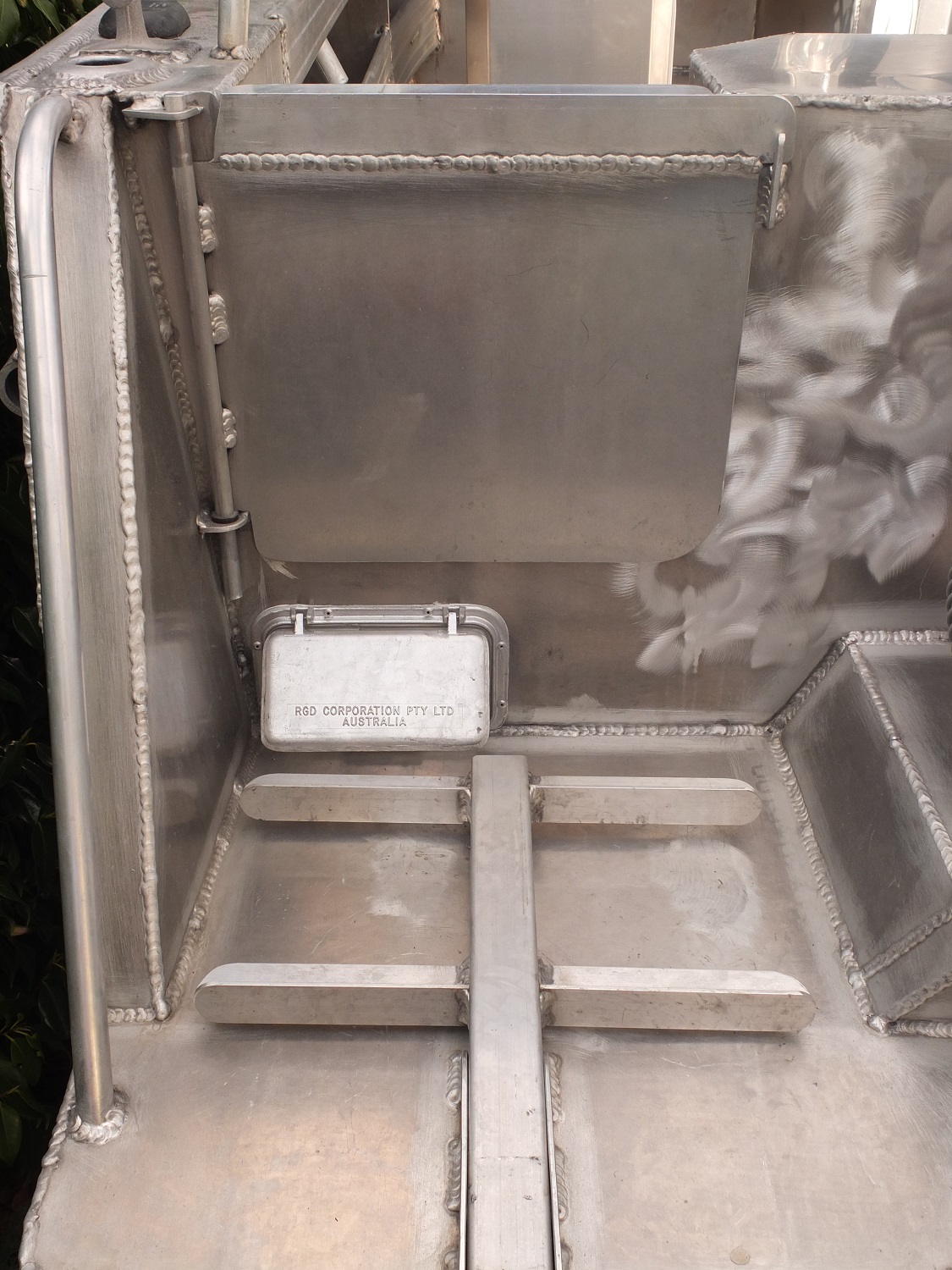

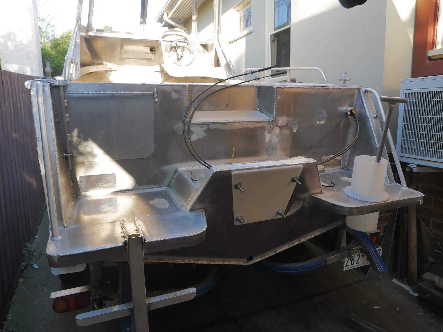

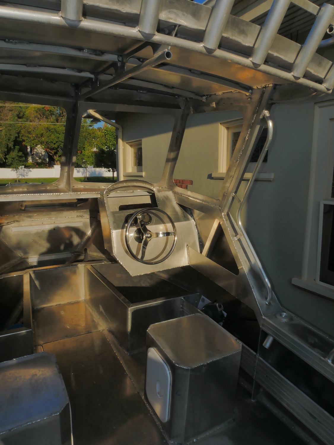

I have been given an opportunity to get stuck into the boat. Orders have dried up at work (no surprise), so half the staff have been stood down for the 4 days before Easter and the other half will be off after Easter. I am back to work Tuesday after Easter. Then I guess we will see what happens. Certainly better than other alternatives!
Made the rear access door, very simple lifting hinge that allows you lift it out of the catch and then swing open.

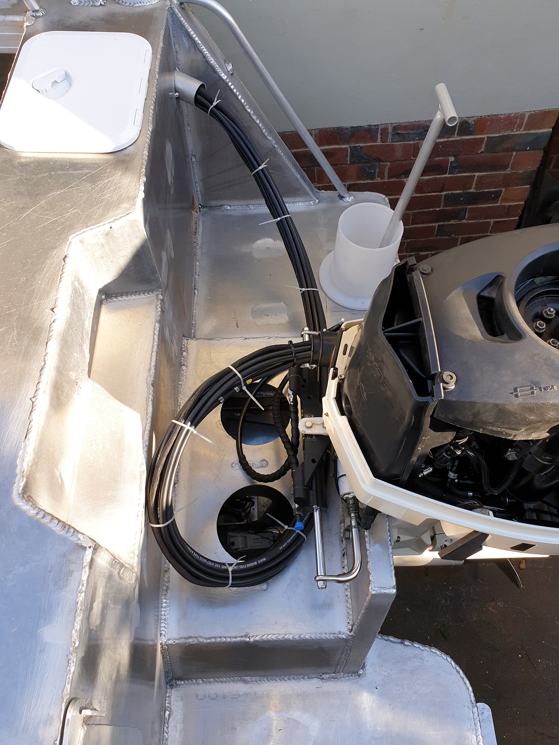

Finally found some 63mm flexible conduit to take the cables, harness, oil & fuel, steering hydraulic lines etc from the transom to the outbourd. Made a "grommet" from 60mm alloy tube and tacked it into position.
When standing against the gunnels they only came up to just above the knee ( the compromise of having a self draining cockpit). Not ideal when in rough seas fighting a decent fish. Added rails along the side, that add support half way up my thigh - much more comfortable.
Seats have been lost by Australia Post, but I started on the helm by fitting the steering pump and wheel and the 2 Evinrude multipurpose gauges. The cabin side rails took a bit of fiddling to get right, best to start with the middle bend.
Finally fitted a fuel water separator / filter under the gunnel just in front of the bait tank. The plastic hatches have just been temporally fitted.
Onto the front rails tomorrow.

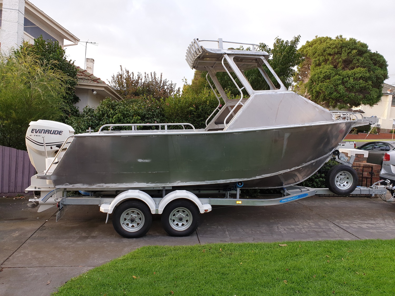

Vinyl wrap above the waterline and 130hp Evinrude ETEC is hopefully going on tomorrow.

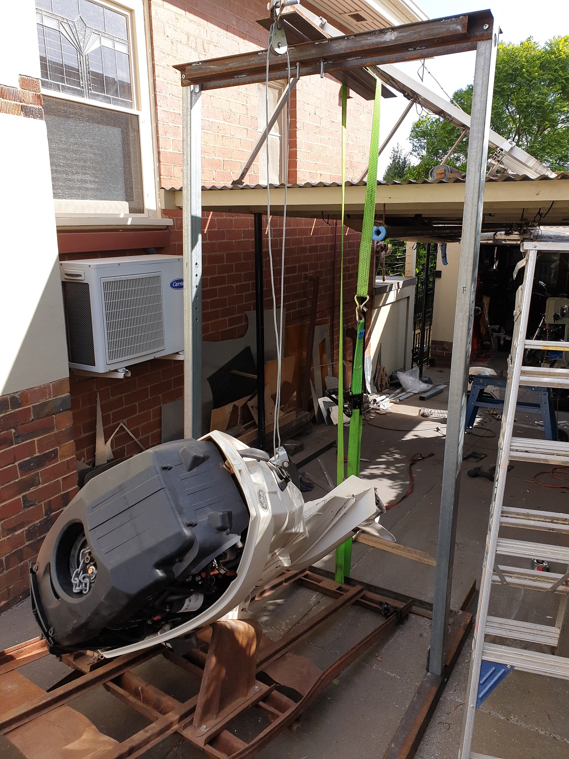

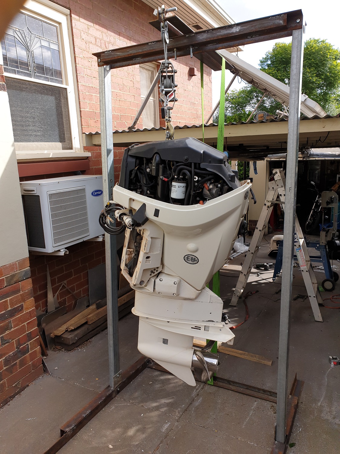

Motor is on. Apart from getting the wrong bolts to lift from the flywheel. I bought 5/16UNF per other blogs, needed to race out to Bunnings (hardware store) and get 3/8UNF bolts. After that it all went smoothly. The main bolts holding the motor to the transom are 1/2UNC SS316 torqued to 45FTLBS. Sikaflex 291 silicon to glue on the nylon pad and take up any gaps. The motor was bought second hand with 300hrs on the cpu, that is the first service for an Etec!

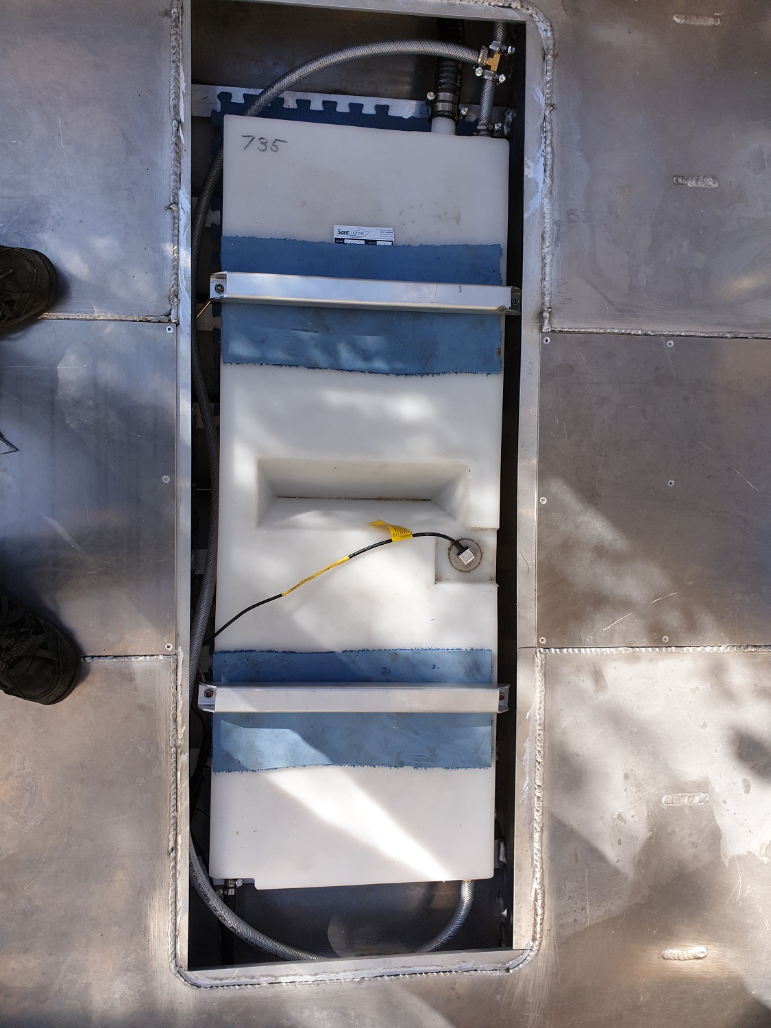

Plumbed up the fuel tank.

Initially, I thought it might have been an overkill using 63mm conduit (not fitted yet) but as you can see the cable run is filling the 60mm grommet going through the transom. I still need to add the Lowrance transducer cable. 63mm conduit is going to be full!

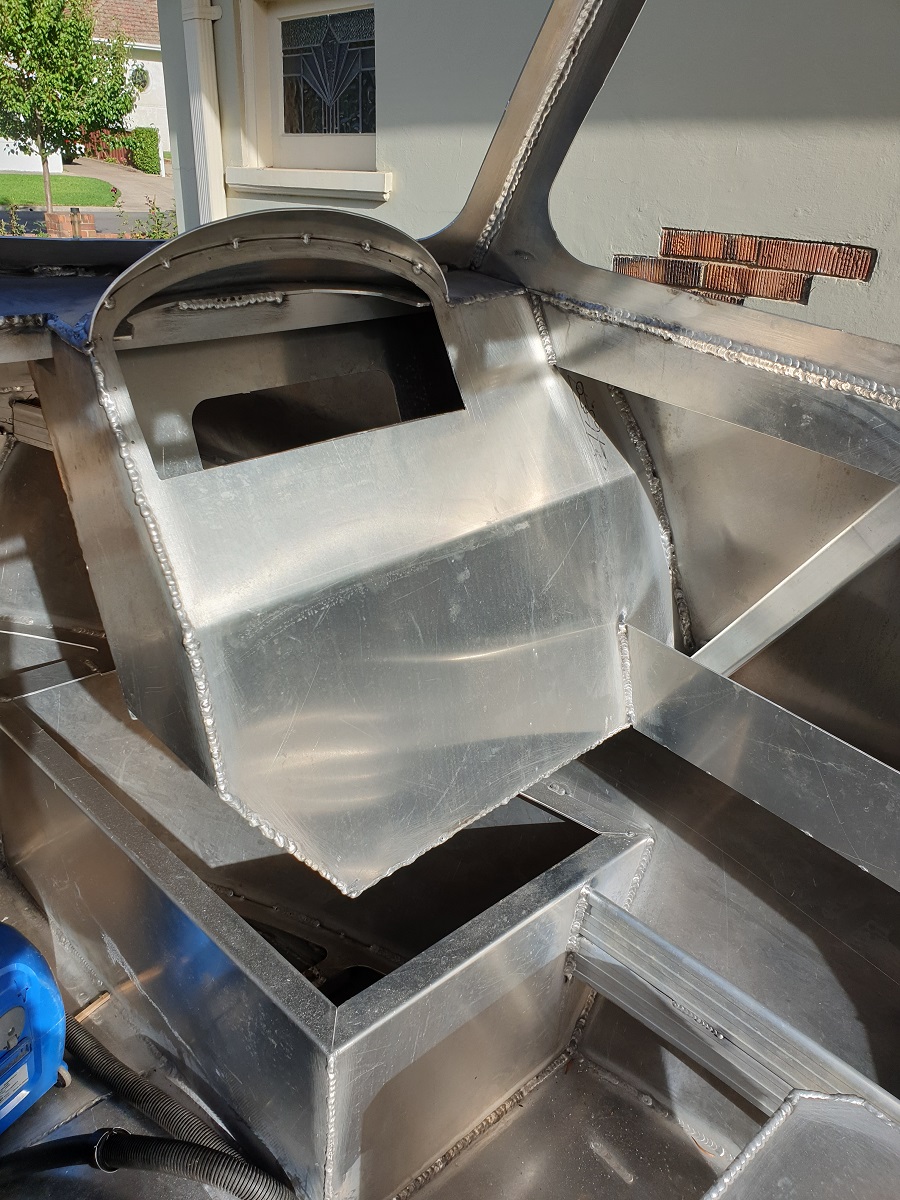

Starting on the dash.

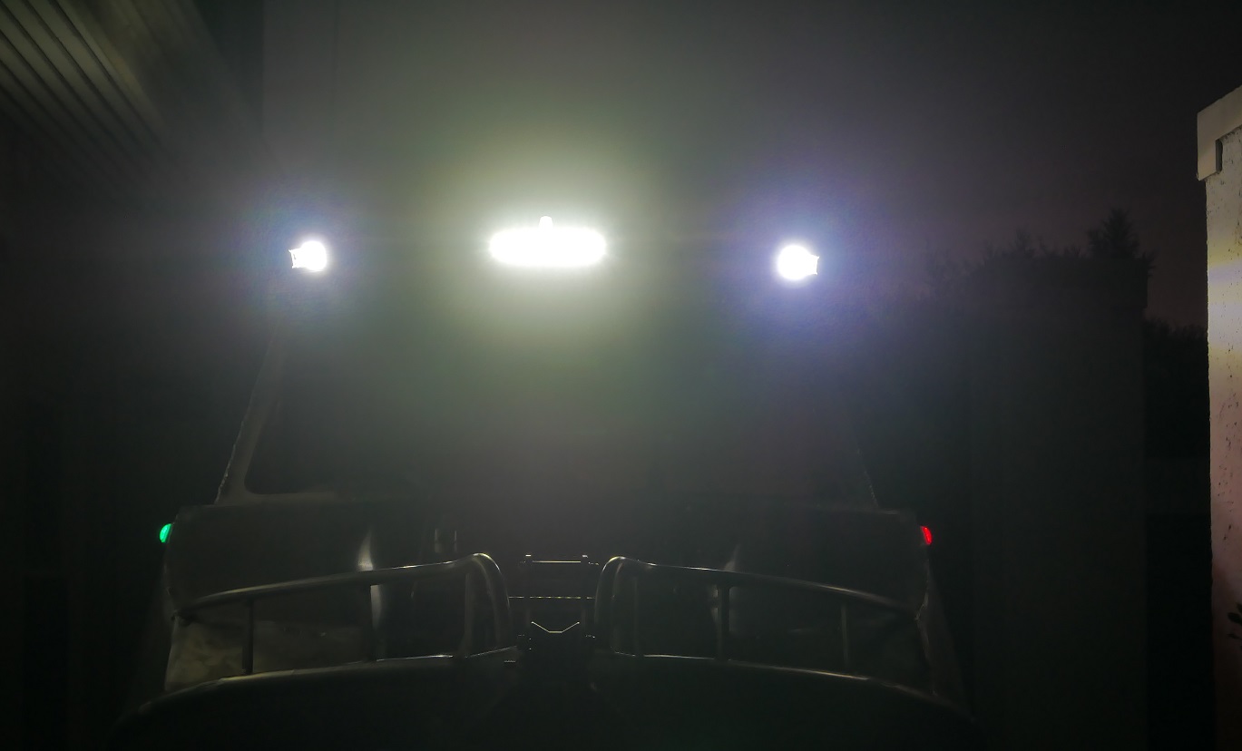

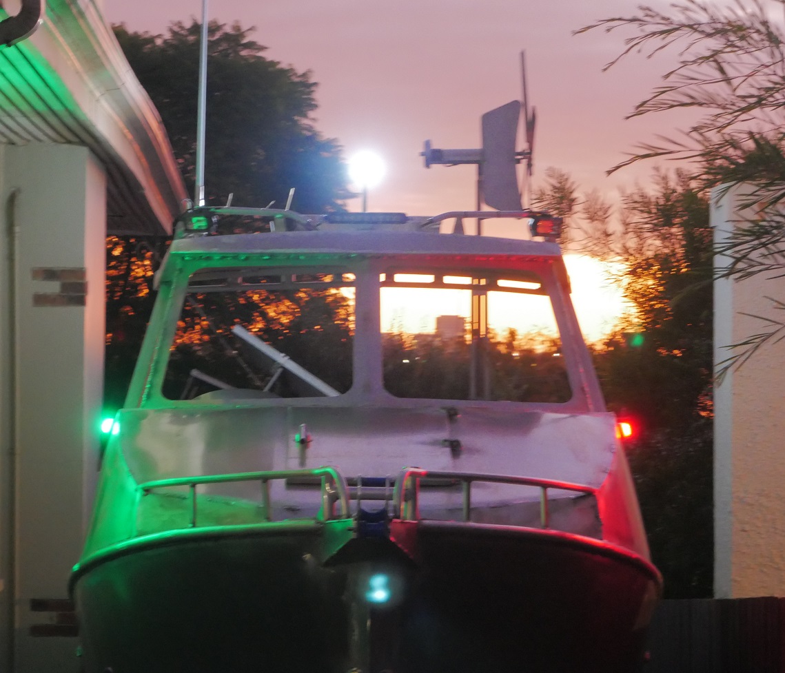

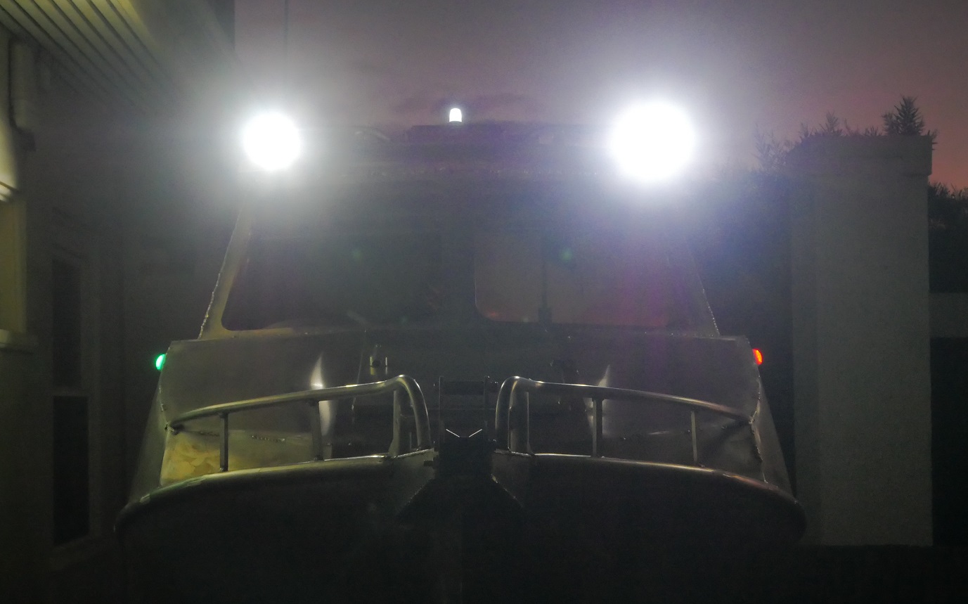

Lights Action!
Solar cell has been installed, charging controller connected = Batteries are now charging via the solar system. Woo Hoo!
Still have to install the duel voltage sensing relay, to make sure the starter battery is protected from being drained to a point the motor will not start.
Anchor winch is 80% wired, need to mount the switch into the dash and connect the feed wires to the winch.

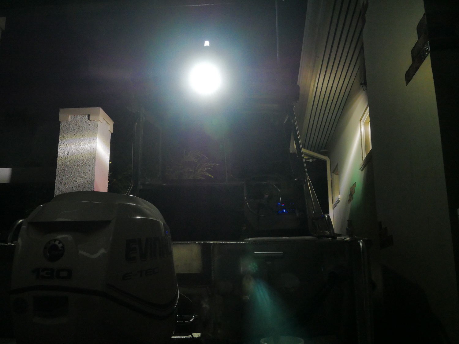

Lights,
Navigation lights installed and working.
I have 2 LED flood lights mounted on the corners pointing out at 45deg to the center line.
There is also a 10" LED light bar centrally mounted pointing forward that is a spot beam.
Pointing to the rear is an LED flood centrally mounted.

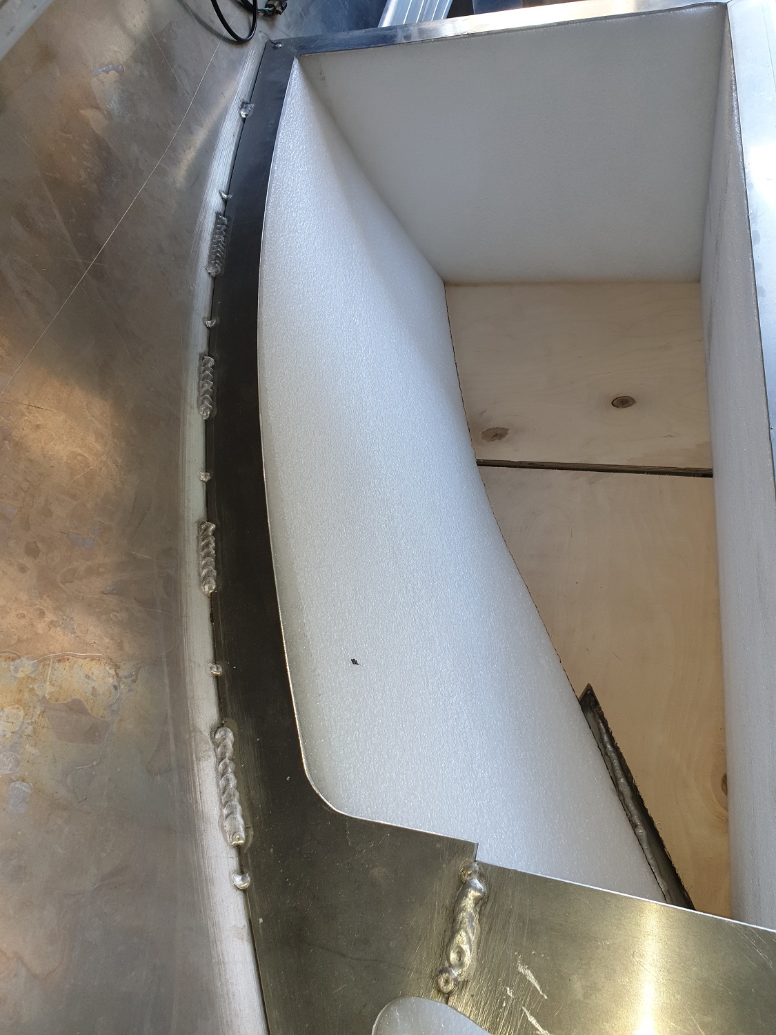

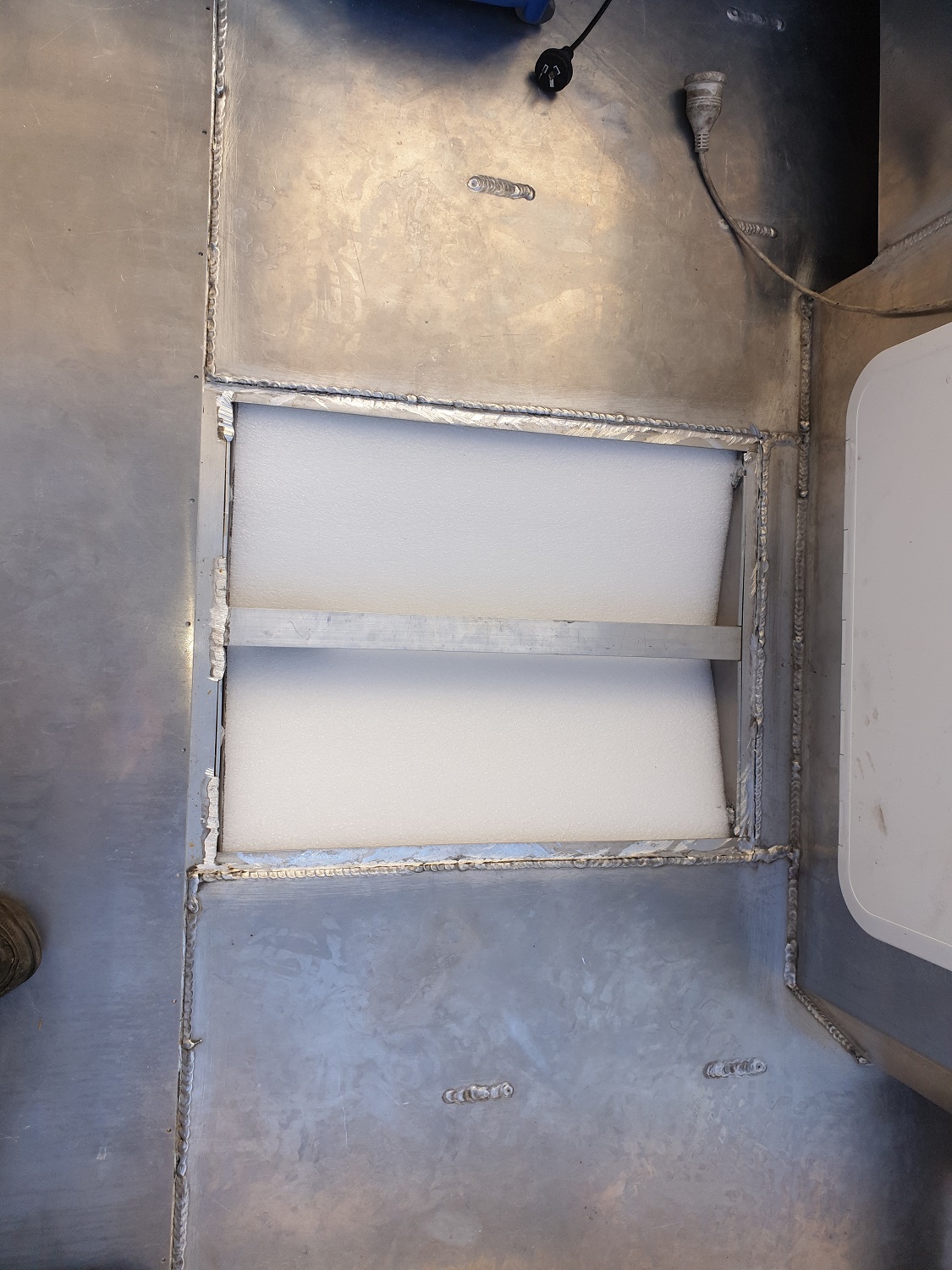

Its not going to sink. Put 1.3 cubic metres of PE closed cell certified buoyancy foam filling the hold. The sheets are supplied as 2m X 1m X 50mm, I used a bread knife to cut the sheets down into smaller blocks to get them in under the deck. It was probably the most physically demanding task of the build, to get all that foam into position. With all that foam filling the hold it is going to cut the water noise on the alloy hull, which is a good thing.
I also finally connected the hydraulic steering, and the instructions were not that clear as to which side of the steering pump was connect to which side of the ramp. You guessed it, I got it reversed. A geezer of oil and the hoses were swapped. I then purged another litre of oil to clear the lines of air. All good now.

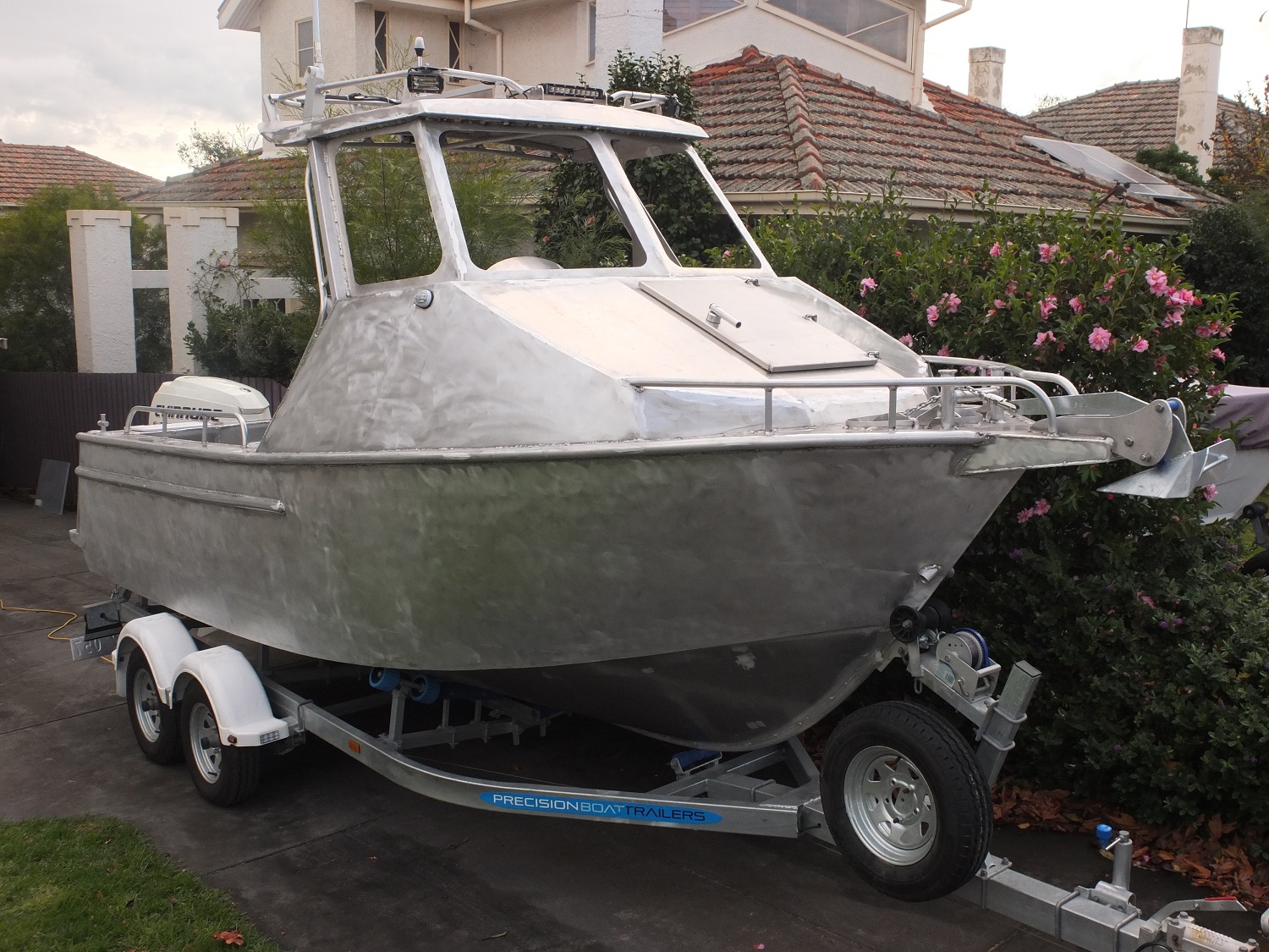

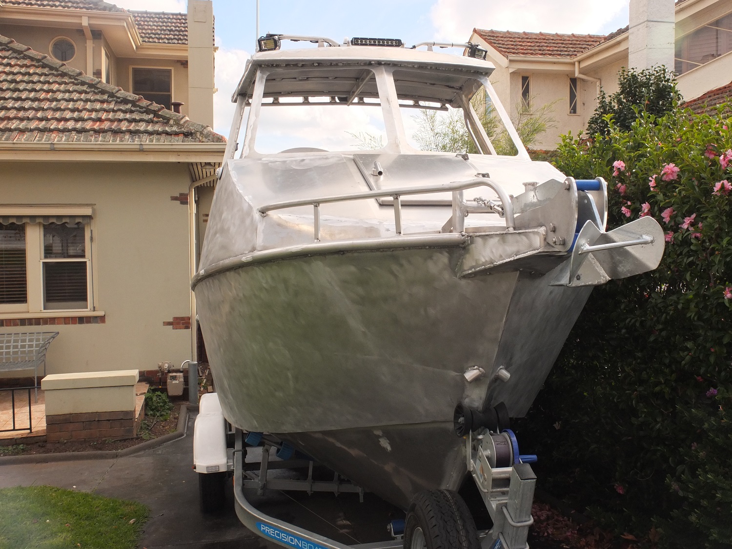

Getting close to throwing it in the water.

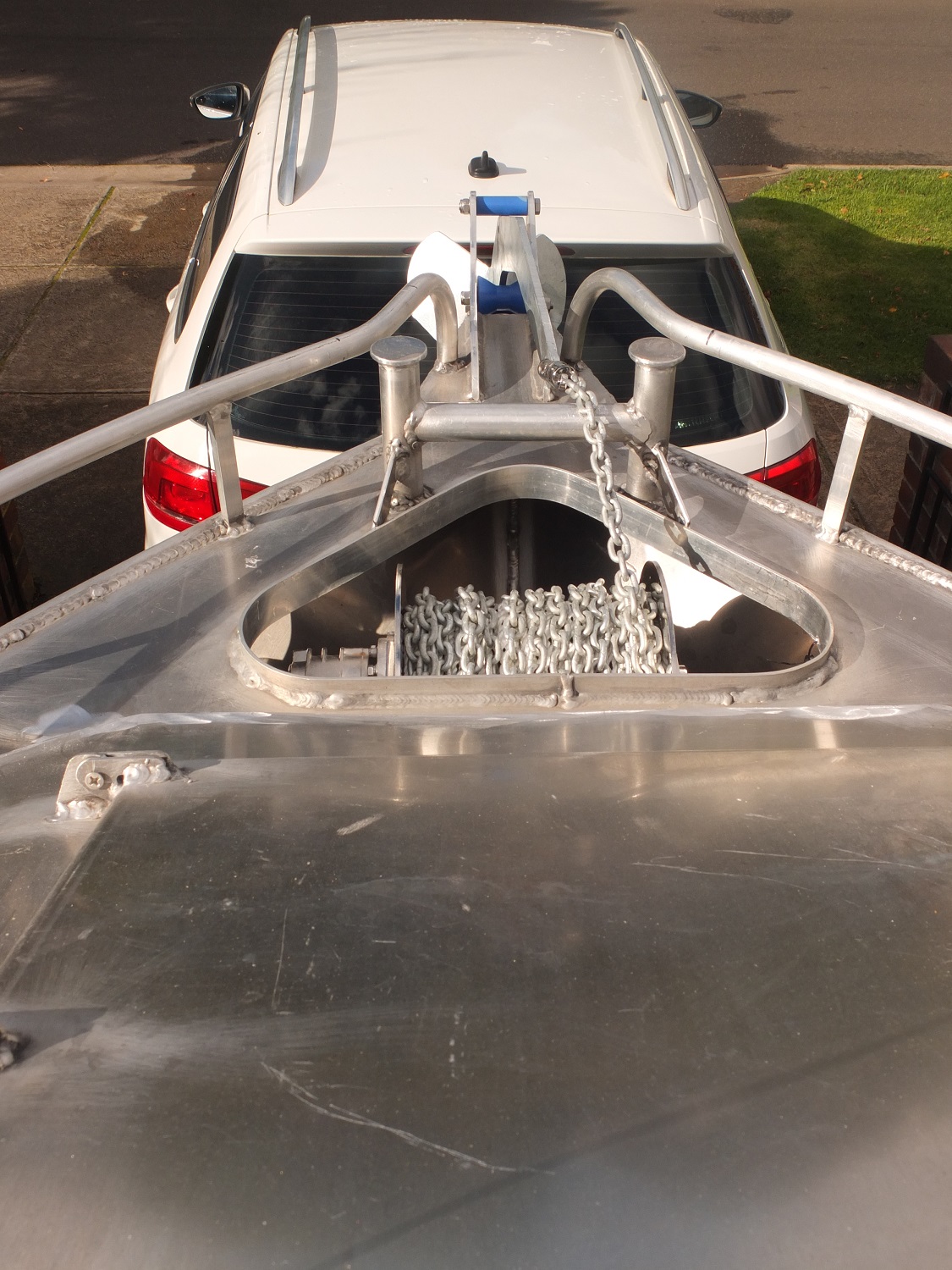

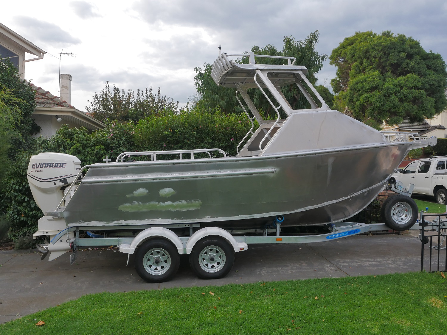

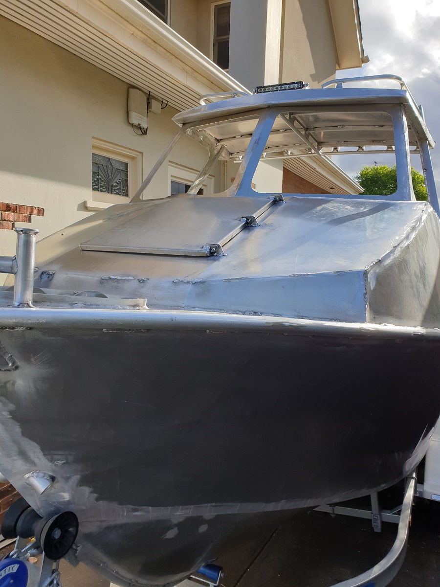

Everything is connected and working. Spent Saturday sanding the outside of the hull and cabin. First went over it with 80 grit on the 125mm velcro pad on the angle grinder to sand down the high spots (weld). If you keep the disk well lubricated with wax it comes off very quickly as the grit does not load up. Only used 1 disc per side. Once the high spots were ground off then all over it with the orbital sander, again with 80 grit and more wax. It needed 4 discs per side.
The most important piece of equipment is the twin filter gas mask to keep all that aluminium dust out of my lungs. I was sparkling all over.
I am very happy with the sanded look, and it is extremely low maintenance. What do you guys think, leave it sanded or go with the vinyl wrap.
Next weekend the windows go in and once the registration comes through then it getting wet!
