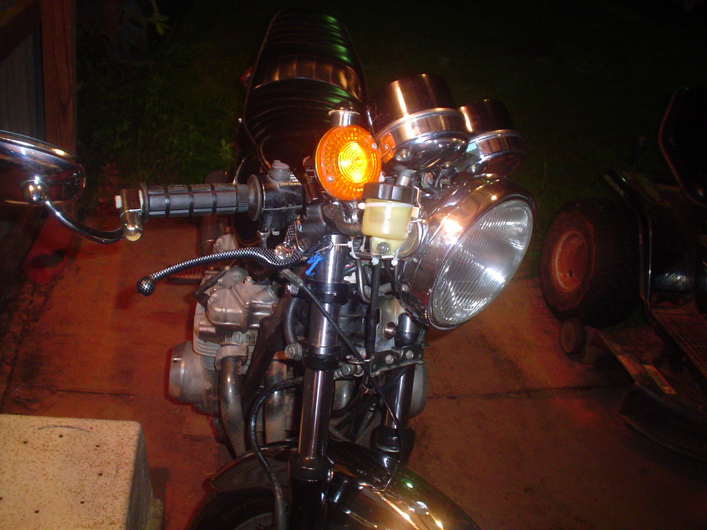

When I switched to clip-ons, I had to switch to a master cylinder with a remote reservoir. This one came off a GSXR 600, not sure what year, but it's a 5/8" bore. I'd tried one from a TL1000 first, but it was a 14mm bore and just would not work.

You front end looks crazy. What's with the reflector?? Do you have any pictures from another angle?

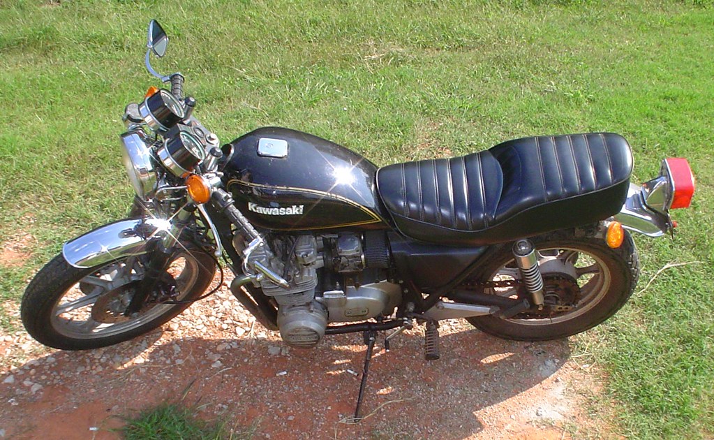

These were obviously taken before I tore it all down. Here're some more recent shots:
