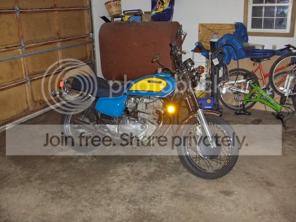

Hey y'all. Really enjoyin this site so far. Lots of really nice builds goin on. Its nice to see a few other guys out there with Honda 400's. Not too many of them in my neck of the woods. I bought my 81 CM400e about 5 years ago looking like this:

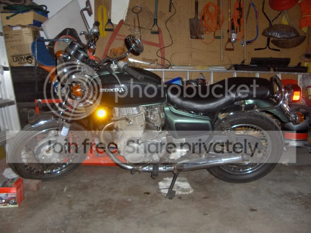

Then painted it and redid the seat in fibreglass to this:

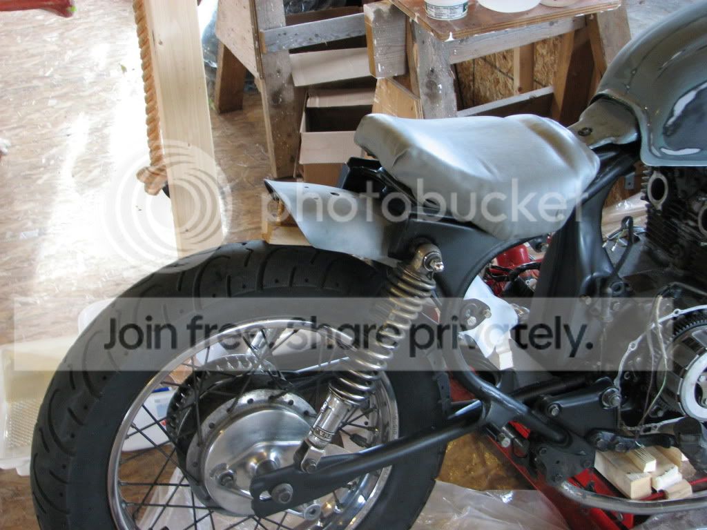

Same bike! Right on. Yeah im not too sure what im gonna do about the seat. I already lopped off the rear section of the seat you see in the second pic, cause I was gonna do a bobber style, then changed my mind too late. So I'll either buy a cafe seat, or mend the old seat and add a hump and re-upholster it. Likely the latter, cause it's cheaper.

I've looked at those RocCity seats. Saw a few on some CB's on here and they look good. I already chopped my frame though, about an inch or so behind the shock mounts, so I would need to figure out a way to mount the seat.
