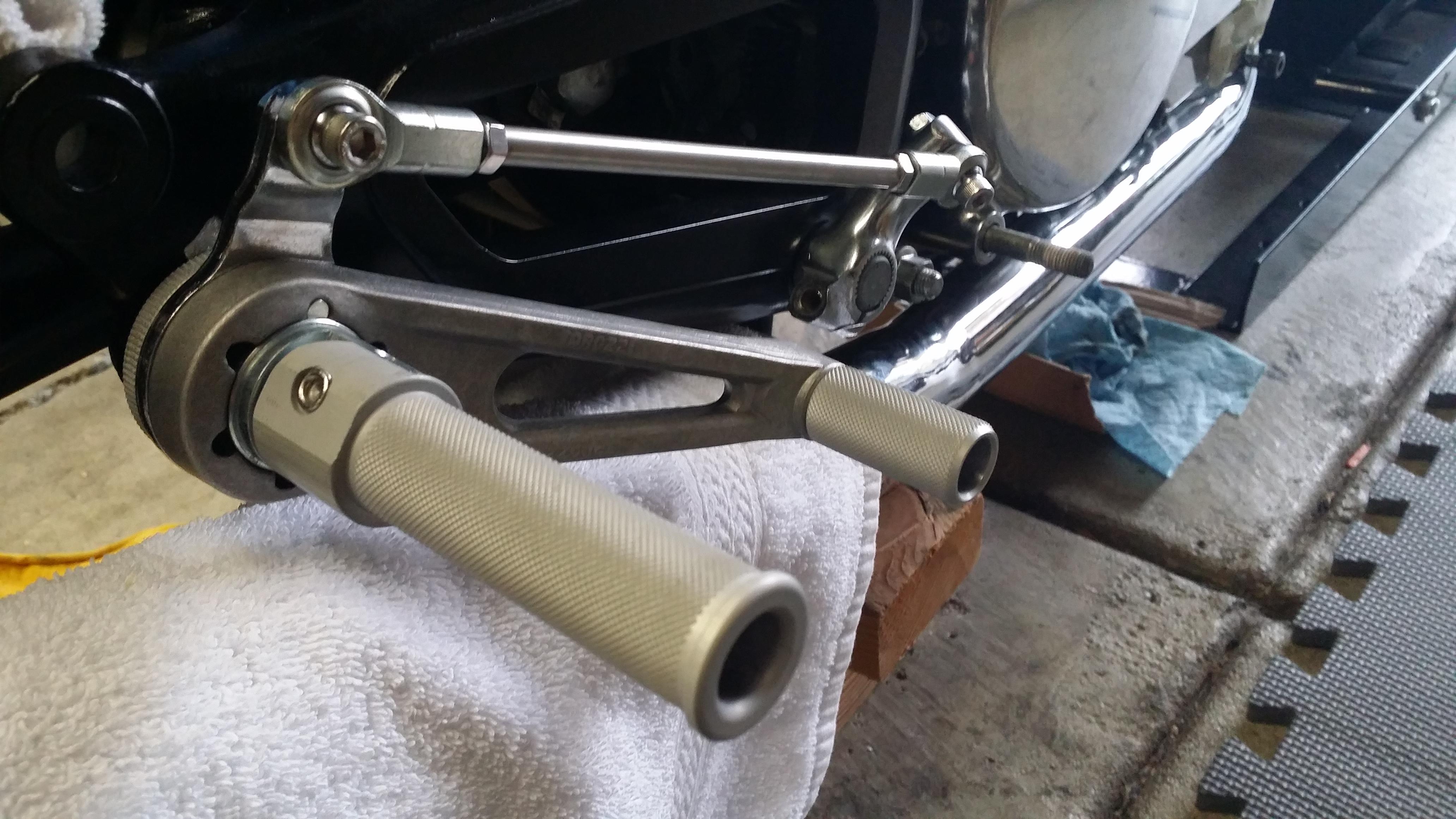

Ground it down and mated it up with some linkage...
To make a nice fit and smooth action. Working on the shifter now....

Re: Nuckingfuts Custom Build
Shift linkage done.
Now just waiting on custom throttle cable from Motion Pro so I can fire up the bike.

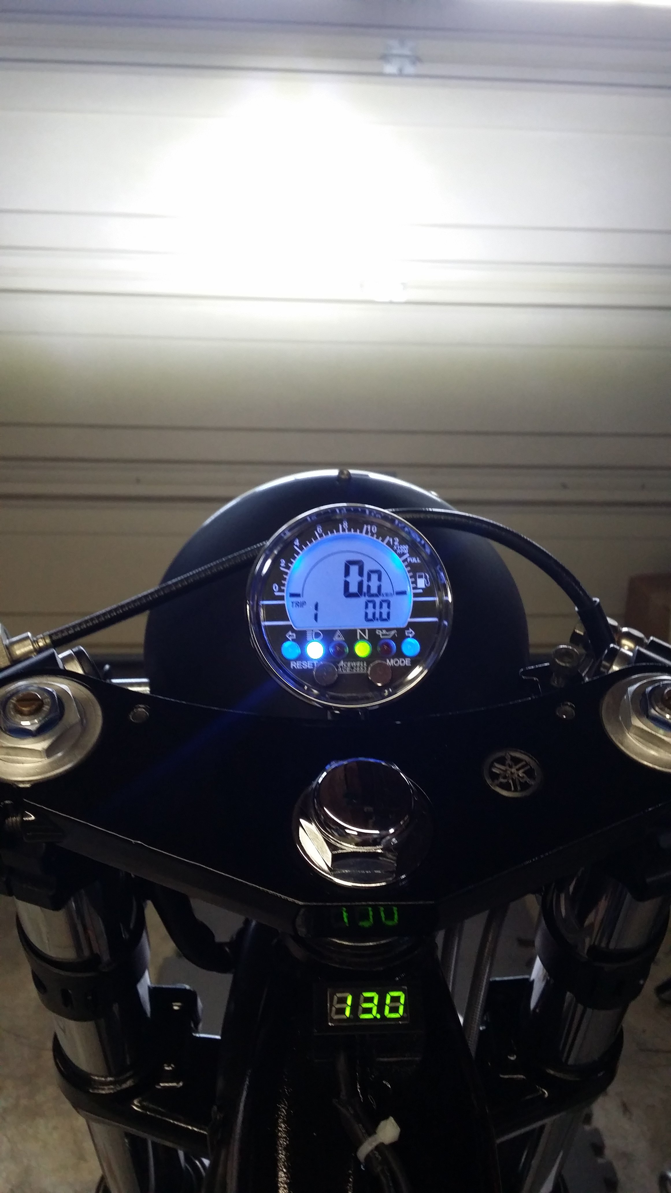

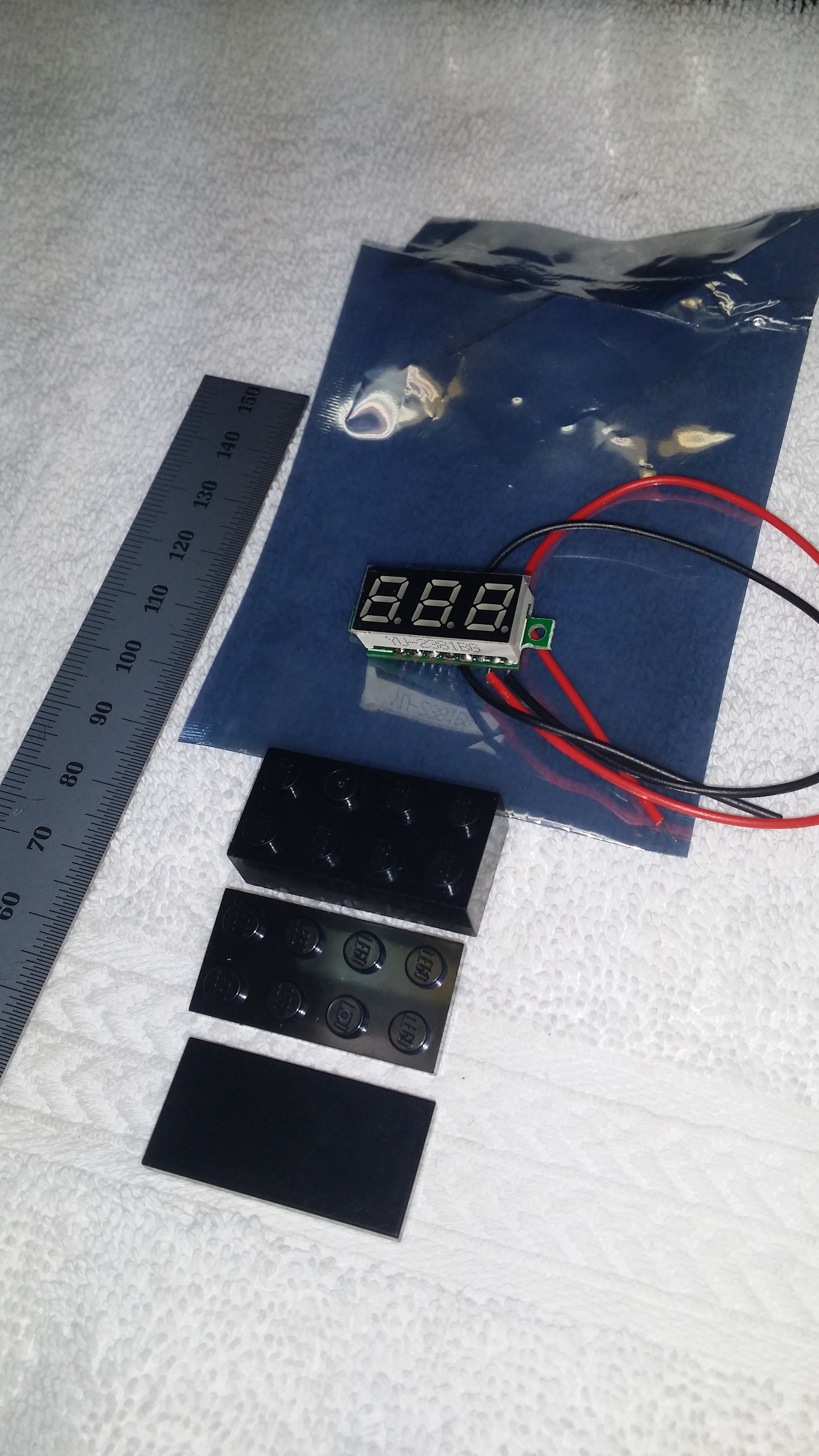

was looking for the smallest voltmeters on the planet and found these micro voltmeters on ebay so I decided to try'em out.
I really wanted something inconspicuous that I could use to keep an eye on my charging system. Shelling out big dough on the Shorai battery I want to make sure that the vintage charging components don't fry my new tech.

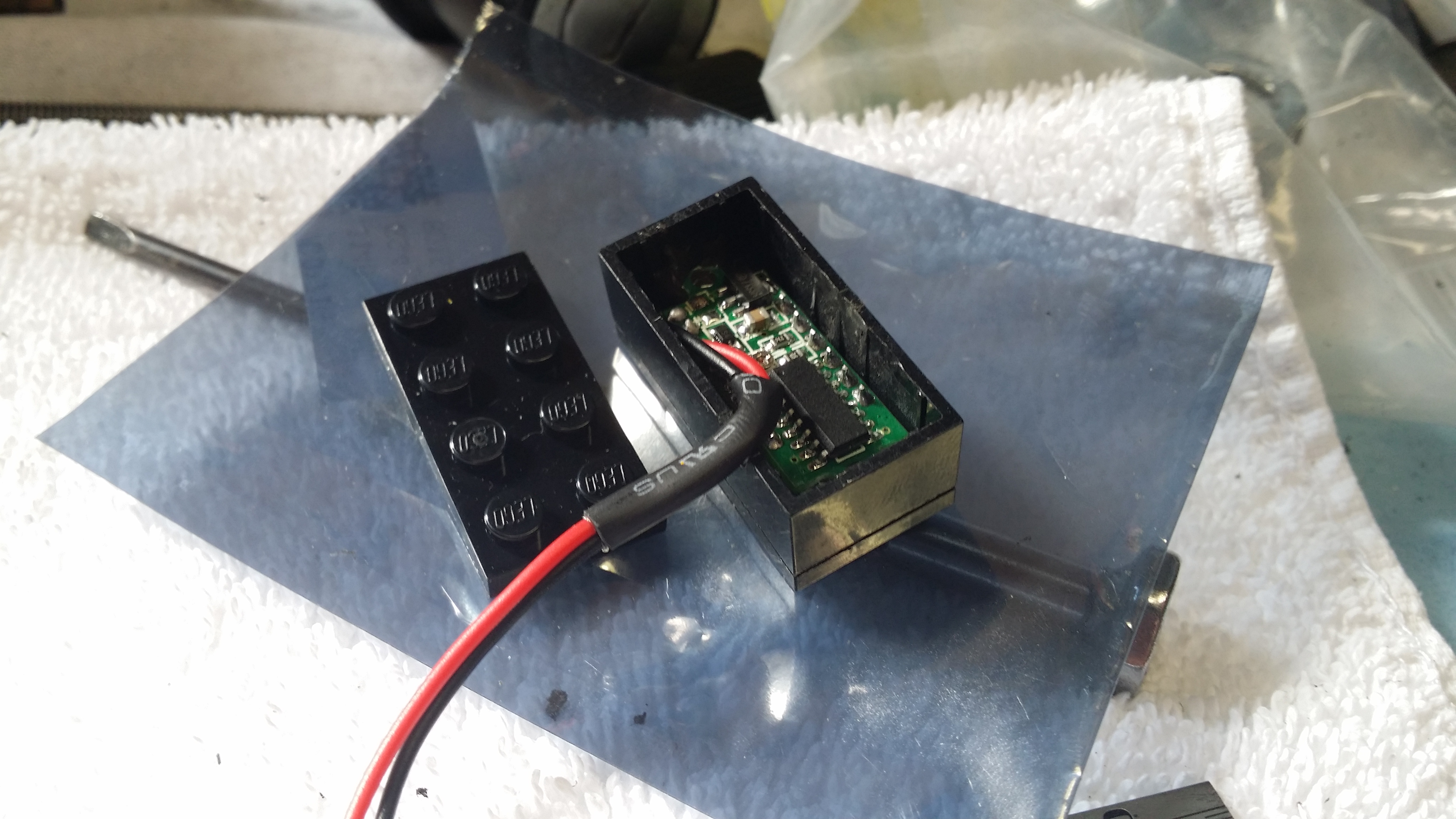

Since the voltmeter came unhoused I had to make my own enclosure to protect the electonics. Now I could have easily ran down to an electronics shop to find a solution but after searching my kids rooms (picture lots of arts n' crafts crap laying around) I found an option.
Now this is where you start calling me on hokie jeryrigging and all that business. Call me crazy but I dug through my son's Legos and found a viable option (don't tell my son though).
After an hour or so of whittling on Legos I had this.
Threw some epoxy into the mix to seal it up and she's ready for duty.
I'm thinking this will be a nice tucked away location that won't draw too much attention.

redwillissuperman said:
Where did you get a 13V static battery?!?
Actually my batt has been sitting in garage for 12 months and is down to 75% and needs to be topped off. It's a Shorai and really needs to read above 13.2V
