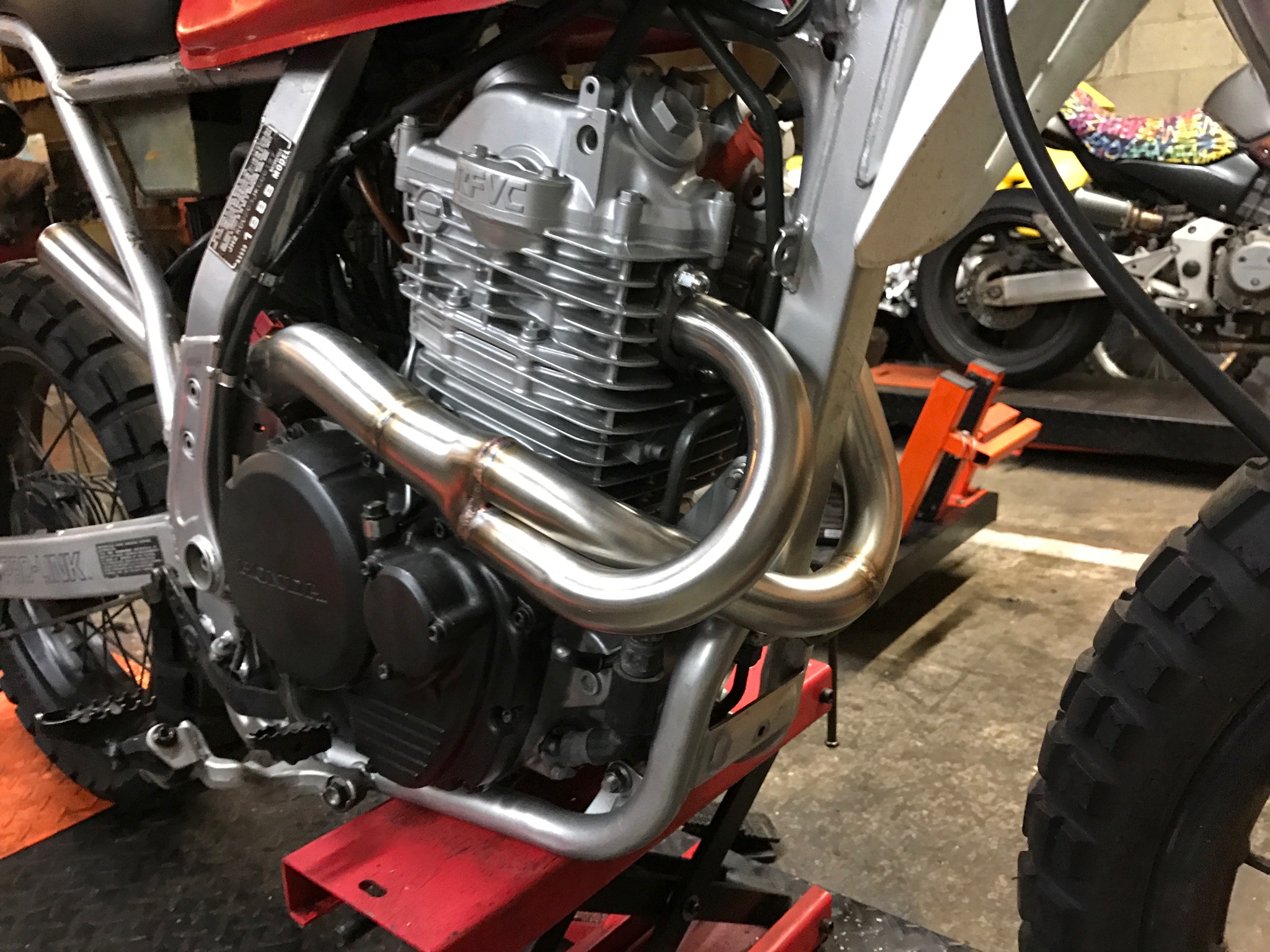

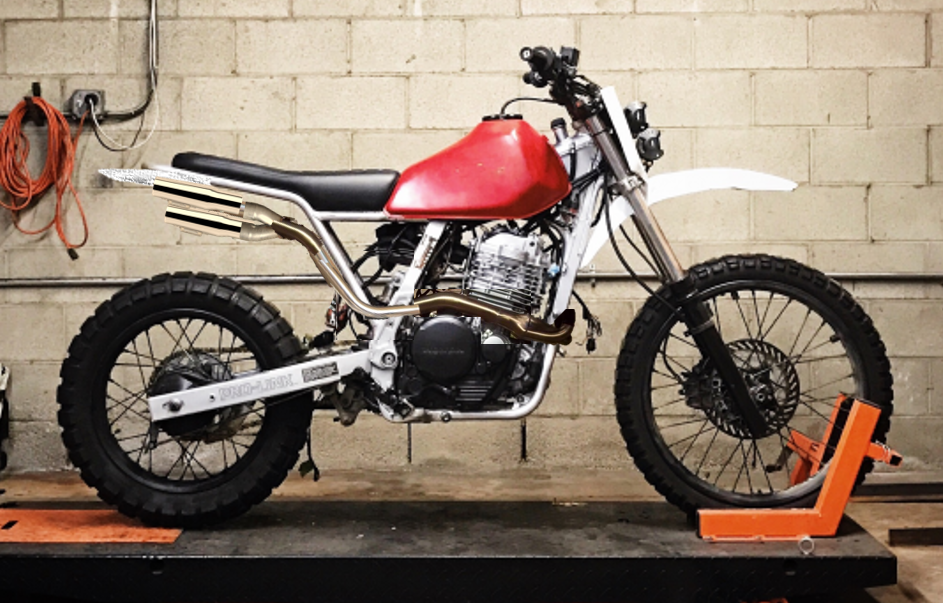

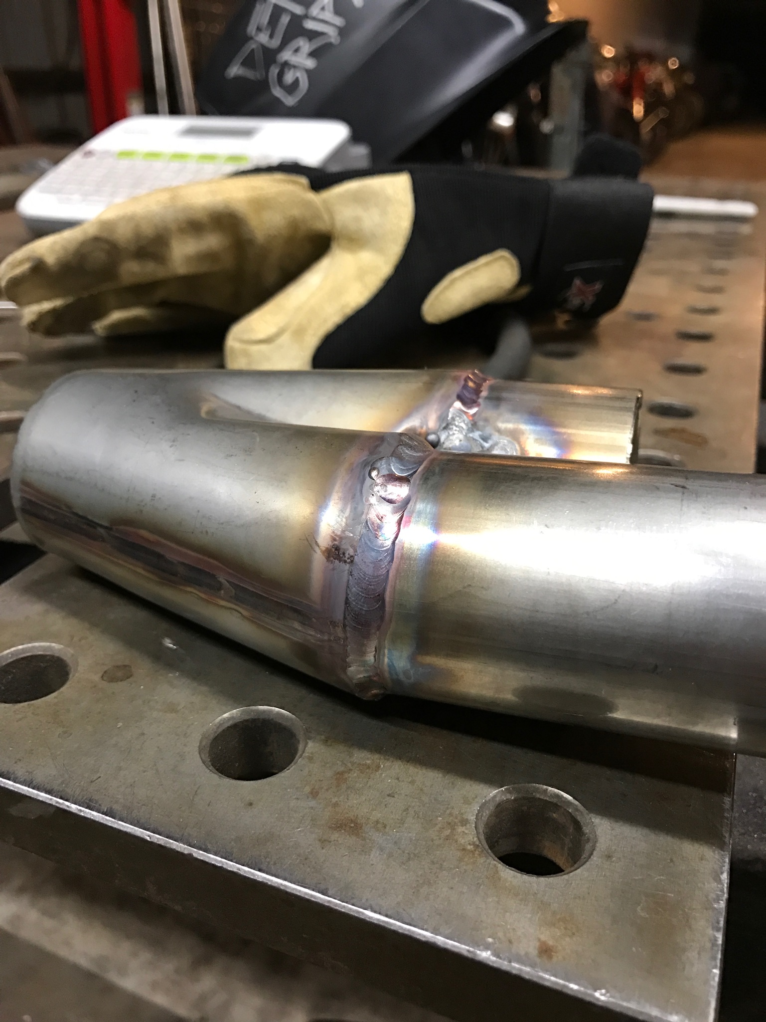

Alright alright! Sorry its been so long. A TON has been buttoned up on the NX. Battery box and new lightweight battery are all installed. Wiring is all clean. EXHAUST IS FINISHED! Man I'm stoked on that. First time TIG welding exhaust and it turned out not half bad. No leaks! So that was awesome. All the little things are finally adding up to a lot of progress.
I have just photos for days here. And a final rendering (I did it before I finished the exhaust) to show the simple color scheme I have in mind.
I was able to take it for a test ride and man that thing rips. Its absolutely fantastic. So much low end grunt! Only bummer is that there is a leak in the intake manifold, so a new one is on order. Then just need to rejet it and I should be up and running!
Then paint, making a rear fender, hard mounting the taillight, and getting the gauges set and its time for a proper photo shoot!

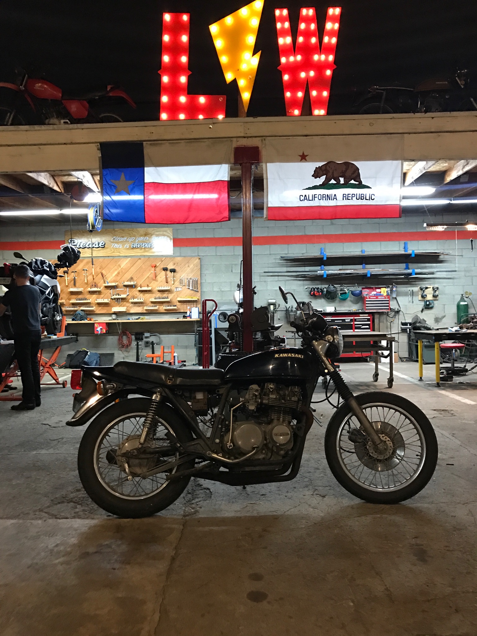

Oh - also.....I picked up another project bike! 1978 KZ650 will be next on the chopping block! I want to make myself a fun little city bike that will look really really cool with a girl on the back haha. Just a coffee shop cruiser haha.

Plan for the KZ is switching the ignition system over to a Dyna S and upgrade to the good coils and a 3 phase charging system. Then probably do some head work to clean it up a bit, and make it run a bit smoother. All cylinders have really good compression, but going to some triple angle valve seats and port and polishing should help. Then I'll simplify the wiring harness (PO attempted this and ended up stripping everything out, and now its a mess) so I'll clean up all that crap, rebuild the carbs (already has pod filters) but will probably forego turn signals and any handle bar switches. Hopefully can make some pretty trick hidden buttons for starter and kill switches. Then some nice sticky tires, chop and loop the frame, custom smaller 2 up seat, new shocks, new headlight, new gauges. The overall plan is to keep it pretty lightweight and very minimal.
More of a tracker vibes I guess. I have a set of Renthal UltraLows that I'll throw on. I just can't do the clip ons haha. Too low for me! Lots of cleaning and paining and just keeping things fresh. Oh and a gold chain, have to have a gold chain haha. I'll make a nice small battery box to open up the rear subframe and should have a fun little city cruiser. I'd like to do a tail piece that mimics the stock one, but in a much more subtle way, but we'll see how that goes. I just like that duck tail haha.
I'll get a thread going for that one too. As soon as the NX is running properly and on the road, I'll switch focus to building the KZ.

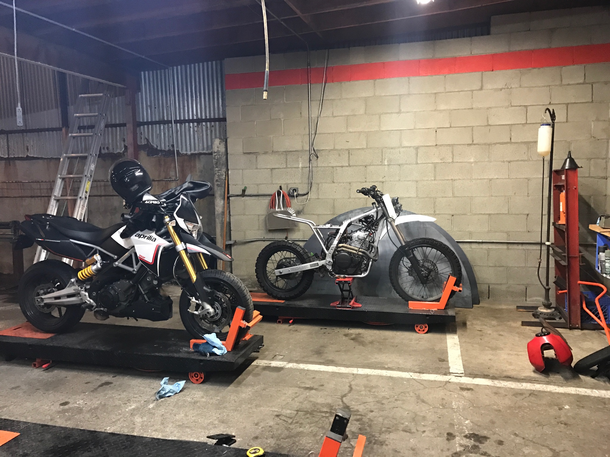

btw, is this a community shop you are working out of? I'm digging that Aprilia, looks fun.
I would love the KZ to be a canyon ripper. I lean more toward performance rather than looks. I would love to just rally this bike, maybe a 18in setup and sounds like longer rear shocks are the way to go.
Which thread should we move to? Would love to get more conversation going on this!
Also - yup! Its a community DIY shop. Its called Lucky Wheels Garage in Downtown Los Angeles. The Aprilia is another members bike. Man its so sick haha, although I'll always favor the Ducati Hypermotard.

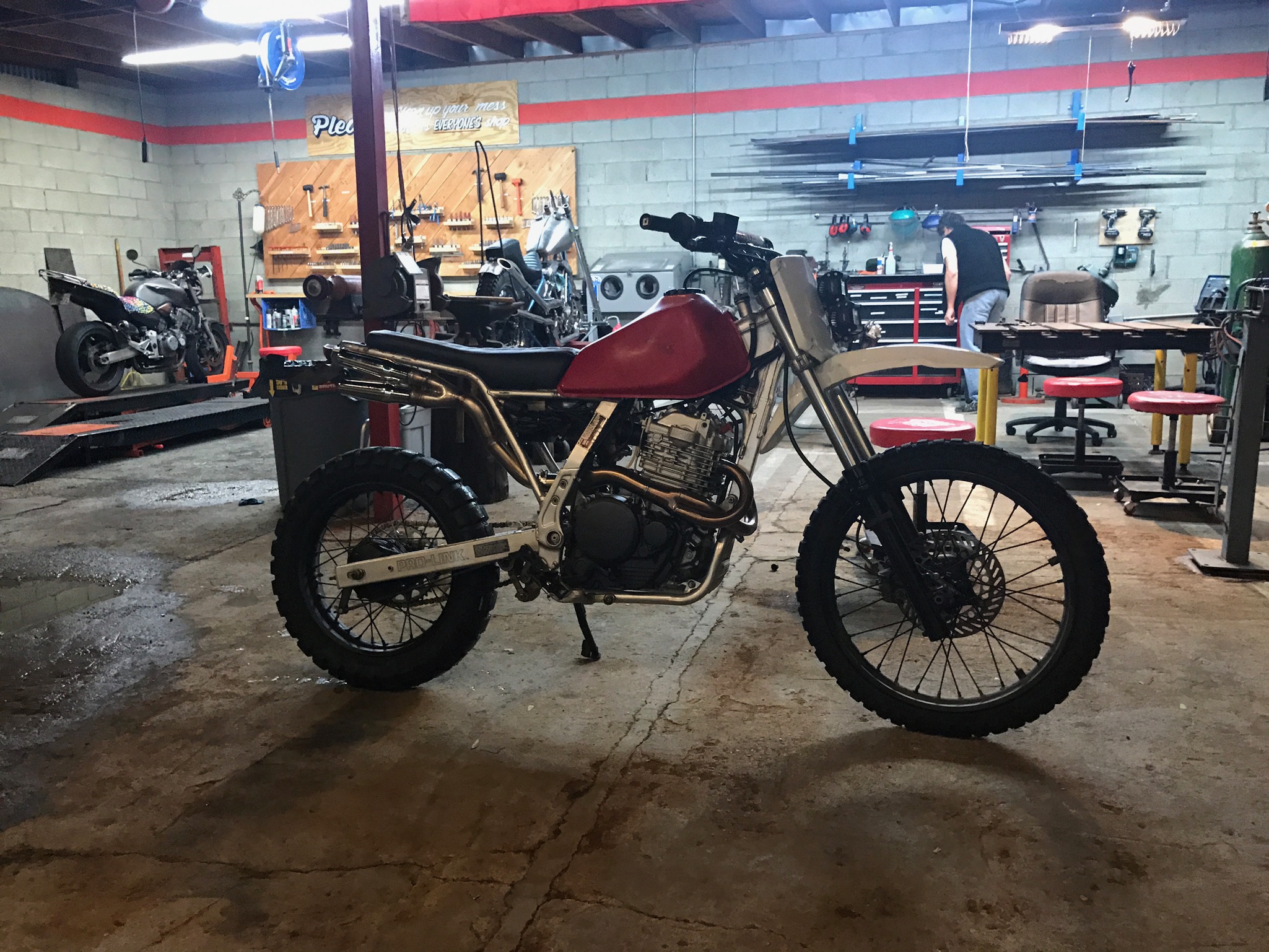

Well its not quite buttoned up but it runs! Any by runs, I mean it flies like a gosh darn bird! It is a straight up wheelie machine. 1st is basically for looping the bike, 2nd gear you cant keep the front wheel on the ground, and 3rd is just a hoot. I really can't believe it turned out. So far everyone that has ridden it has come back with a giant grin, and that's exactly what I want a bike to do.
Still sorting out an air leak in the boot. Turns out "overnight parts from japan" is only a car thing, and I have to wait 2 weeks to get a new intake boot. For now jetting is close enough to ride, but it'll stumble at idle.
Since I now have a running bike, this project will take a bit of a back seat to the KZ build. I still need to find a painter to do the tank and rear fender (which I still need to make) and tear apart everything and repaint the frame (didn't turn out that great and it needs some love). I also have visions of doing some kind of mini side covers to hide the electrical too. The current zip tie situation is to much of a situation for my taste, but I was too excited to ride it haha. Bolts and safety wire and lots of loctite still need to be applied.
Also its stupid stupid loud. Like so loud I'll have to plan when and where I ride it, so that exhaust might be coming off and replaced with something else. Gobs of power, but too loud for me.
But its good at what I intended it to be, and wheelie and skid machine that I could jump curbs and take anywhere.
I think a few more things will be done just to button it up after the carb is finished, and its time to take this thing to Baja! I'll see if I can post a video link here for sound.

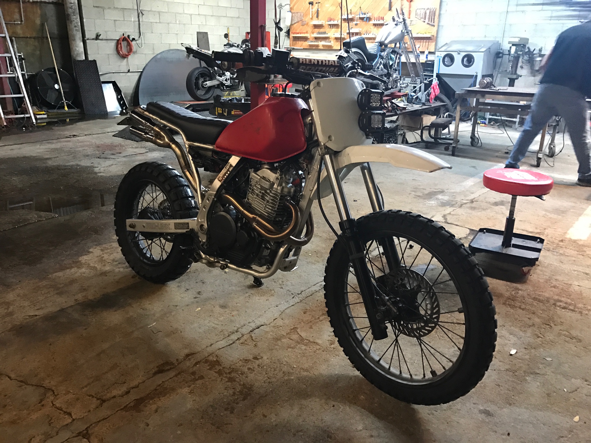

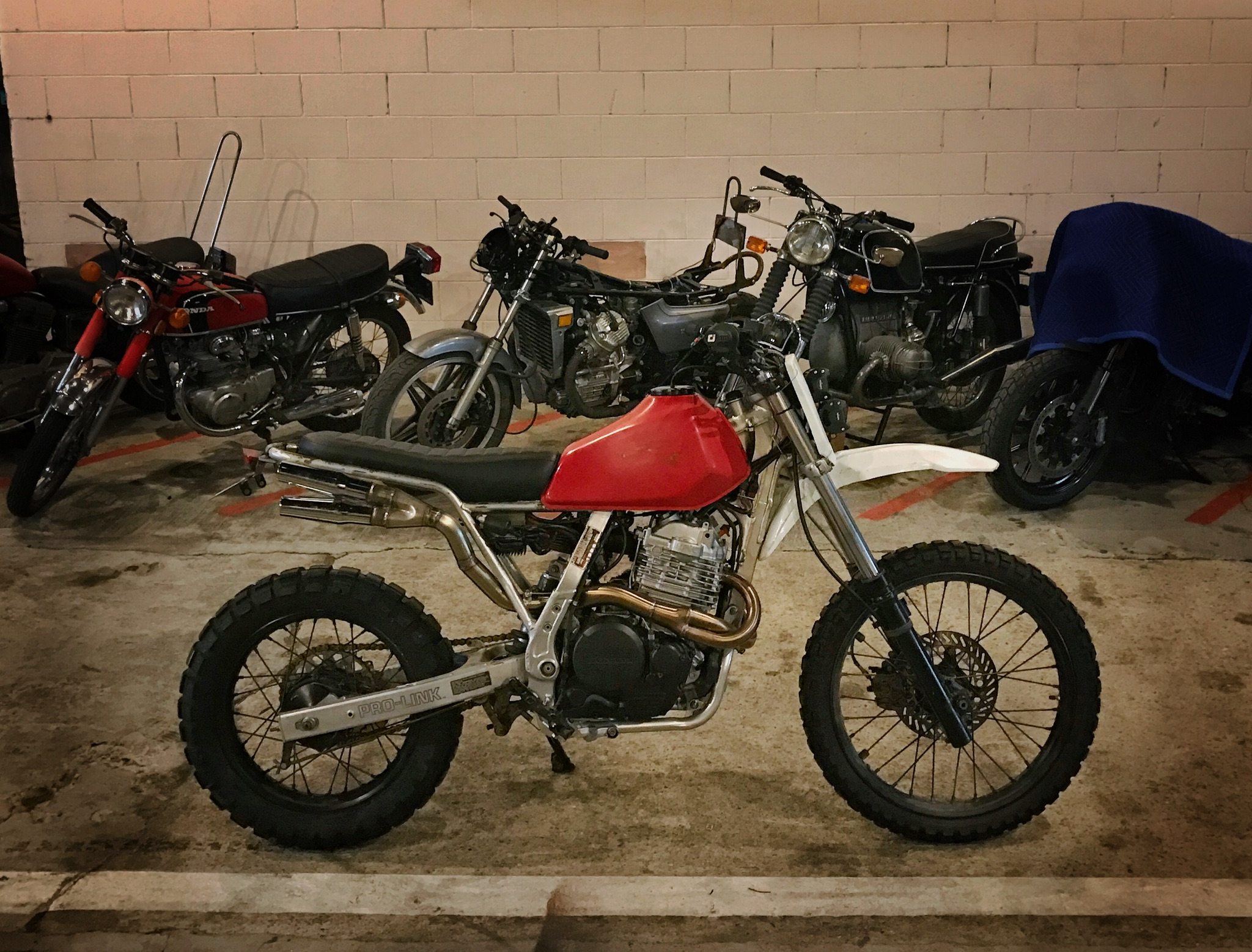

Photos of the semi complete bike. I think in the next few weeks I'll finish up the little things and get a proper photo shoot of it......or maybe I should just man up and finish it the right way and be done.....
