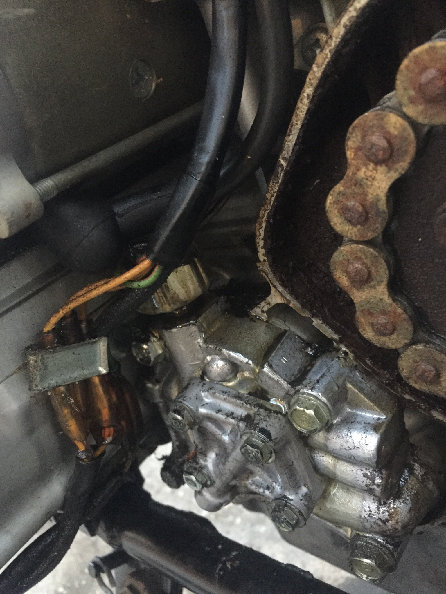

Hey everyone,
So this started 2 weeks ago with a slow leak on the left side.
It has now reached the point of consistent overflowing.
Any suggestions on how to fix this?
Thanks in advance!

A little hard to tell from photos, but oil pump has a couple O-rings that seal it to the engine. Or it looks like it could be your sending unit -- they're still available oem for $25 or so.

Thanks for the reply!
I found a spare oil pressure switch.
Problem solved. This forum and its members are the best by the way!
