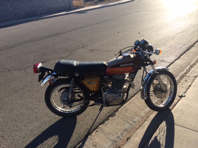

As a new transplant to Las Vegas I found myself with no transportation as I'll be waiting for my other bike to be shipped here a month from now. So yesterday I found an a CL360 in amazing condition and couldn't resist taking it home with me. So this is going to be a new build tread for it. It's in amazing shape, bought from original owner with 7,000 miles on it. Its so perfect I really don't want to change much. Gonna keep it tracker and see how I like it. I'm also excited to have an actual garage complete with real live scorpions! Haha, but serious sick of building out of small spaces, outdoors or in my bedroom! Going to list a bunch of things below with a direction I'm going to take for now. I appreciate any input.

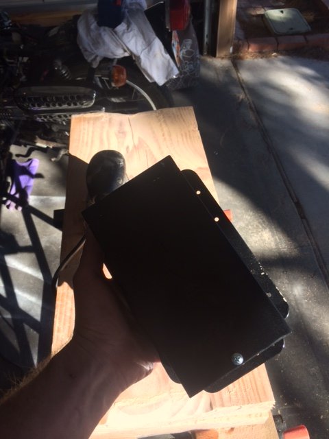

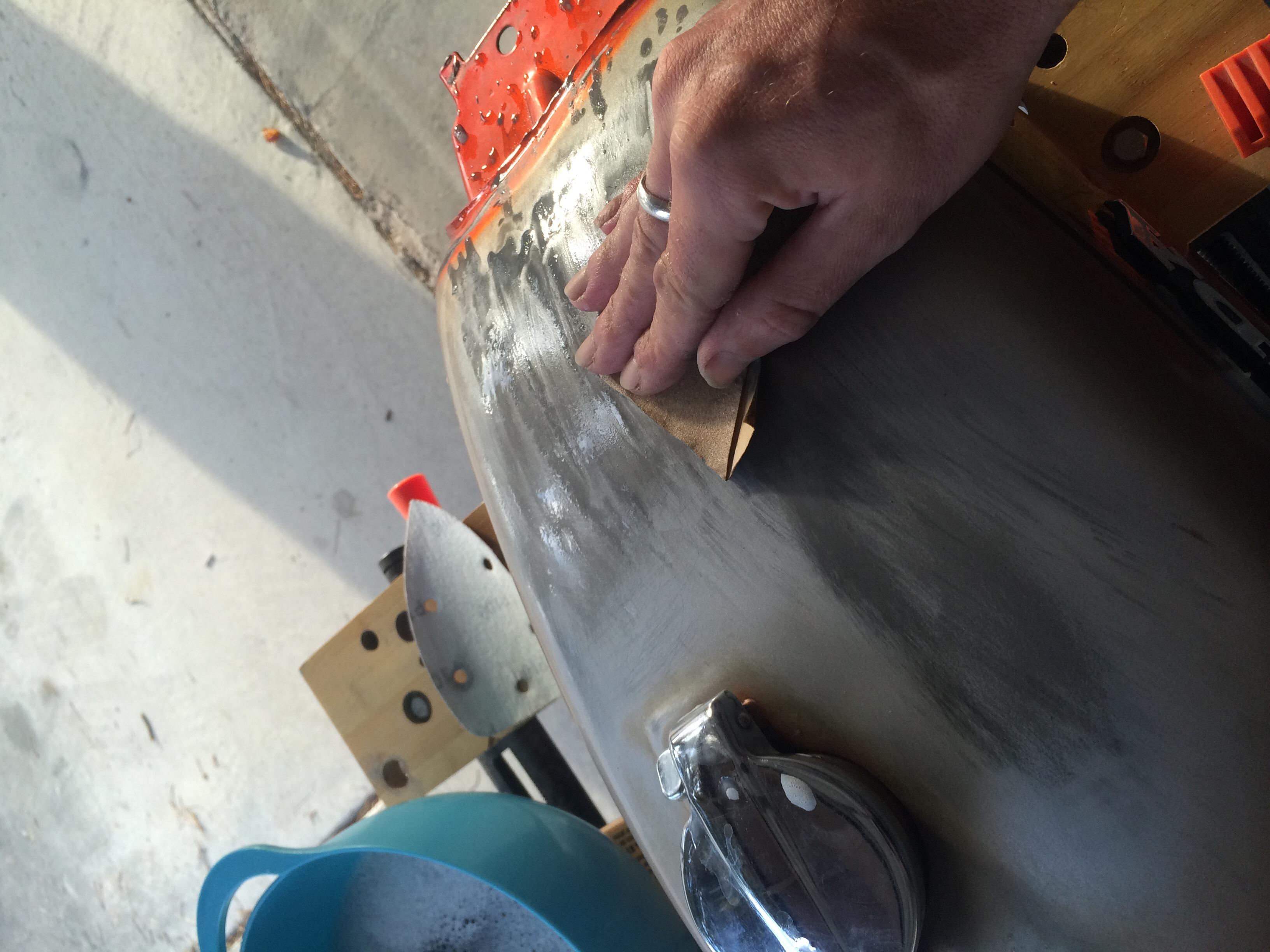

Well that info was a little too late ;) Something to worry about later haha. Not to worried though, have done worse things to carbs before than cleaning them improperly. I clear coated the tank. Looks the same just really shiny, very happy with it. Also just bought another tank on ebay. If anyone needs one lmk as I bought it just to play with (could even refinish it and paint it to your liking possibly). would let go of it for the right price. I "fabed" a battery box from an tv electrical box as well and painted (gloss blk) it yesterday. Going to fit it in there and adjust everything today and then put her back together using the stock parts so I can get through an inspection. If I can fit the new battery box and the stock air cleaners, I plan on keeping it like that and not messing with pods. Don't want to deal with the nightmare of tuning carbs like I had to with the PD's on my other build. Tires should come in tomorrow as well. DCC order comes in Thursday I hope. And started sand shaping the seat. That process is going to be slow going though. I'm aiming for this as my "inspiration" Can wait to ride her. will post up pics later of progress.

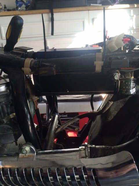

Below are pics from today. And then i'll follow it with a vid of it running. Battery box installed. Had to run new leads and all electrics are now relocated to the back of the battery. Sits flush and good. But had to secure it for now with zips as I didn't have the proper fasteners. Carbs sync'd and reinstalled. Breather boxes reinstalled. Note the tube connecting them is not in place yet. Fired right up but is pulling way too much air!. the vid is with choke open just a tiny bit. Opening choke just a little bit more than that makes it rev WAY too high. Was able to drive and switch gears but with stumbling throughout gears (3erd seems to run the best). Tried adjusting air/fuel screws but it doesn't really make sense to start tuning without controlling air box situation. Considering closing both openings in air boxes instead of connecting but wondering what effect that will have on system because it wouldn't create a "circuit" as far as air flow is concerned. Feed back appreciated.
