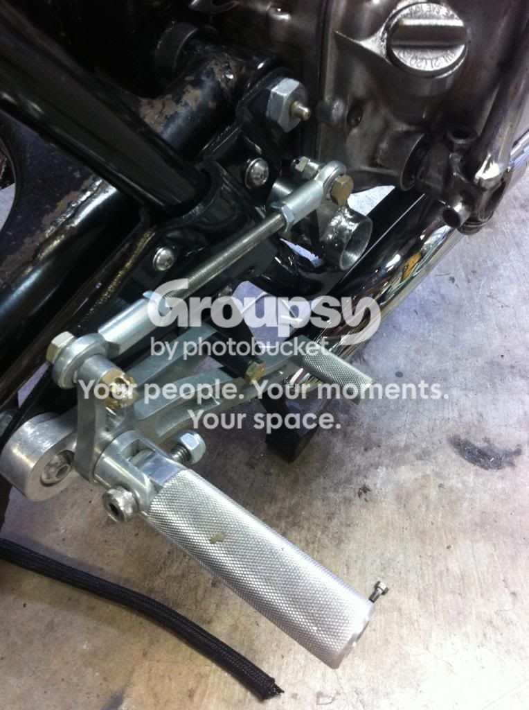

Linkage is hitting the stock passenger bracket. Also it came with 3 90° rod ends and a hiem Rod end. The hiem does not fit the all thread. Is there something I am missing. Does anyone have some pics they could post up of them installed?
Think heim ends would pull the all thread away from the frame to clear the passenger footrest bracket?
Is there a reason why you went down and drilled a hole for the mounts that came with the set?
also what is going on with your brake side linkage? It looks clean going forward, are you using the stock link to go back the the break lever?

the reason i drilled the hole is because i wanted to use the mount hole as a pedal stop, so i did both sides so they would match. no other reason.
yes i am using the stock brake actuation. check my thread about halfway down the page, "how to do rearsets twice"
