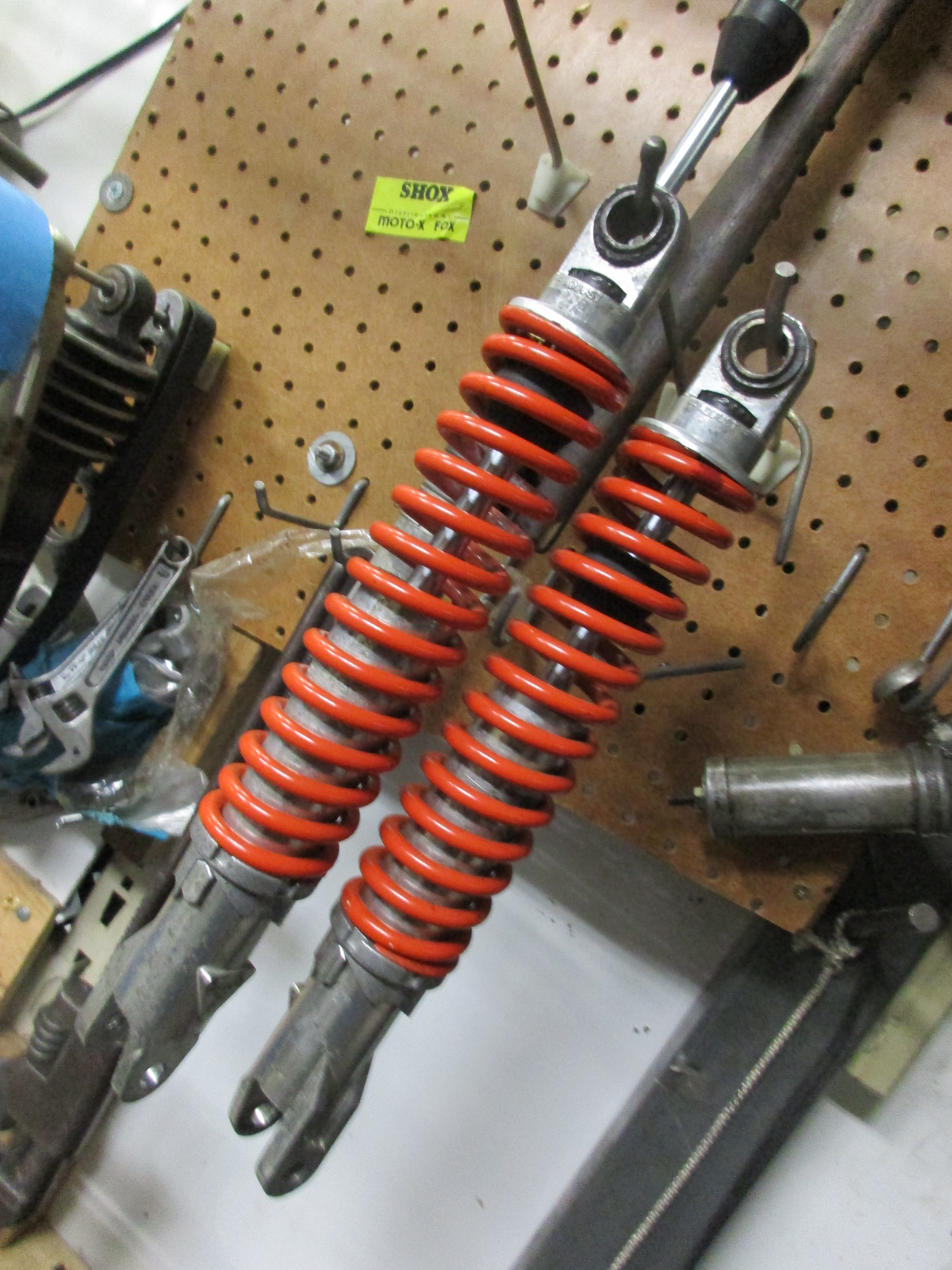

Looking great, Rod! Ive got to get you down this way to go riding some serioys twisties in the Appalachian Hills with us sometime! Or at least to AMA vintage motorcycle days weekend at Mid-Ohio sports car course outside of Lexington Ohio...
These CB350/400/500/550-Four Koni 76F shocks of mine that Kenny modified for Koni 7610 Dial-A-Ride adjustable damping internals (effectively making them the equivalent of Koni 7614 alloy body Dial-A-Ride's) will look really great on that bike!

Re: Project two---a CB400F
hey Chuck---- ya...I'm looking forward to the mailman ringing the doorbell and saying "your Koni's are here"!!!!!! :D
I'll post up some pics with them installed.

Well, the doorbell rang this morning!!
The kind mailman dropped off a nicely packaged set of rebuilt and upgraded Koni Aluminum 76F's, with Ikon "dial a ride" adjustable damping internals installed.
Dealing with Chuck78 here and (sorta indirectly) his suspension guy, Ken was great....answered all my "don't know what I'm talking about" questions, and even generously included an extra set of springs in the deal. Good people, those two.
Popped into my favourite nuts and bolts store to pick up some bottom shoulder bolts, and voila -- rear suspension, done!
