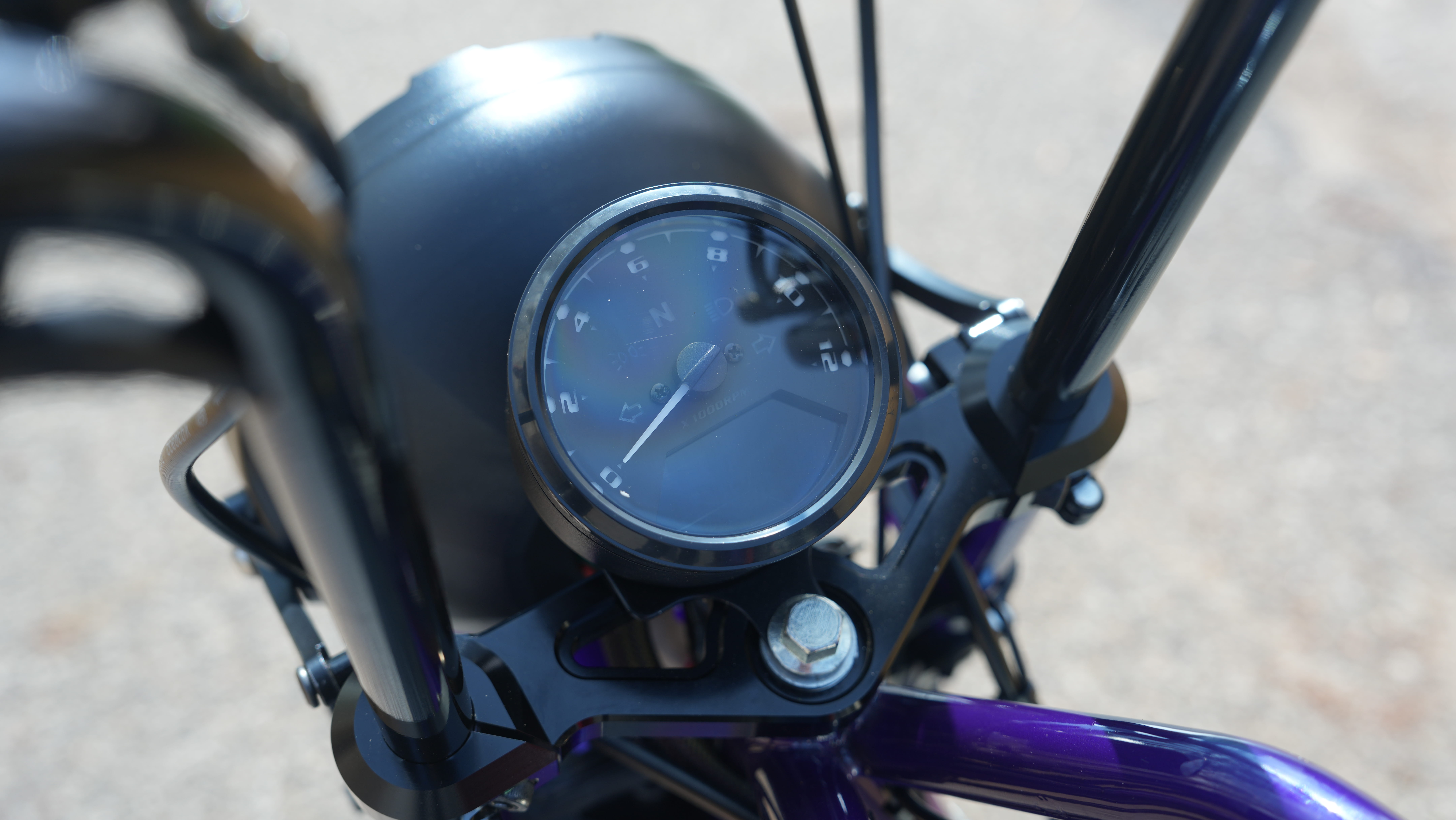

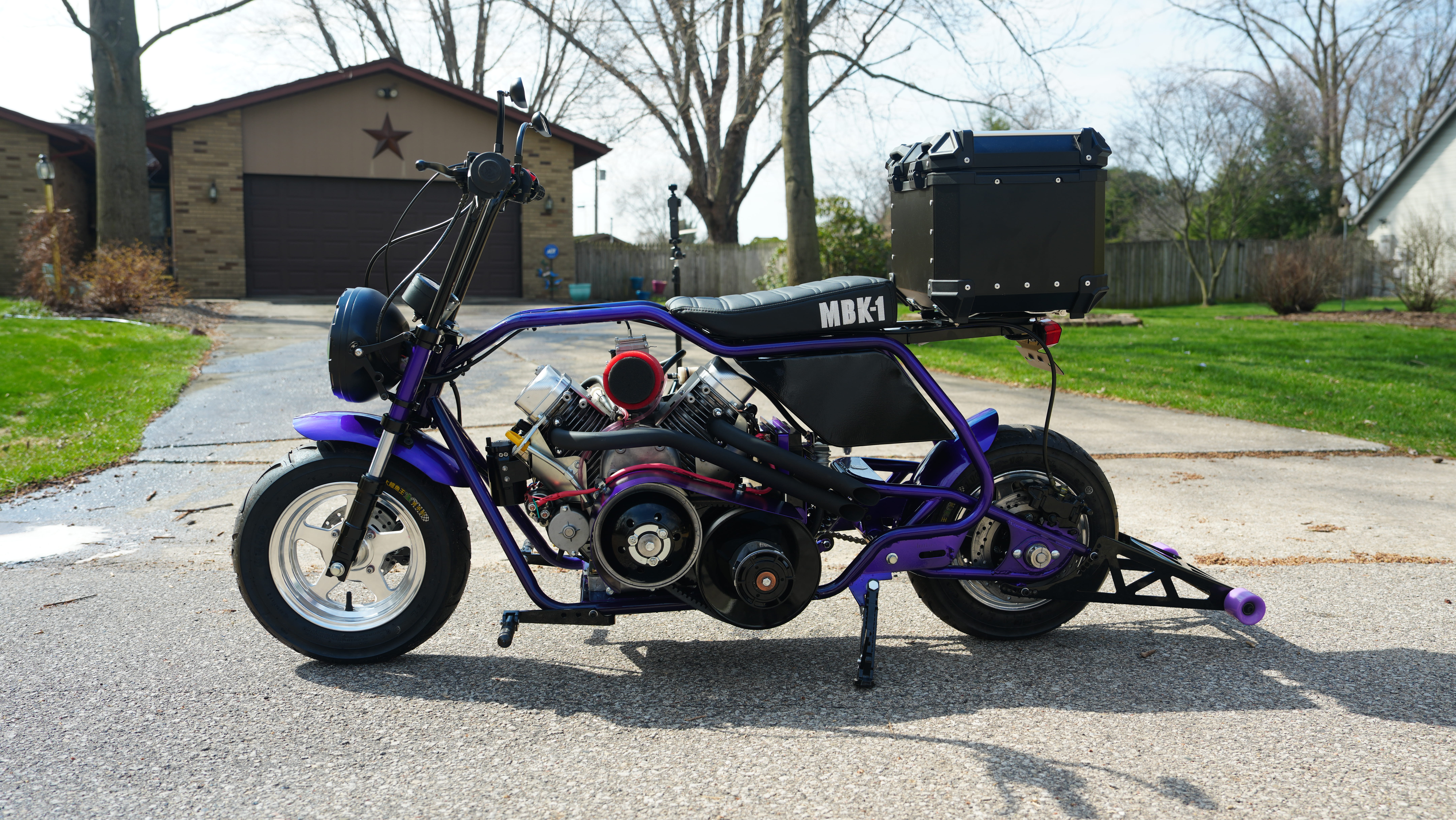

Attached are some photos of a recent bike we built for one of our customers.

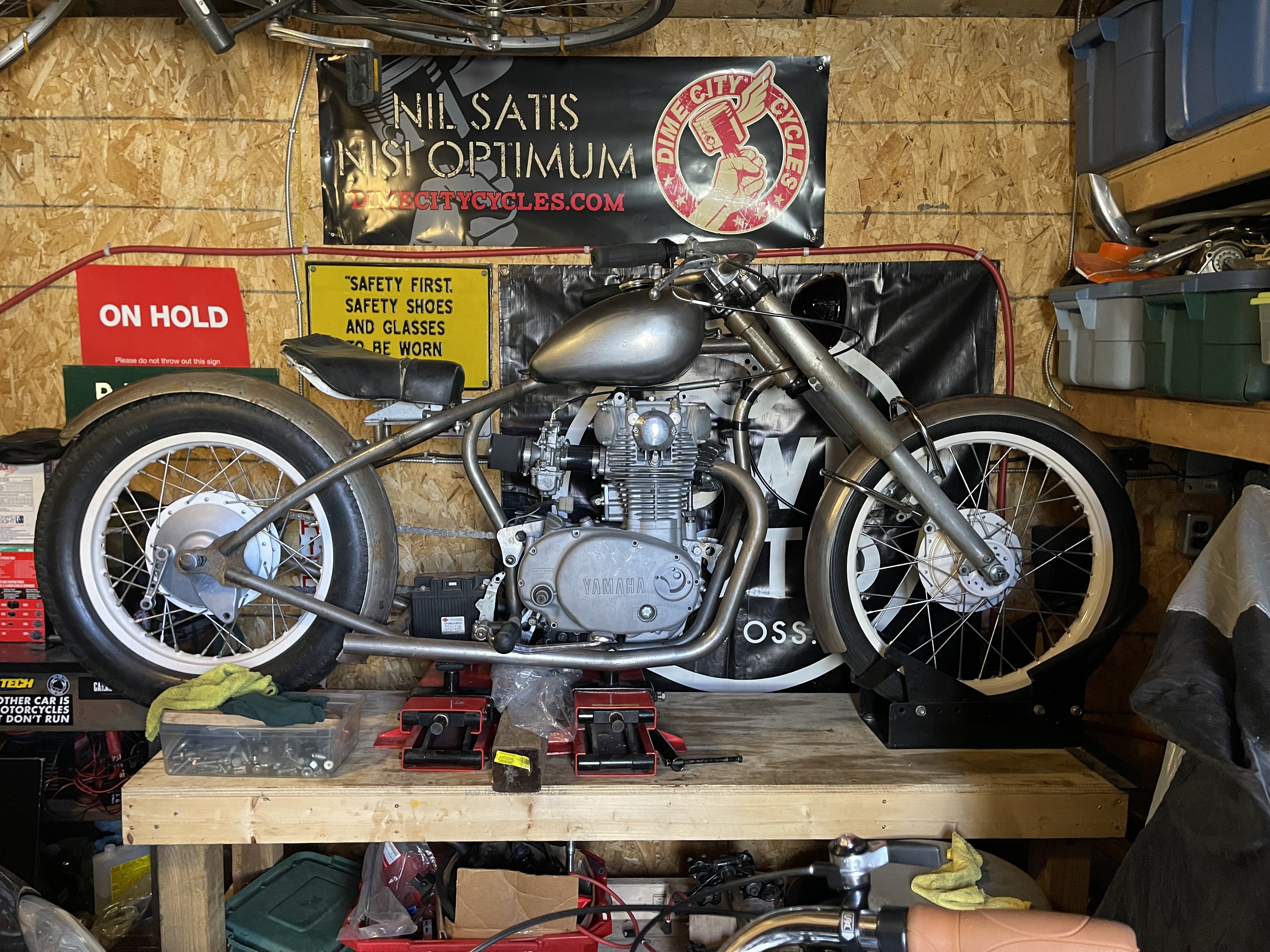

The only feedback I can give is my experience getting a MTO title for a bike I built on a custom frame.
Mine was a Voodoo Vintage custom frame from the US. It came with a Manufacturer's Statement of Origin and had a 'VIN' engraved on the frame.
I went into the MTO with an affadavit saying I had put the motorcycle together with a list of the major components. Engine, suspension etc.
I would think the path of least resistance would be to sort out how to be a legitimate custom frame builder. If you're creating complete motorcycles, there are likely 100x more hoops to jump through and certifications needed. As a frame builder, then you're into 'kit car' territory I think where the final customer does some amount of final assembly and registers like I did with MTO.
If I can get a title in Ontario for a US motorcycle frame that I bolted a 1975 Yamaha engine and suspension onto, I'd imagine anybody in the US would easily be able to register a motorcycle they 'built' based on a legitimate Canadian frame.
Ironically I ended up giving this bike to a friend of mine in Ohio, where I expect he had no trouble getting a title based on the original US based frame maker. So now the bike has dual-citizenship as I still have a legitimate Ontario MTO registration for it.
