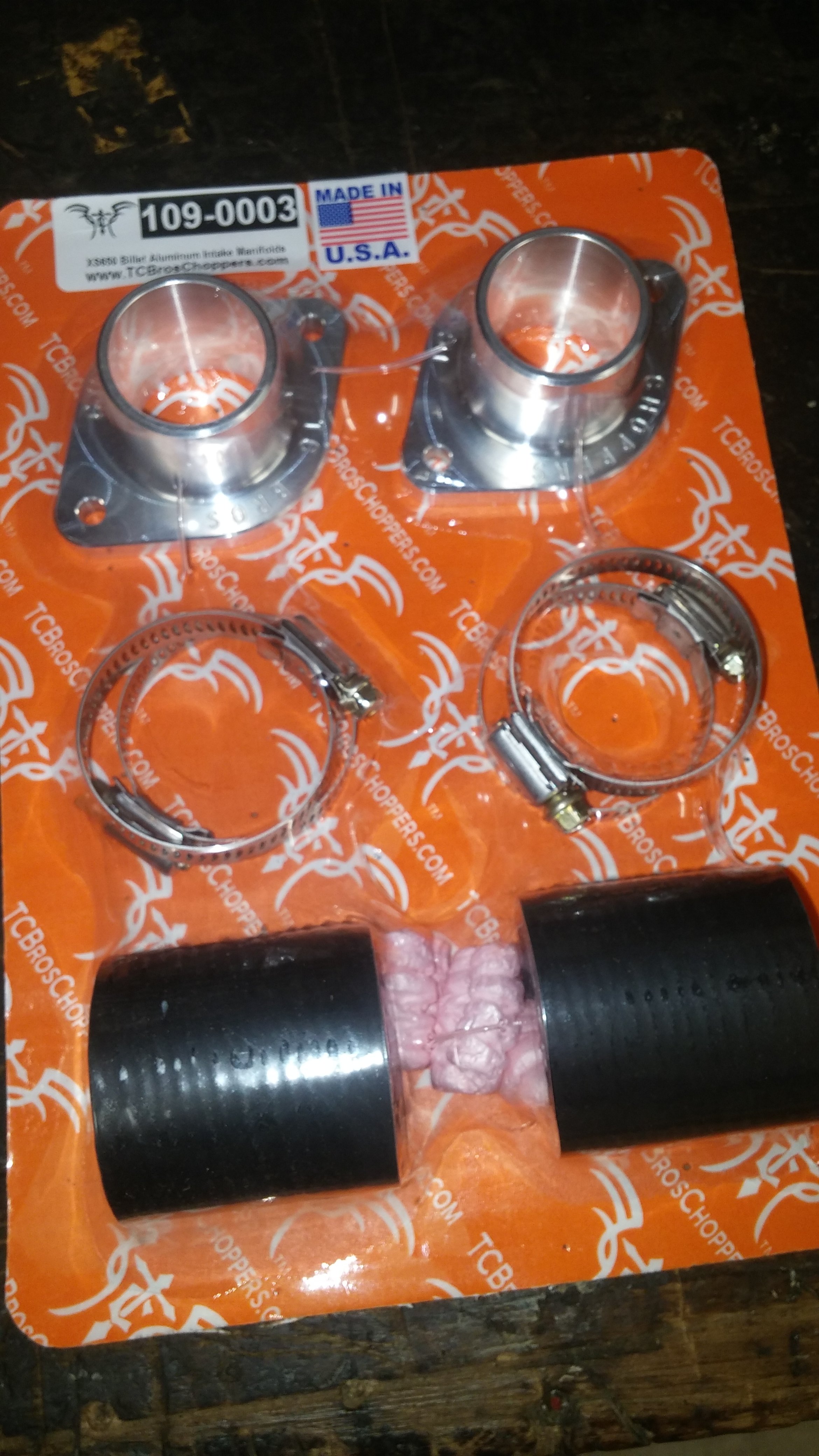

Been some time but back to messing with the monkey ! Was having a lot of leaks from the carb boots so went with these !

Nice! I've read those work great with Mikuni VM32s. Take pics and let me know how they fit. I'm thinking of doing the same thing.

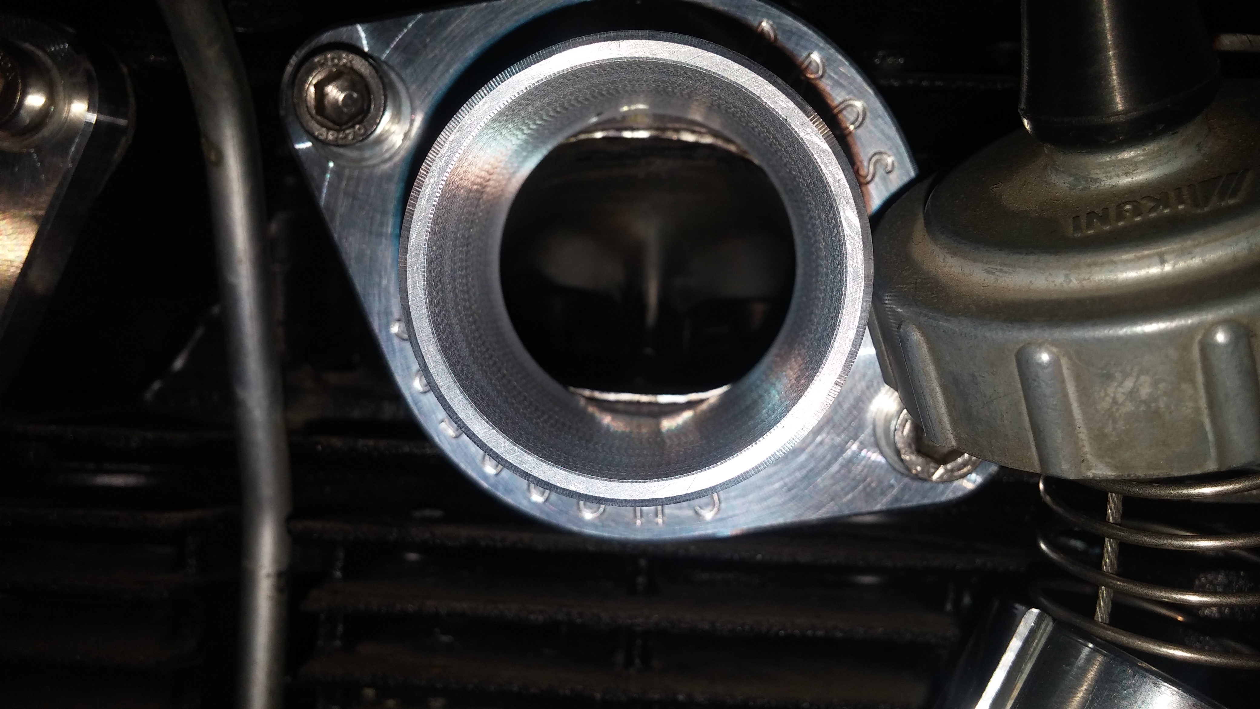

I did a test fit with ever thing from mounts to filters. So far I'm really happy with the fit and finish,much better then stock stuff. As in the post on xs500 forum my ports a novel and new boots are round . when mounted there is (maybe) 1/8 inch of lip on top and bottom. Its not a race bike so I think I'm going to leave them alone for now and once I get messing with tuning again see if it make a diff. I can see it could cause air flow to not be perfect so if that seems to be the case I'll pull them off and take off the edges ! Will see I guess and ill get some pics up . If anyone sees a problem with not smoothing out the ports and why please let me know !

I don't see why it would be a problem. Like you said it's not a race bike. Interested to hear about the results.

The surface finish isn't critical on the intake side. The rough surface will actually help creating turbulence and a properly mixed charge. You want it nice and smooth on the way out though.
The reason that polished ports are not advantageous from a flow standpoint is that at the interface between the metal wall and the air, the air speed is zero. This is due to the wetting action of the air and indeed all fluids. The first layer of molecules adheres to the wall and does not move significantly. The rest of the flow field must shear past, which develops a velocity profile (or gradient) across the duct. For surface roughness to impact flow appreciably, the high spots must be high enough to protrude into the faster moving air toward the centre. Only a very rough surface does this.
The finish on our heroes intake wouldn't worry me in the slightest.
I believe he's more worried about the difference in port shape between the head and the manifolds than the "finish" of the ports. If it was me, I'd bust out the dremel and match those ports. That sharp transition can't be good.

yep that's what I was thinking . will be doing this when I order thenew jets . thanks for all the info
