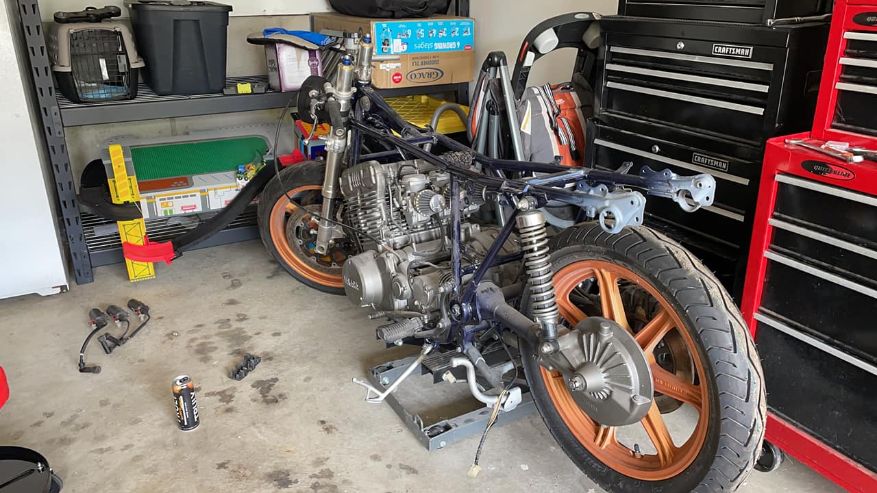

Currently rewiring a 79 XS 750, I've purchased a motogadget munit to simplify. Has anyone done this and happen to have a wiring diagram? This is my first time doing anything along the line and its been a lot of trial by fire. The main issue I'm having is wire tracing, and have no clue about the set coming from the underside of the motor
Any positive help is good help
